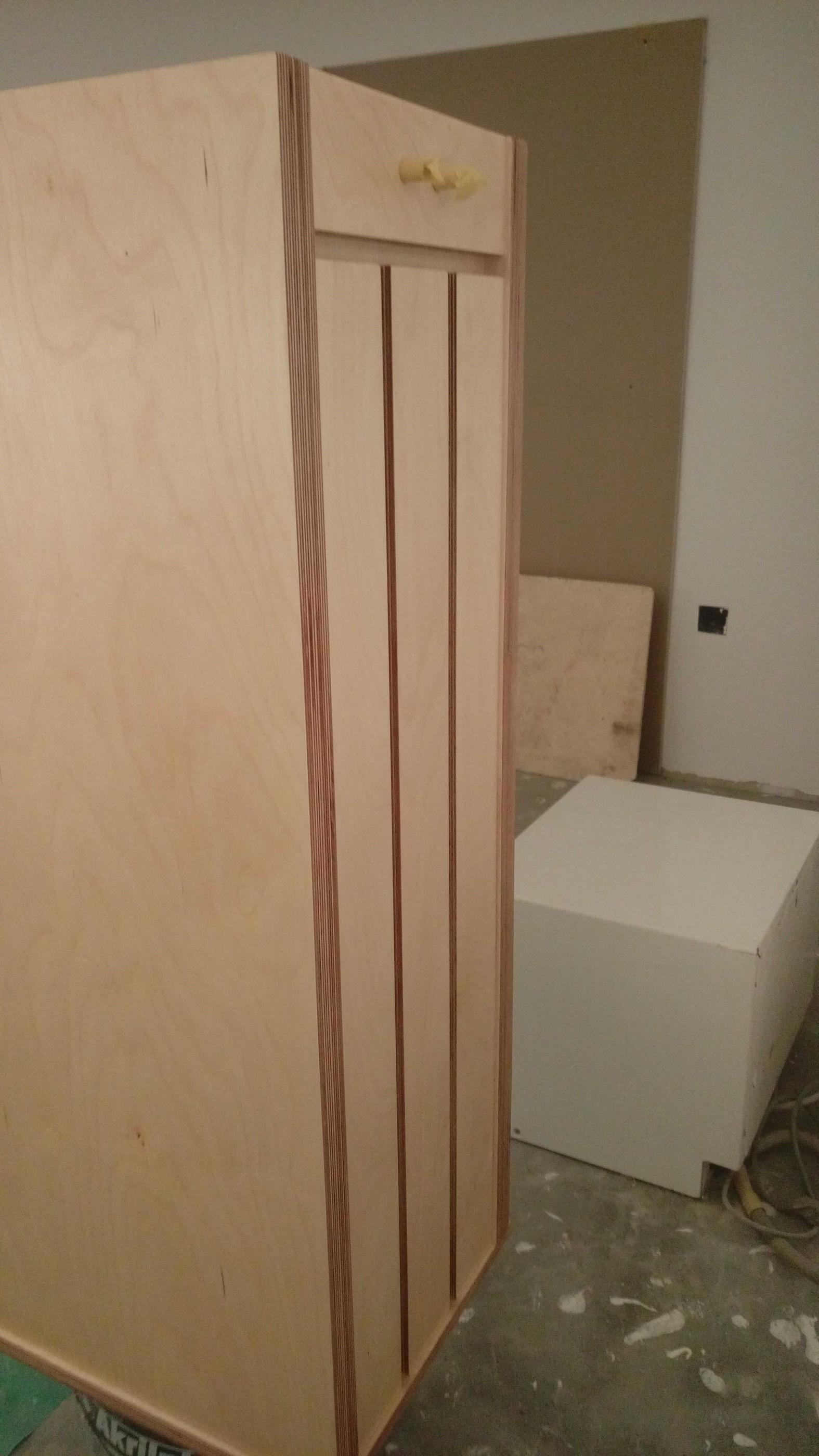

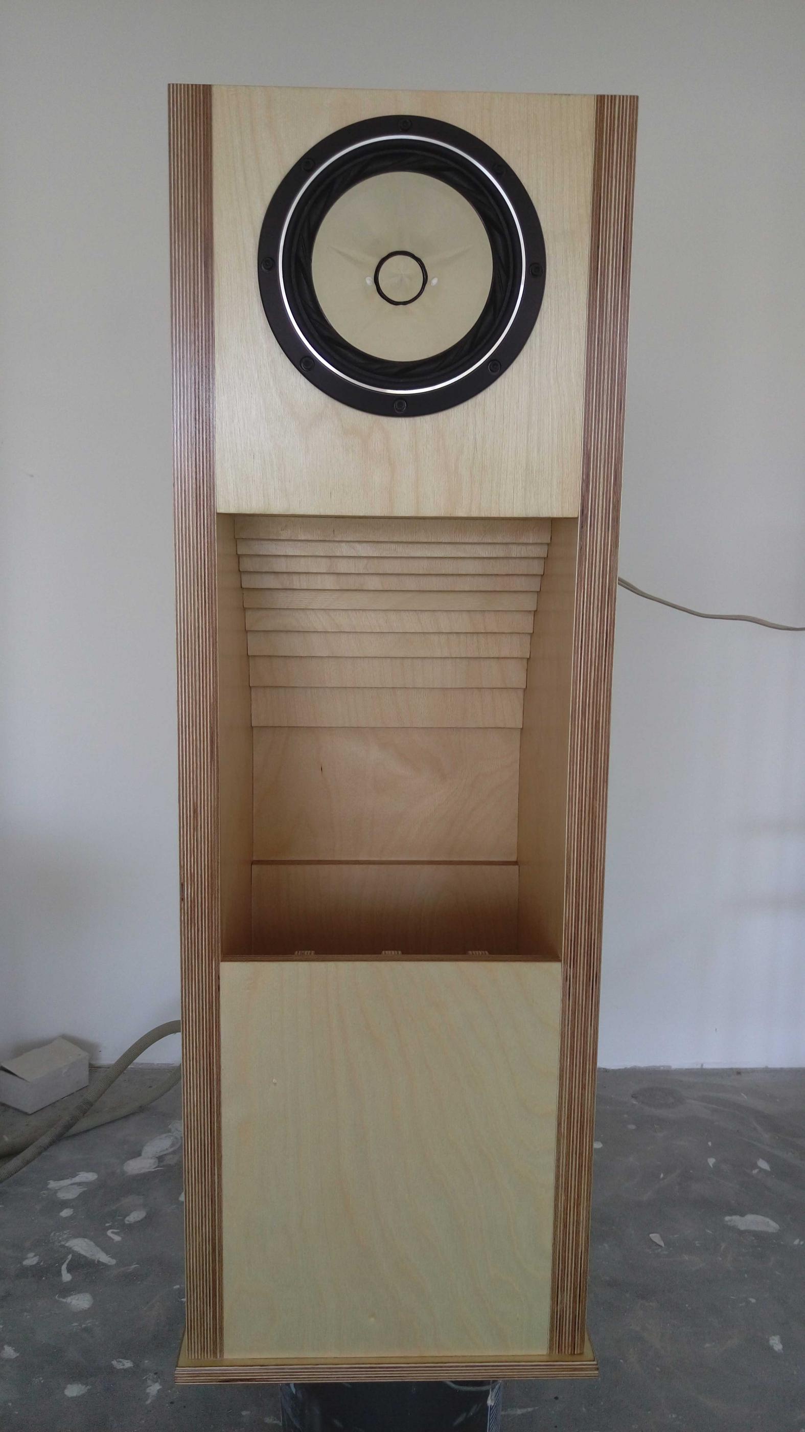

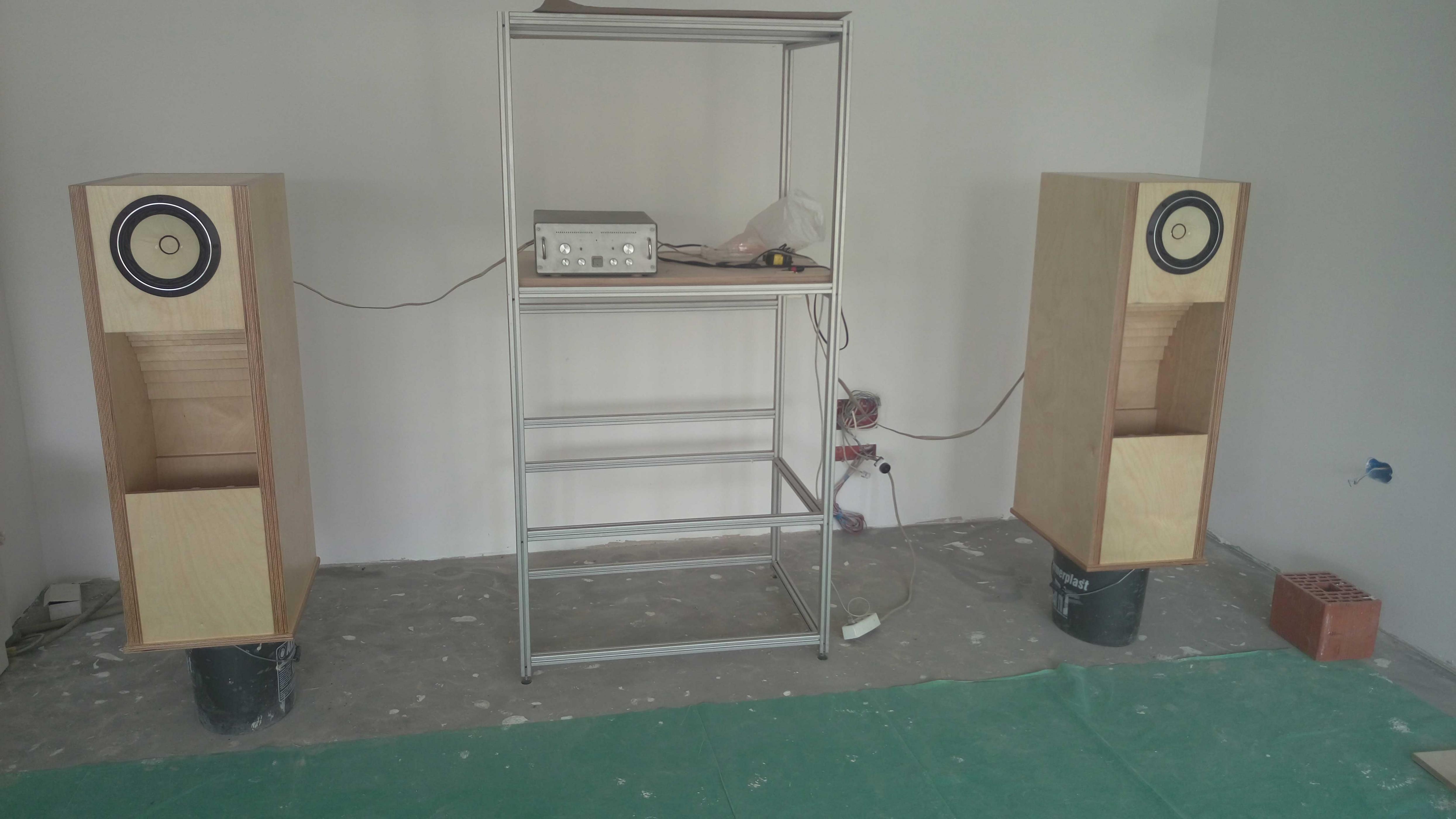

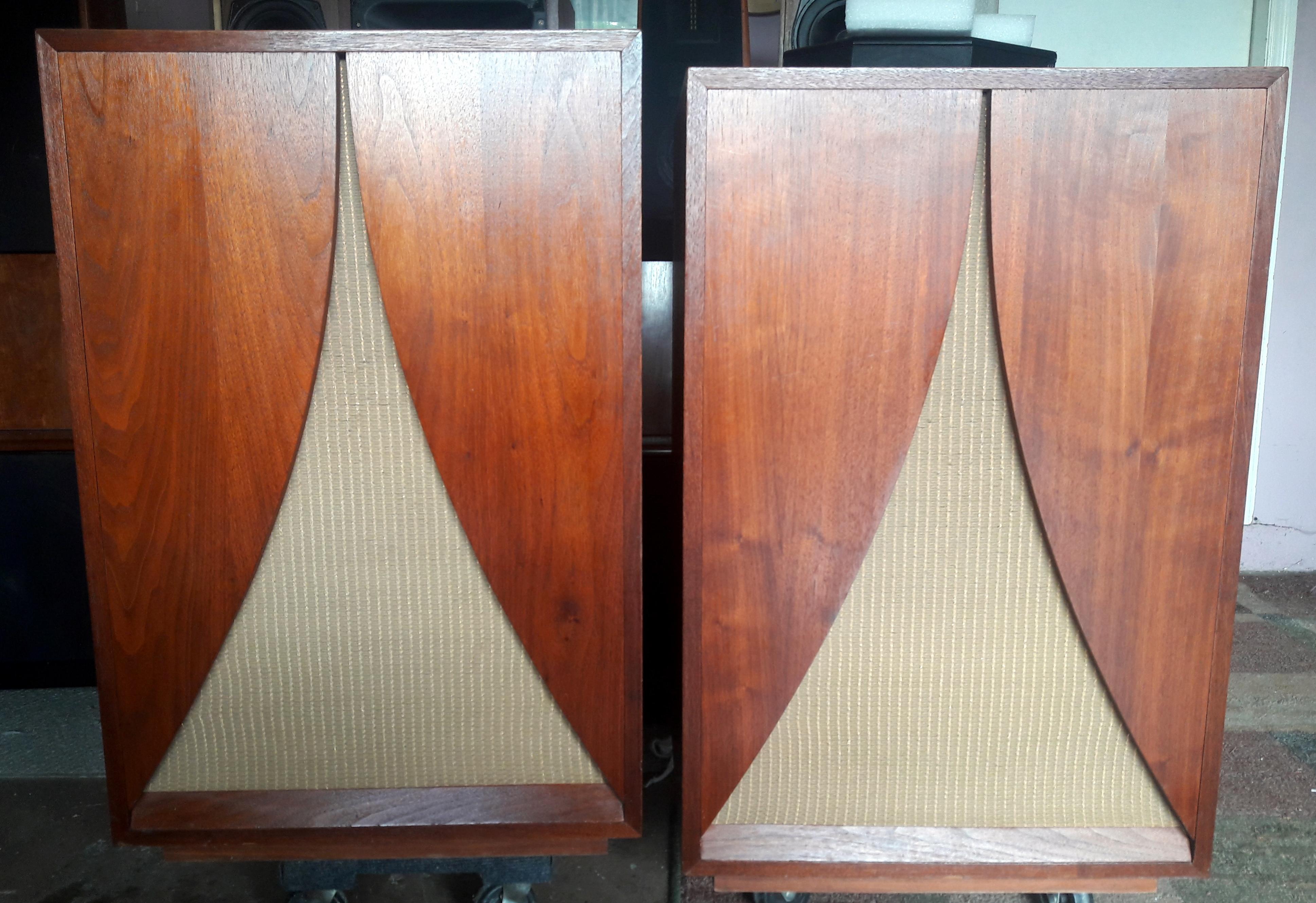

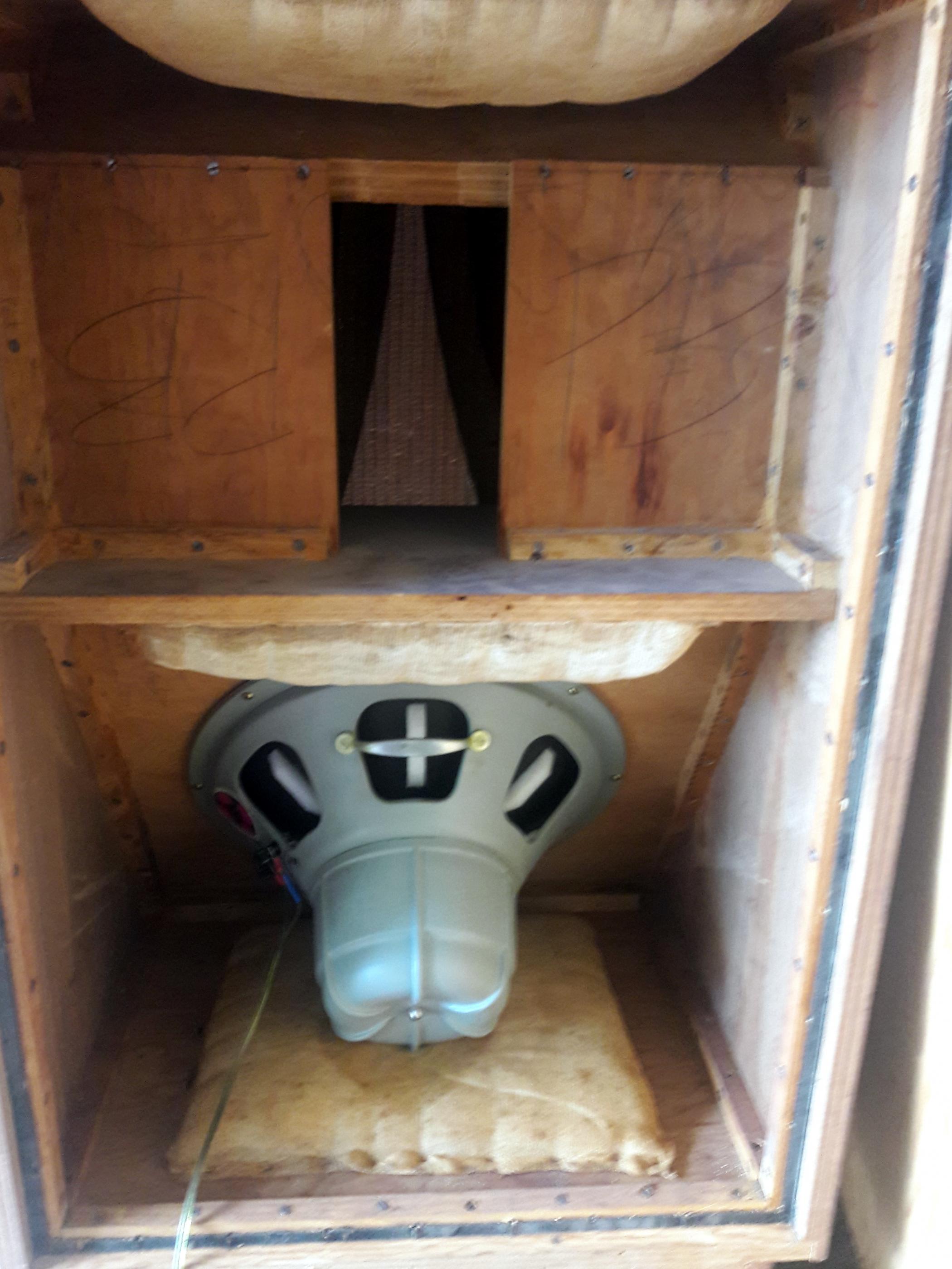

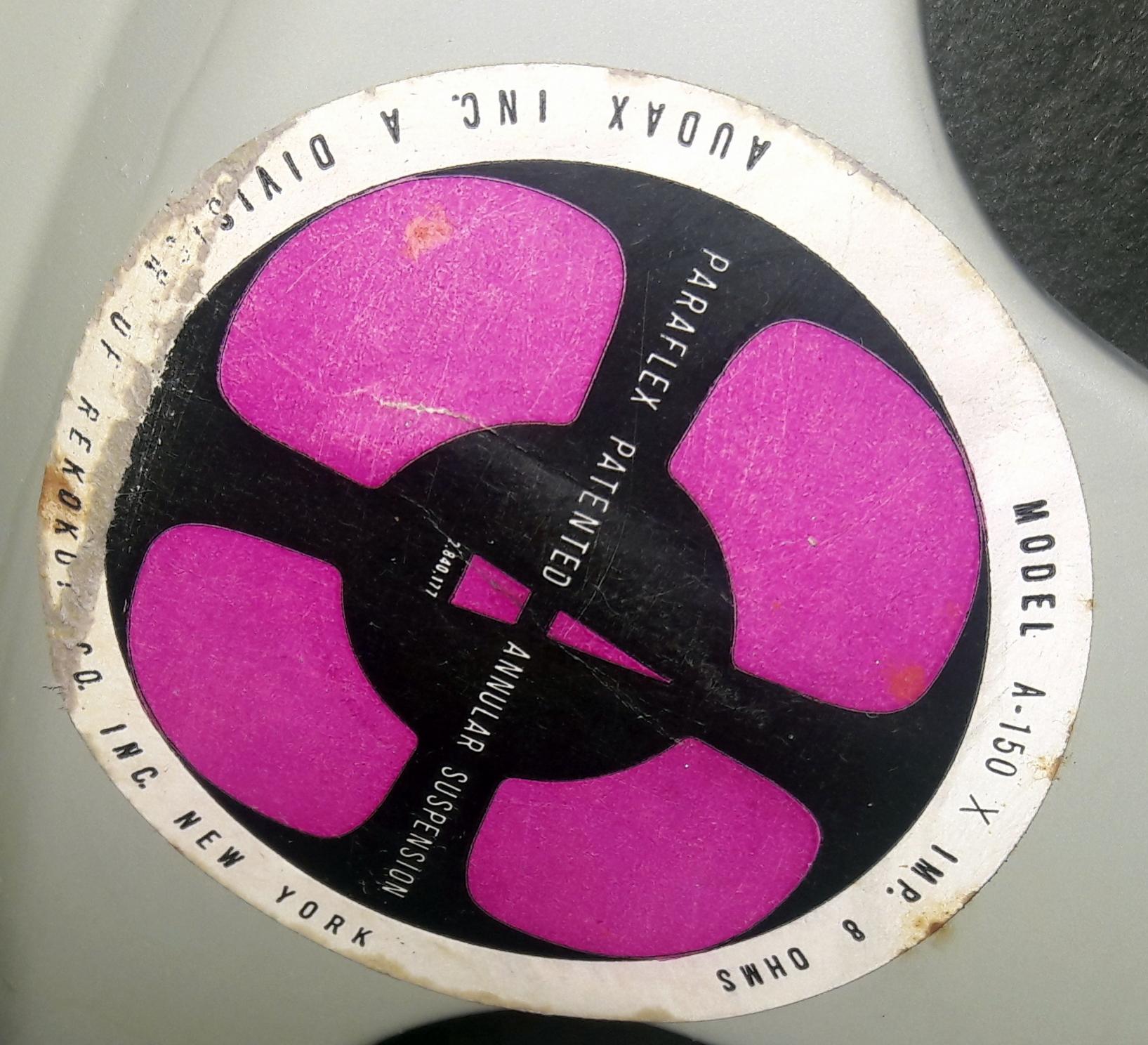

Karlson K15
Installed are Audax 15" full range drivers, mahogany cabinets.

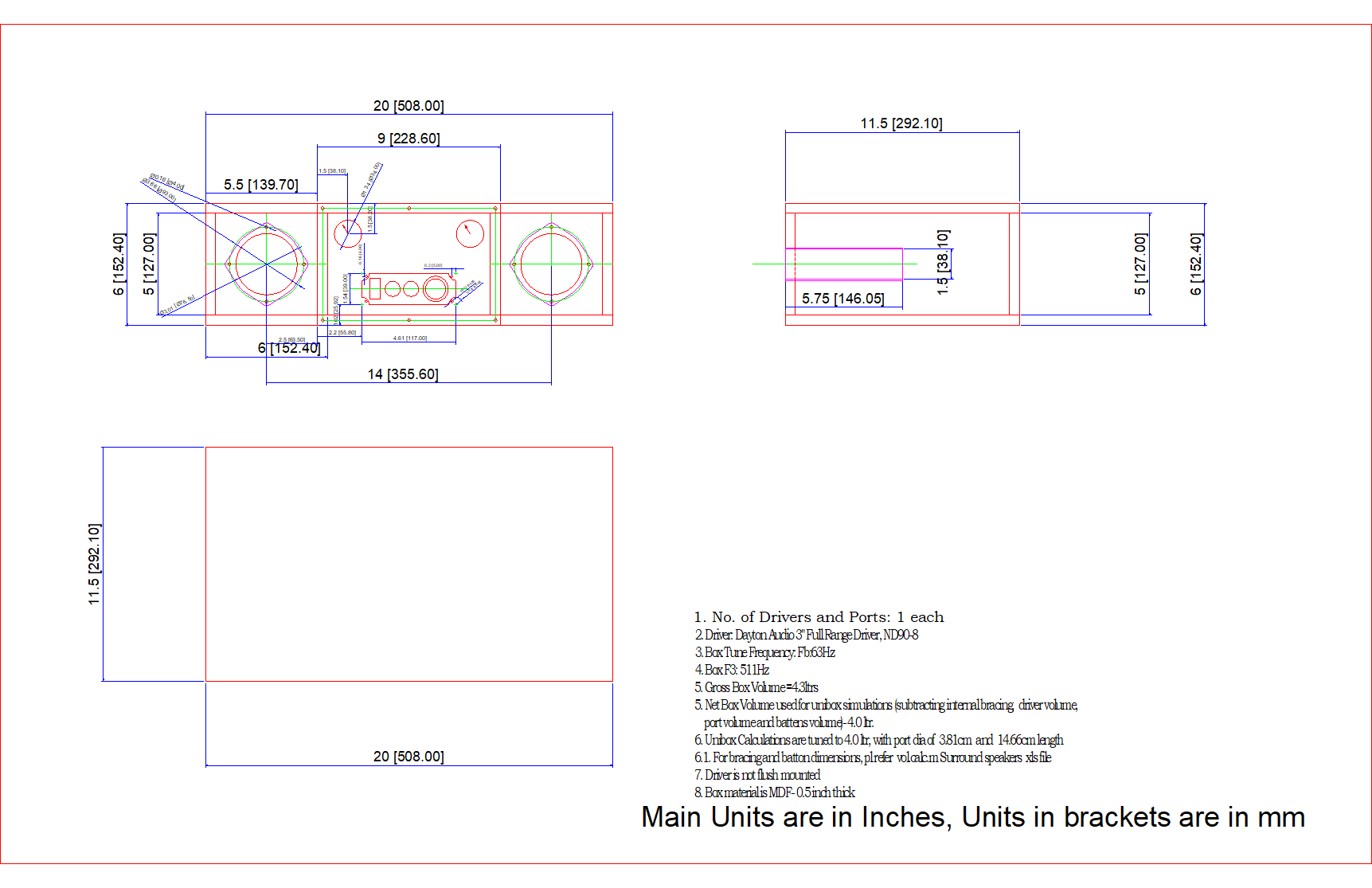

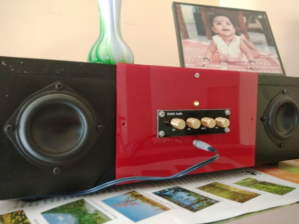

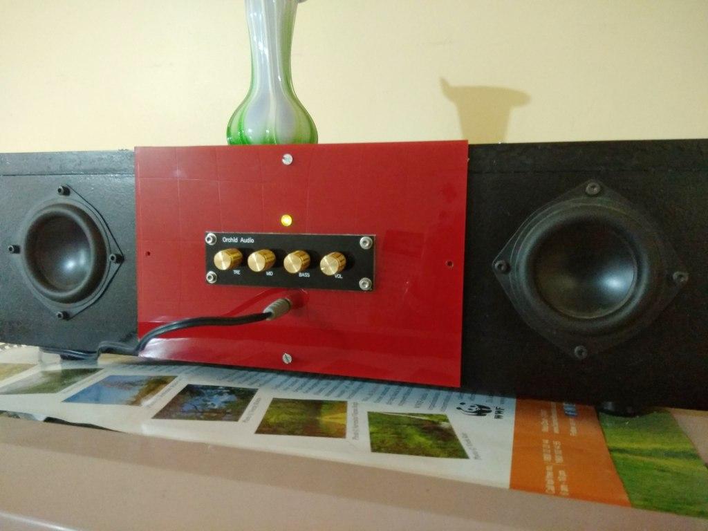

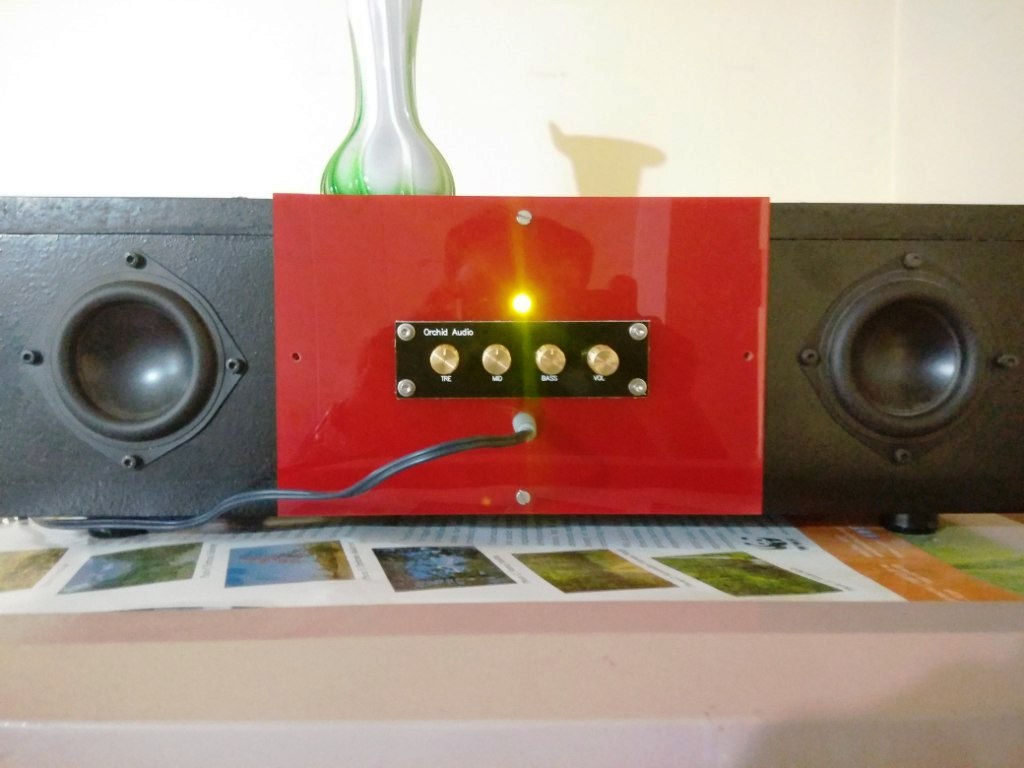

Havent been in this part of the DIYA for a long time, but here is my boombox based on Paul Carmody' Sprite.
Drivers are Dayton ND90-8 and filter is same as Paul Carmody's.
Amp is my own designed stereo LM1875 and pre-amp/tone control is a Alexpress kit that seems to work well.
earlier it housed a Dayton DTA-2 Class T amp , but I didnt like it.
regards
Prasi
PS. this Sits on the refrigerator in kitchen for the wife.
