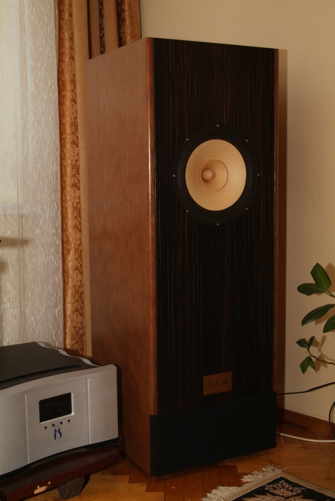

OK. Get out of my kennel. So now I'm looking forward to some real creative speaker designs and builds? So who want's to have all the fun first?
Currently I'm having some boxes built for a very straight 2 way. Fun to build and even more fun to listen to. I'll post it.
Any plans available for those cabs? Would like to see a drawing.Work In Progress. New cabinets for my Alpair 10's.
Don
Hi Don!
Not yet. Will probably make specified plans later when I get the time.
Basically they're about 29 liters each, measuring about 900mm high (+ outriggers and spikes) about 200/140mm wide and 320/290mm deep. Vented either from the bottom or back, haven't decided yet.
Baffle 30mm MDF (CNC'd) and sides and bottom 22-25mm, maybe a couple braces to further stiffen the construction. Also surfaces covered in one layer of woven fibreglass mainly for finishing purposes.
Suggestions welcome about vent placing btw. Thank you in advance.

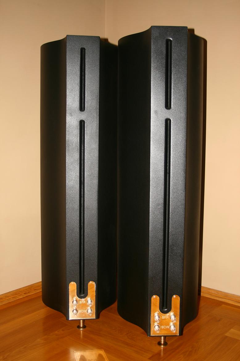

Sonido SFR175 in compact triangular cross section labyrinth enclosure. Compact - if to compare with BLHs.

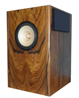

I haven't heard of them before. Looks very good. I mainly use the Fostex FE206En (8").For me its best value/money I`v tried in fullrange category. Its hard to describe sound by words. If to be short - I am satisfied). Built a lot of speakers with them.

I compared with FE series, sonido is winner for me. More smooth sound and better integration of small and big cones.

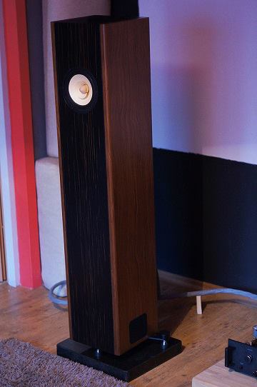

Great work Charcoal, I enjoy the attention to detail!
In our local (Central European) Audio Community we’re ‘hearing’ more and more good things about the Sonido drivers lately. The 300SWR is an interesting driver, there are not that many full-range drivers of this size around, and it actually models very well in an Onken Enclosure, with Onken alignment (if you can handle 200 or so liters). Better than any modern driver of its kind that I’ve seen these past few years. If only time wouldn’t be the limiting factor here, I’d be arranging a date with some 25mm Baltic Birch right now…
