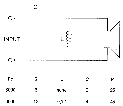

Full range plus supertweeter in the nearfield: cap or real crossover?
frugal-phile™
Joined 2001

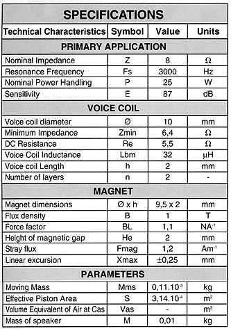

The entire specs aren't uploadable at a rez that would make them readable so i'll do it in bits.
Tweeter TM010A7 -- Micro 10mm Neodymium Gold Dome
Ion deposited pure gold
Ultra compact (29.5mm diameter)
Ultra-light weight (10g)
Balanced drive concept design*
Extended frequency response
Ultra-light moving parts
Encapsulated neo magnet

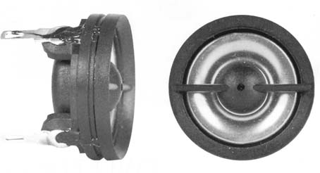

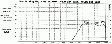

morbo said:
1. TM010A7 30mm gold cone (from Solen)
2. TM010A39 Micro Series 10mm ion deposited gold dome ,very small (from Madisound)
actually, my Solen Catalog shows the TM010A39 (which i've not seen a reference too before)...
Except fo rthe grill -- which i'd turf, it looks pretty much the same... for super-tweeter use these little tweeters should have it all over the big ones.
The pic in the catalog for the TM010A1 (except for the black color) is a better idea of what it looks like... i'll try to get a color pic later.
And -- maybe not with the CSS -- some creativity is small enuff to mount co-axially.
dave
Weird, the solen website lists the 10a7, with this pic:
had them for a design, but will probably sub in the budget ApexJr tweeter & save these for something better.... I haven't tried them yet, but i think i'll dig them out and pop them on top of my Coraled BD-Pipes to try out.
Definately let me know what you thought if you do.. I also think something tiny like this with the low mms and relatively high xmax should be better for supertweeter duty.
