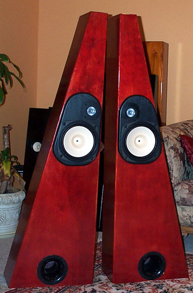

had them for a design, but will probably sub in the budget ApexJr tweeter & save these for something better.... I haven't tried them yet, but i think i'll dig them out and pop them on top of my Coraled BD-Pipes to try out.
Definately let me know what you thought if you do.. I also think something tiny like this with the low mms and relatively high xmax should be better for supertweeter duty.
