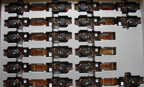

Full Range of Sony CD Laser Pick Ups (with photos)
The KSS-272A is not available recently since the SONY company stop supplying this
however, we try all the time.
I will let you know once there is any news about it

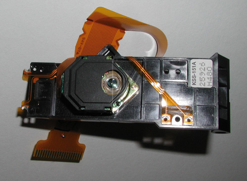

Does any one want the KSS-151A? it is also hot sale

Cheaplow I know ur post was long ago but just for reference concerning KSS 151A - i found it while googling the KSS lenses here:
http://www.edxelectronics.com/PartsIndex/PartsIndexPage73-37.aspx
