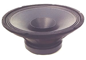

Just seen this pretty 12" widerange driver
Senon YD 1256 U, have no clew what the heck it is
Fs 46hz, Qts 1.33, 90db
The most funny part is the price...27 EUR
One should be able to afford 4 drivers
