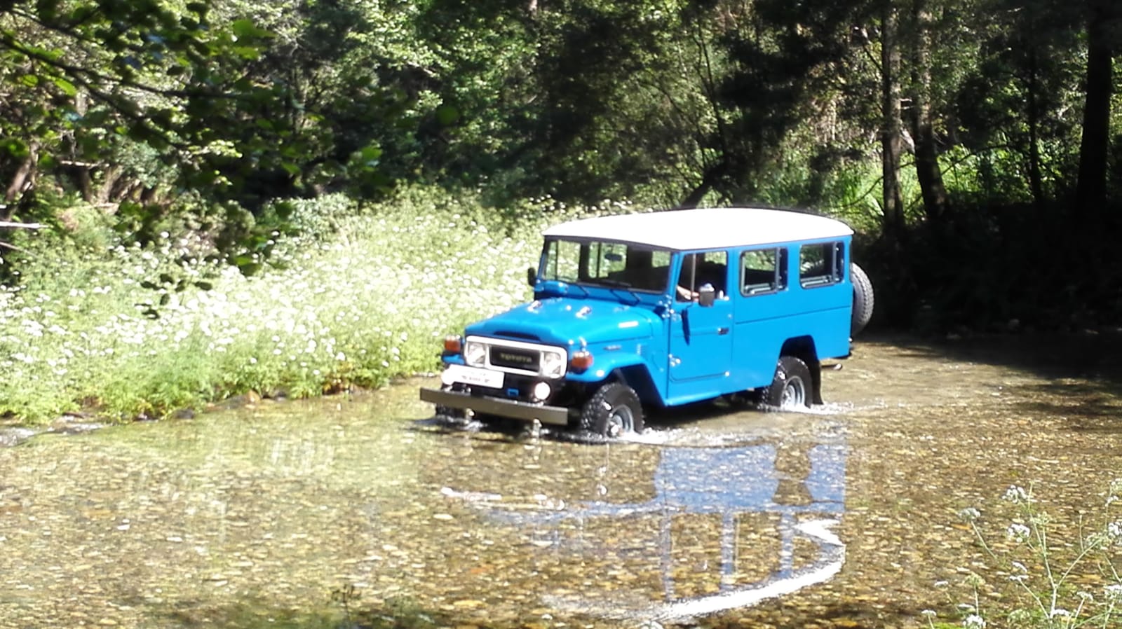

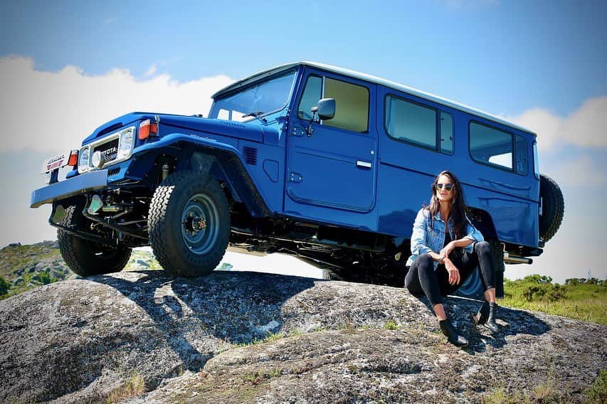

I have been reading this thread as I want to create a decent sound system to a 1970 4WD Toyota Land Cruiser which has been restored in its stock configuration.
These models had only a dash radio and two speakers sitting below the dashboard, at the passenger’s footwell. For obvious aesthetic reasons, there isn’t the possibility to add speakers to the vehicle front doors or dashboard or footwell.
I have the idea to build a “removable sound bar” which could also be taken out of the vehicle when camping and partying. This soundbar would be placed inside the cabin at roofline level, behind the front passenger seats and in front of the cargo / passengers area.
For those not too familiar with what I want to do, let’s say this soundbar design would look very much like a “jeep soundbar” (thanks google) except that it would be not be fixed on a roll cage with Velcros but clamped inside the cabin, on the L+R side of the roof.
In terms of materials, I would rather stick to marine plywood (8-10-12mm) for durability. It could always be strengthened internally with bracing, fiberglass mat, add some dampening material…
For the front panel, preferably plywood but may be some MDF and the help of a CNC machine if we need to create complex shapes (like angling the loudspeakers). Finished with paint used for flighcase.
Internal available volume for the sound bar would range between 25 and 35 liters. Maximum 40 liters
If need be, I could also add a separate “portable bass box” in the cargo compartment (60cm x 30cm x 30cm so +/-50 liters ), although I am not looking for a bass shattering system.
- System must have good off-axis response and/or a design with angled loudspeakers
- Bar is located behind the front passengers, roughly at less than 1m from front passengers ears and from 1 to 3m for passenger sitting in the cargo area
- The cabin inside is like a big “metal box” with 90% reflective surface (metal, glass). No sound dampening whatsoever, no carpets
- This is a rustic 4x4 so we do ear the engine and the gear train
- Source would be a modern car radio/CD Player and audio files (via Bluetooth or hard wired)
- System and loudspeakers must be able to cope with winter cold and dampness (night) as well as heat (sometimes 55c inside the cabin when truck left in the sun) and wide temperature variations
- Budget for speakers and filters (including separate bass box if need be) around 400 US$
If anyone could share some design ideas and speaker recommendations, this would be much appreciated.
Thanks to all.
