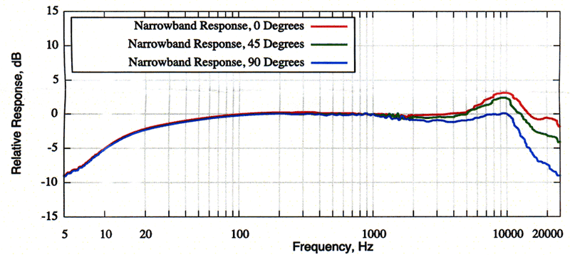

You need a measurement microphone with fairly flat frequency response.
Parts Express sell Dayton and Behringer ECM8000. Both under $50.
Correct, without calibration neither microphone is perfect, nor my $200 or $600 microphones. ECM can get him started for cheap and if he gets involved more seriously, he can have either one calibrated.
Unfortunately most uncalibrated mic's tend to provide a misrepresentation right in the area that most full range drivers let go of minimum phase behavior.

My ecm8000 needs calibration? Bummer. I was assuming it would be accurate right out of the box. How should I proceed?
