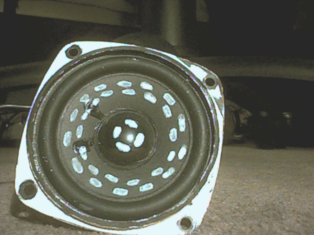

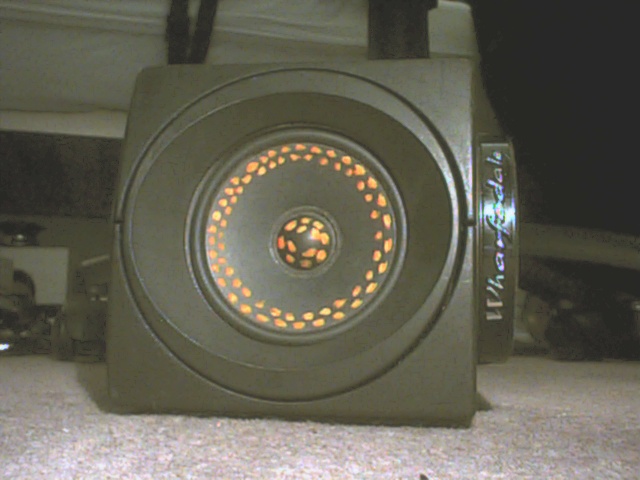

I have tried a very crude method of enabl treatment, prior to my research into it. I used acrylic paints (orange, of course), and went around a wharfedale 4" full range speaker, and used white on a pair of FRS8 drivers. I used the thinnest paintbrush I could find, but still made a far mess of it all.
Pics of that attached.

Got that right!. EnaBL just allows you to cease to worry about the out of band breakup problems, that even sharply rolled off multiway systems suffer from. And then there is that beguiling extra 60 db or so of coherent information that shows up, underneath the typical 40 db down cut off of coherent information, that typical drivers labor under.
chriss, you REALLY want to order Ed Lafontaines EnABL kit. see the txt attached above for the thread here on diy. Learning this simple system of application, though tedious, will take you right to the level of competence you need to get to, before you work on something near and dear to your heart. I teated inclinedplanes drivers for him, and he is being very straight about how well they work, and they didn't have a lot to apologize for, before treatment, just three shriek zones.
