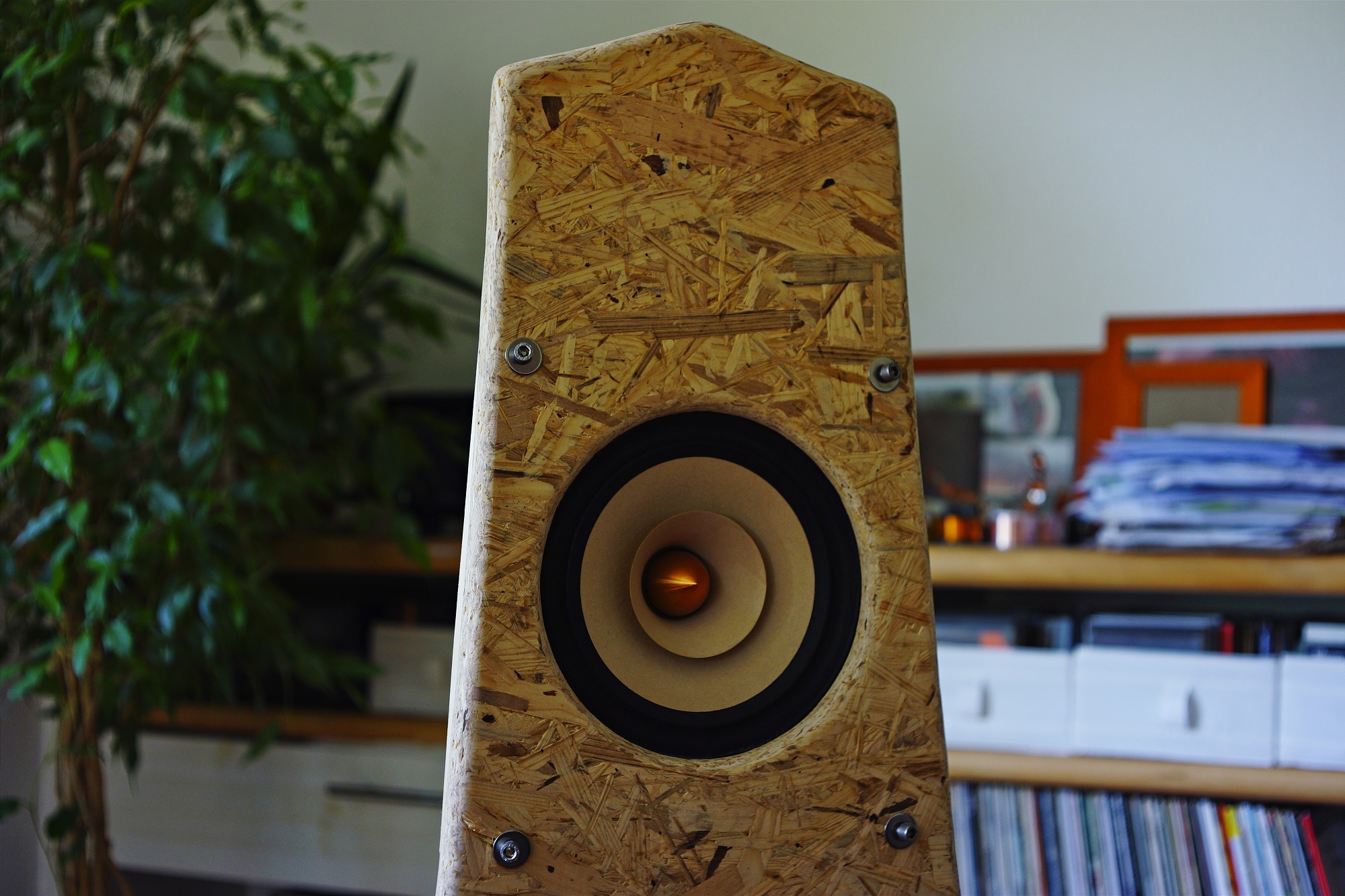

I still have the TB 1808 from my evaluations. It´s a pretty good driver, easy to work with and with a good quality/price ratio.
It will do the 3-dimensional thing, but it will not do easily 30-20000 Hz... don´t believe manufacturers fantasy numbers. Voxativ is a very bad example... and the response "curves" given by Cube are not much better.
TB 1808 was very good in a decent sized OB prototype with a nice 18-inch bass driver (here AD 1830, cheap and good) with moderate correction. It will work also in a closed box, but of course not nearly with levels of quality and impact a good 18-inch driver in OB will do...
I still have my 1808, but moved on to EMS and Fertin drivers. Should you be interested in a used pair, drop me a PM.

I need to correct my post: of course, in the photos it´s the AE Dipole 18 visible, not the AD, sorry.

For me, subjectively the TB 1808 was pretty good in OB - open, dynamic, 3-dimensional and pretty natural, once corrected. It was easy to correct and responded well to upstream changes. I think it´s pretty good for the money and liked it better than the Fostexes I know (F 200 A is possibly the exception, but I don´t know this driver) or Visaton B 200, just to give few names...
I think it´s on the edge of diminishing returns - if you want something "better" (whatever that is), you´d have to pay a lot more money - I did it and went first with EMS LB8 MkII, then finally with the FERTIN 21M8EX with fieldcoil motor. I subjectively liked both drivers better, but paid a lot more for them. Never regretted it though...
Anyway, as above, you´ll find a lot of info about the TB 1808, many people like it. Several sets of measurements are also to be found, mine sadly were lost in a harddrive crash, so no TB 1808 measurements or correction filter values from my side, sorry...
