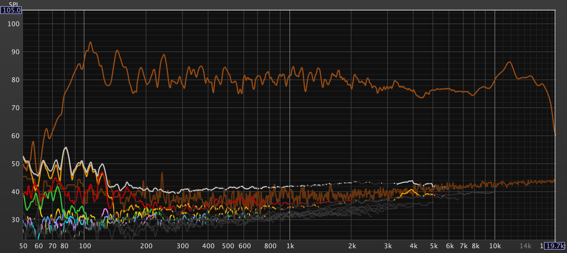

I had a 3" driver in a small MLTL, and tried to put the same driver in a small sealed box on top, firing up.
It's not like OB, but it does give a more spacious sound, which I like better than drivers shouting directly at me only.
It also cleaned up the FR, this is with no EQ, no BSC.
