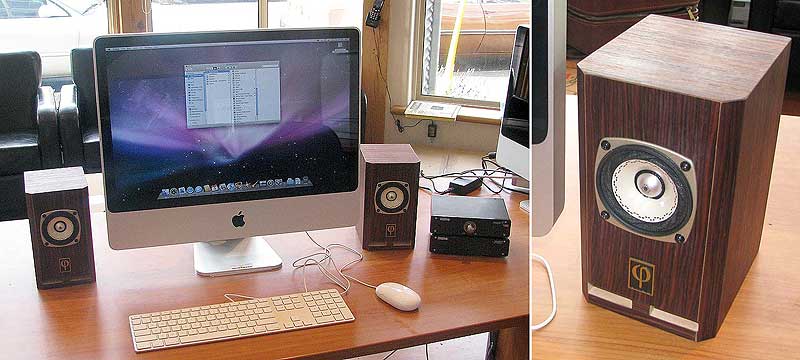

Of course, I will also comment that the Fostex FF85wk in Micro-Fonken enclosures would be at the top of my list for desk top speakers.

Well, they’re not gonna rattle the windows with sub 60Hz, but for the particular application described, I find them quite sufficient. And while I never bothered, I guess that in the very near field - and at SPLs they’re likely to be operating at - judicious EQ from the sound player software could add weight to the balance without exceeding excursion limits.

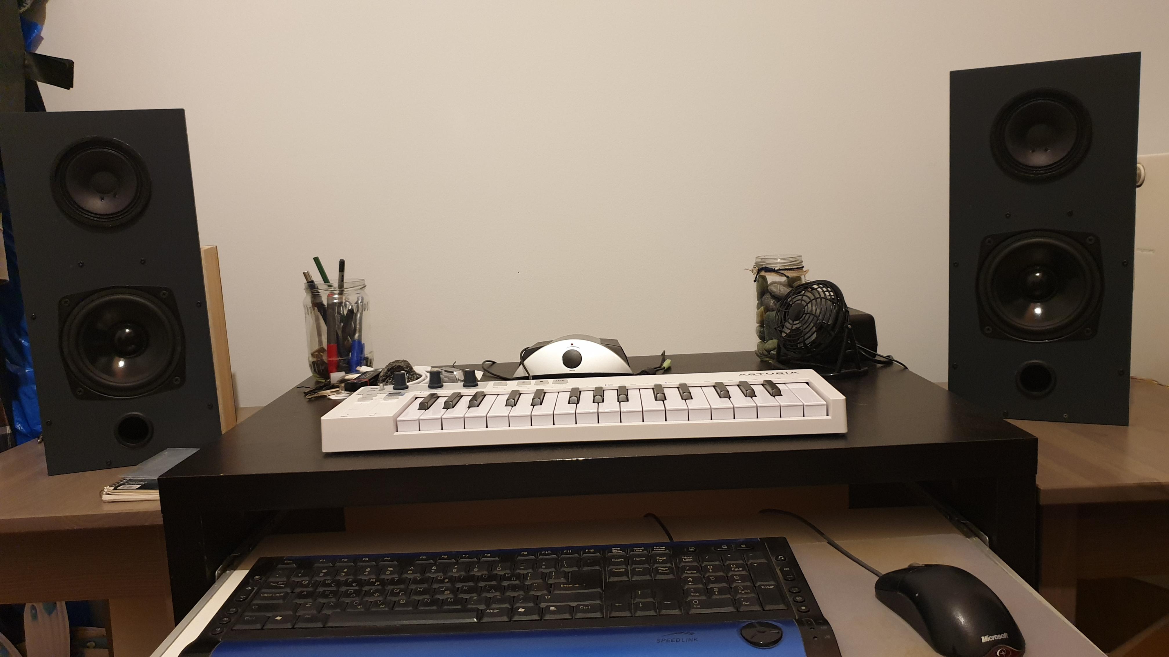

1st. The baffle can be max 25cm x 40cm or 25cm x 1.10m
and 25cm depth. (15cm from the back wall) This is the maximum
enclosure,I think match smaller it can do the job. The room is almost 9 cubic meters small.
No subwoofer for me please.

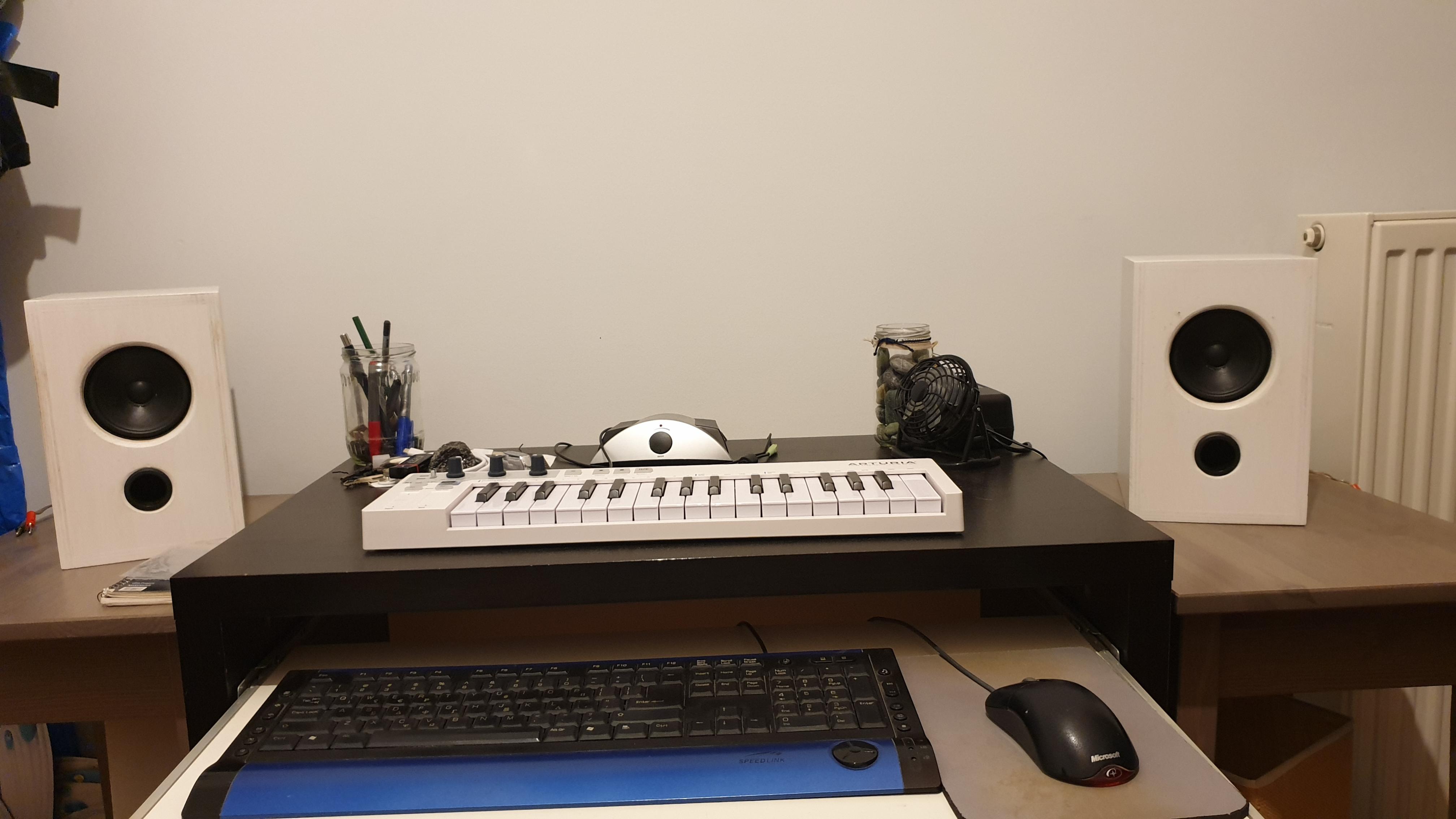

2nd. What required the near field listening? I suppose the 6.5 or 8" can play some smooth bass without turn up the volume. I realize that from my last diy speakers with 4" fullrange ( wharfedale, in 16x26x11 box) Can I go for floorstand speakers in the near field or I will be out of the sweet spot. My listening position is one meter.
3red. The budget must stay as it can be low and shopping from Europe only because of high overseas taxes here in Greece!
4.For low cost , I can buy from a friend a pair of Fostex 167e(6.5") for 100€ or a pair visaton b200 (8")for 100€ or I can buy visaton bg20 ,remove the wizzles and add a tweeter?
5. I like this one too 18W-8434G00
and it's not so expensive.
