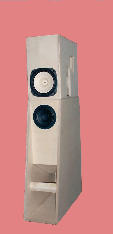

This is an example of one we did (it is 4 boxes), not really a subwoofer, but the sats work fine by themselves, adding the helper woofer means they give few excuses except for REALLY loud. It is an example of a theme, this the smallest trapezoid miniOnken, the larger ones would support bass drivers that go lower.
I will also note that the slot vents allow easy addition of (foam) damping in the vents to push the satelitte more heavily aperiodic.
In this case the woofer is an ML-TL, necessary to accomodate the necessary shape and to extract deeper bas sout of the small woofers. With a subwoofer i tend to prefer sealed.
