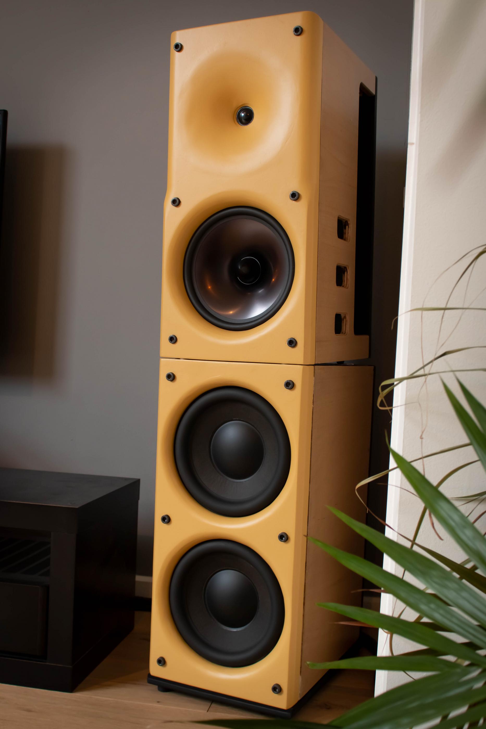

So, another update. Lot of work done. See attached images

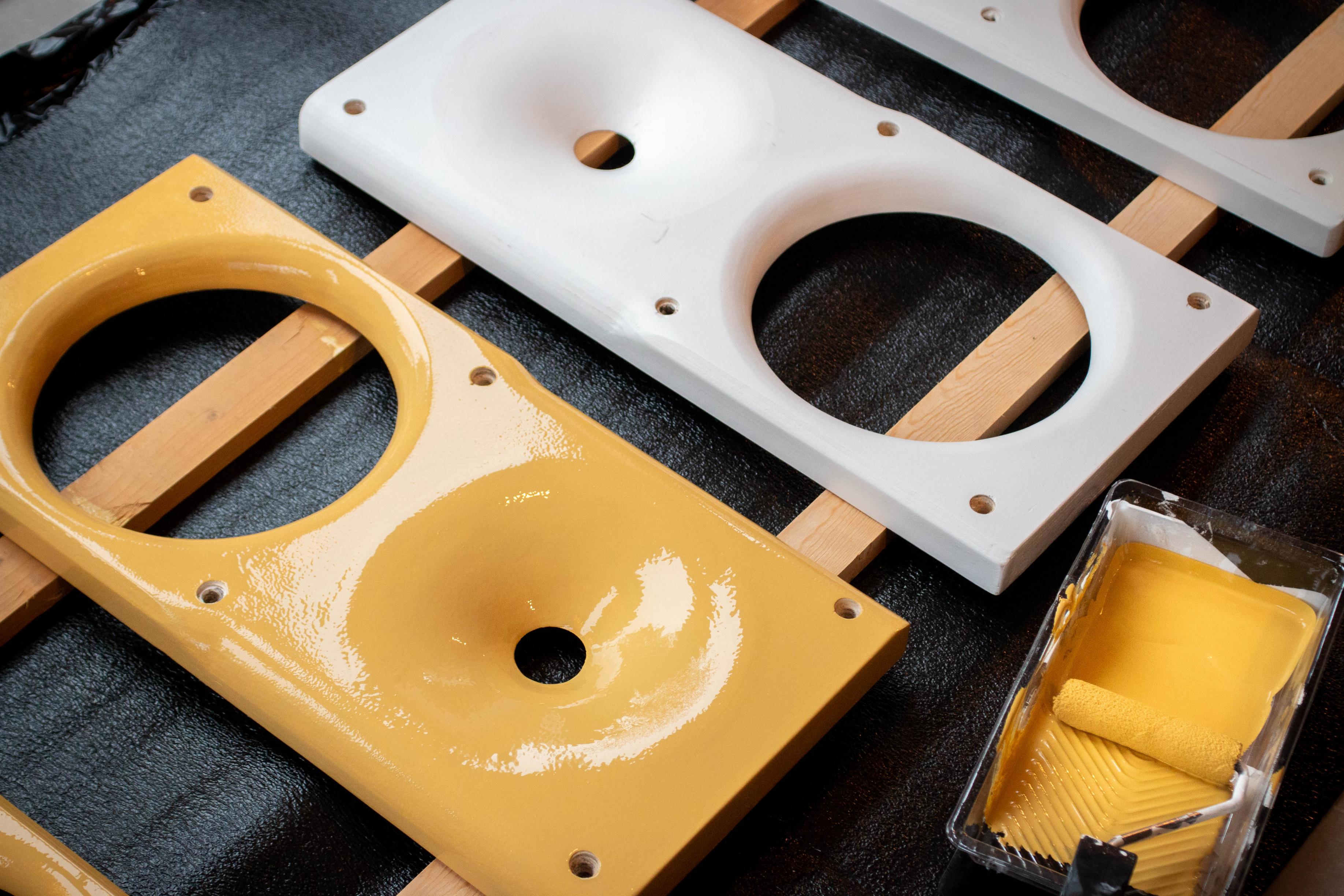

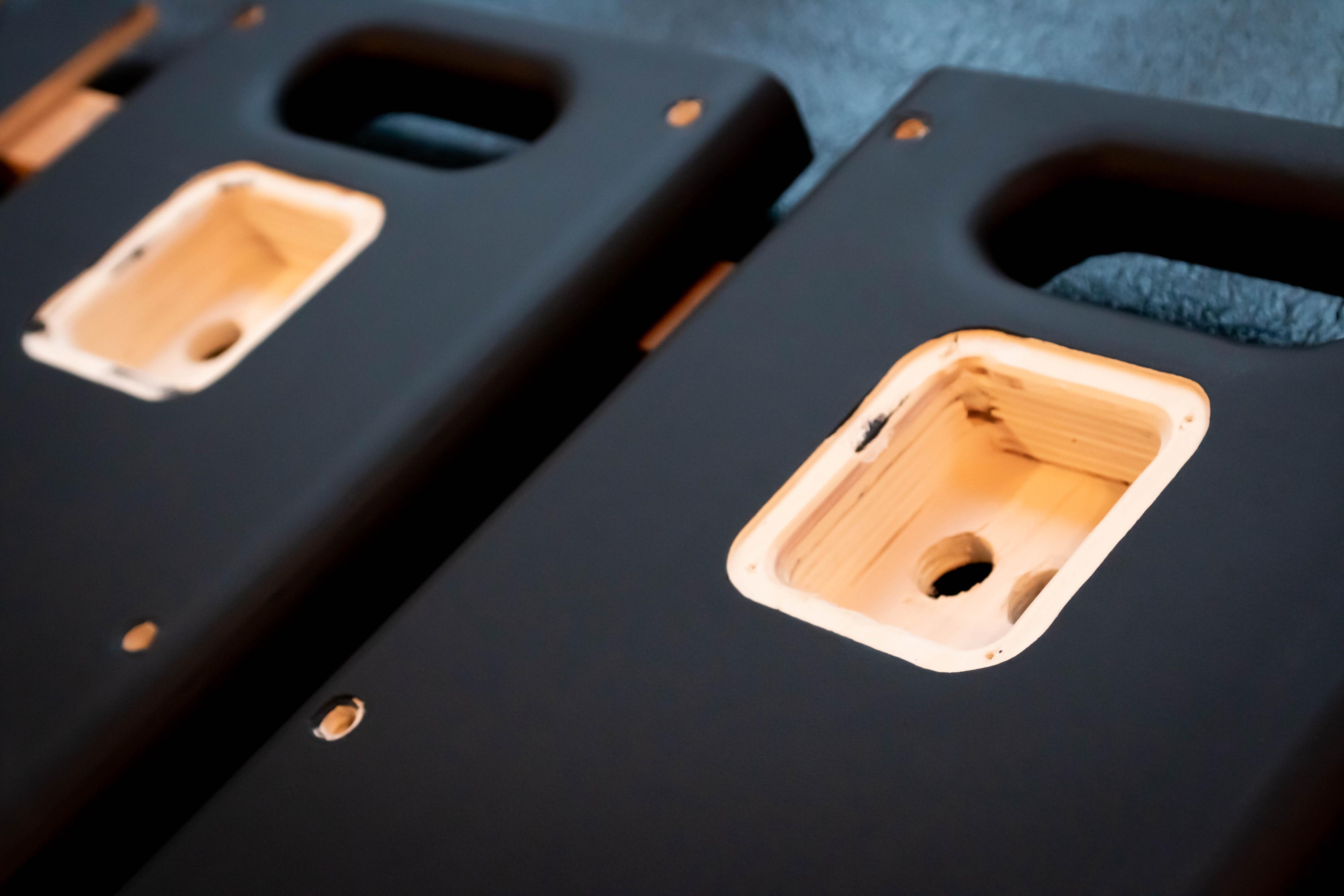

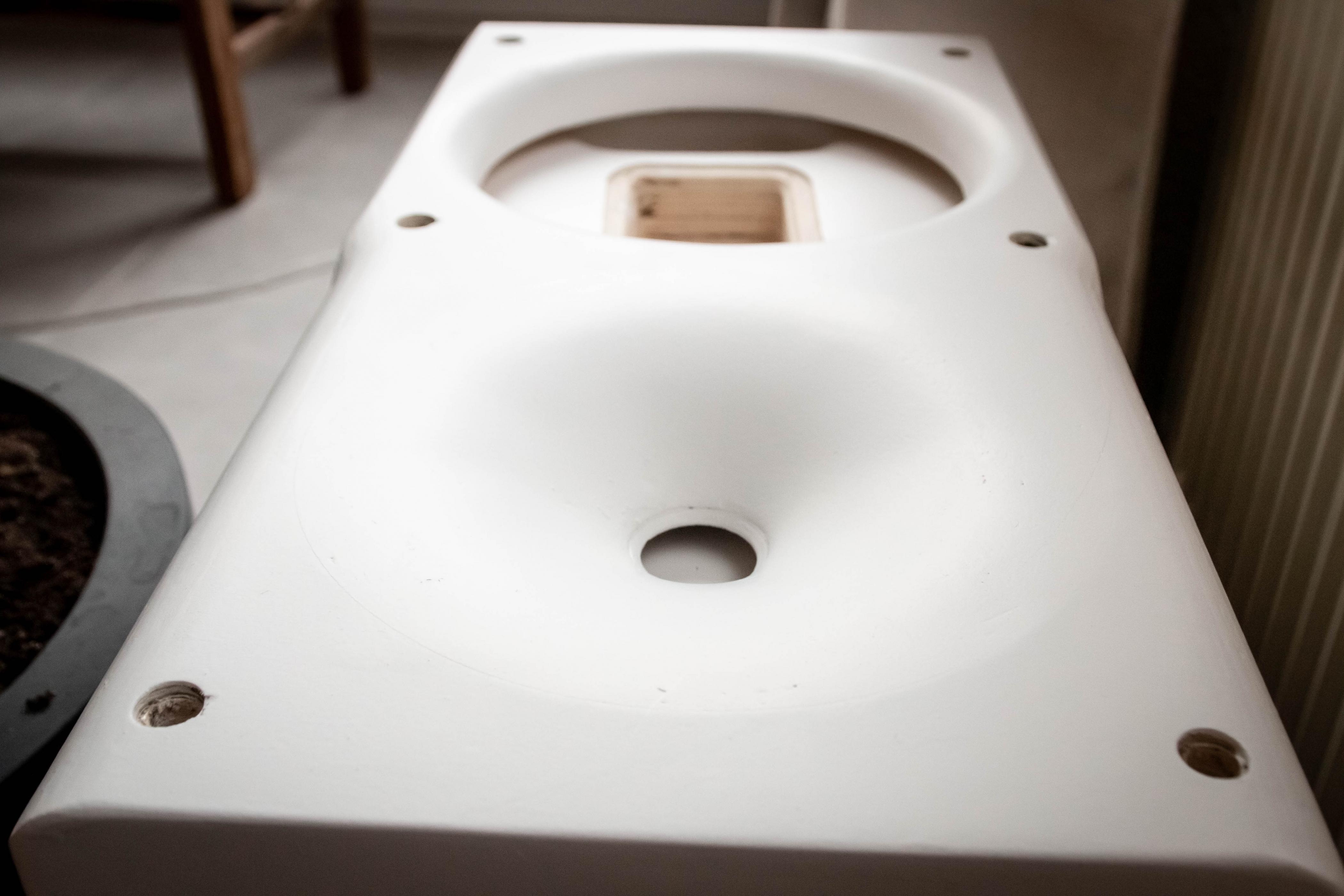

Updated the bracing of my subwoofers (also made a new baffle and rear side). And smoothed the waveguides and fabricated a new faceplate for the Dayton RST-28 tweeters which fits the waveguide throat. And i made a new crossover filter for the Dayton rs270 / rst-28 combi. The 900Hz xover using LR 4th order (acoustic) slopes, turned out to be the winner.
The phase overlap was excellent, resulting in good summing. I measured distortion using a 92dBspl sine sweep @ 1m. No rising distortion for @ xover freq was apparent for the tweeter.
And most importantly, the resulting polar response shows an improved constant directivity over the previous design using the B&C DE250. The dayton RS270 narrows at a lower frequency than the Beyma 10g400, however this is overcome by the lower xover frequency (900 vs 1200hz).

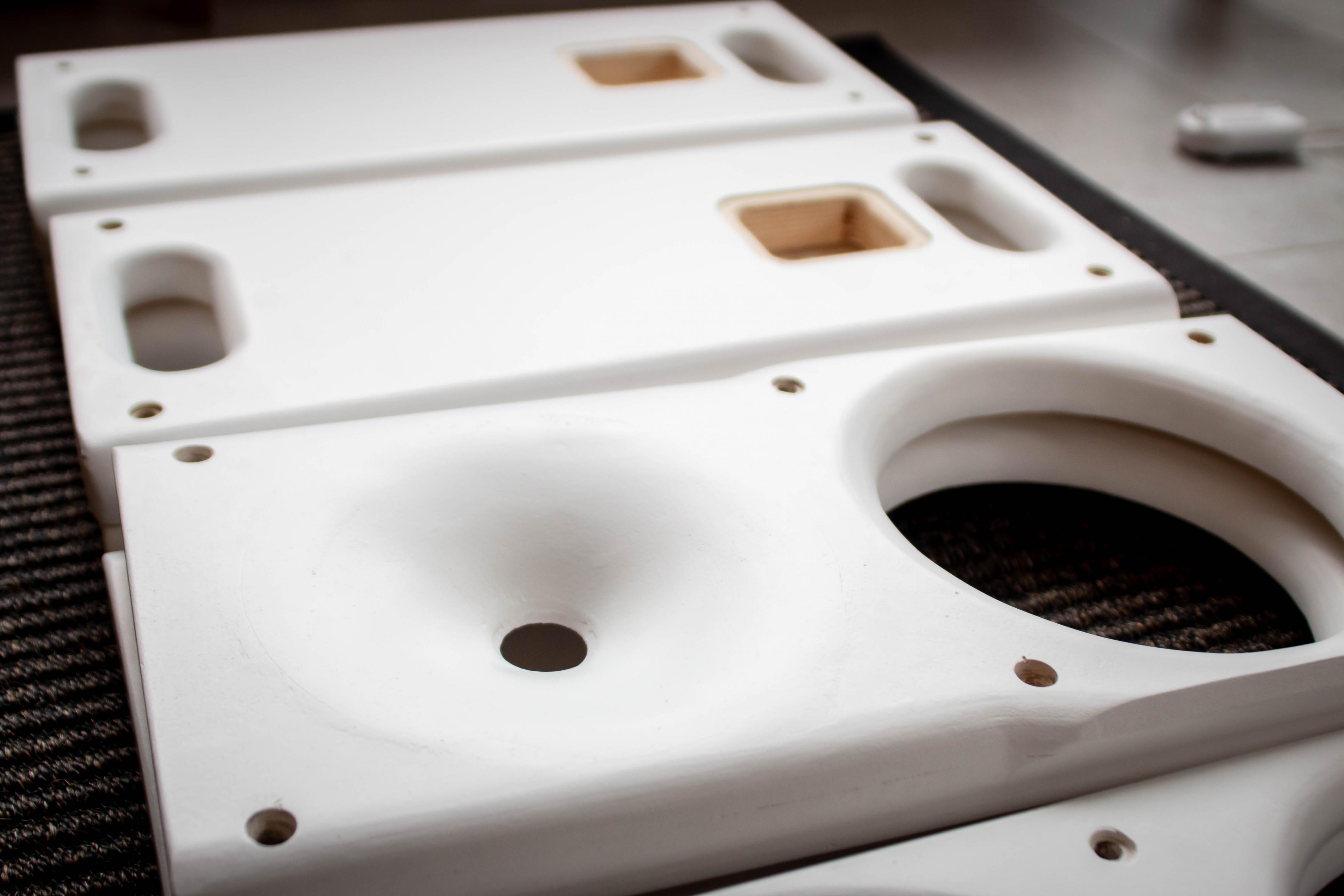

Hi Jag -
Amazing work. I'm also contemplating using the RST28 in a waveguide, and i'm really intrigued by your diy OS axi-symmetric WG using plaster/putty. Could you share some more details of the WG making process?
Sounds like using the RST27 without the grill is the winning combination? Could you share what is the throat diameter you used to match the tweeter? What is the throat angle in the WG?

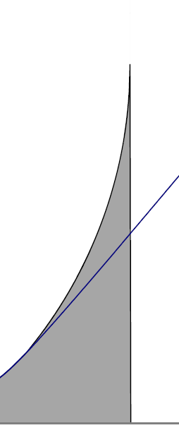

Thank you. Here is more info on how you make a waveguide out of plaster. The throat diameter is 37mm. I use a 45degree angle for the mouth. The profile looks like this
attachment.php
Indeed without grill is the winning option. You could consider trying a 0deg exit with a small radius transition to 45 degree. I haven't tried this option for the rst28.
Next on the to do list is re-doing the multi sub setup using multi sub optimizer. My room had some acoustic changes (new doors, change of floor type). And after that all 8 new panels (4 baffles, 4 rear sides) need a finish :)

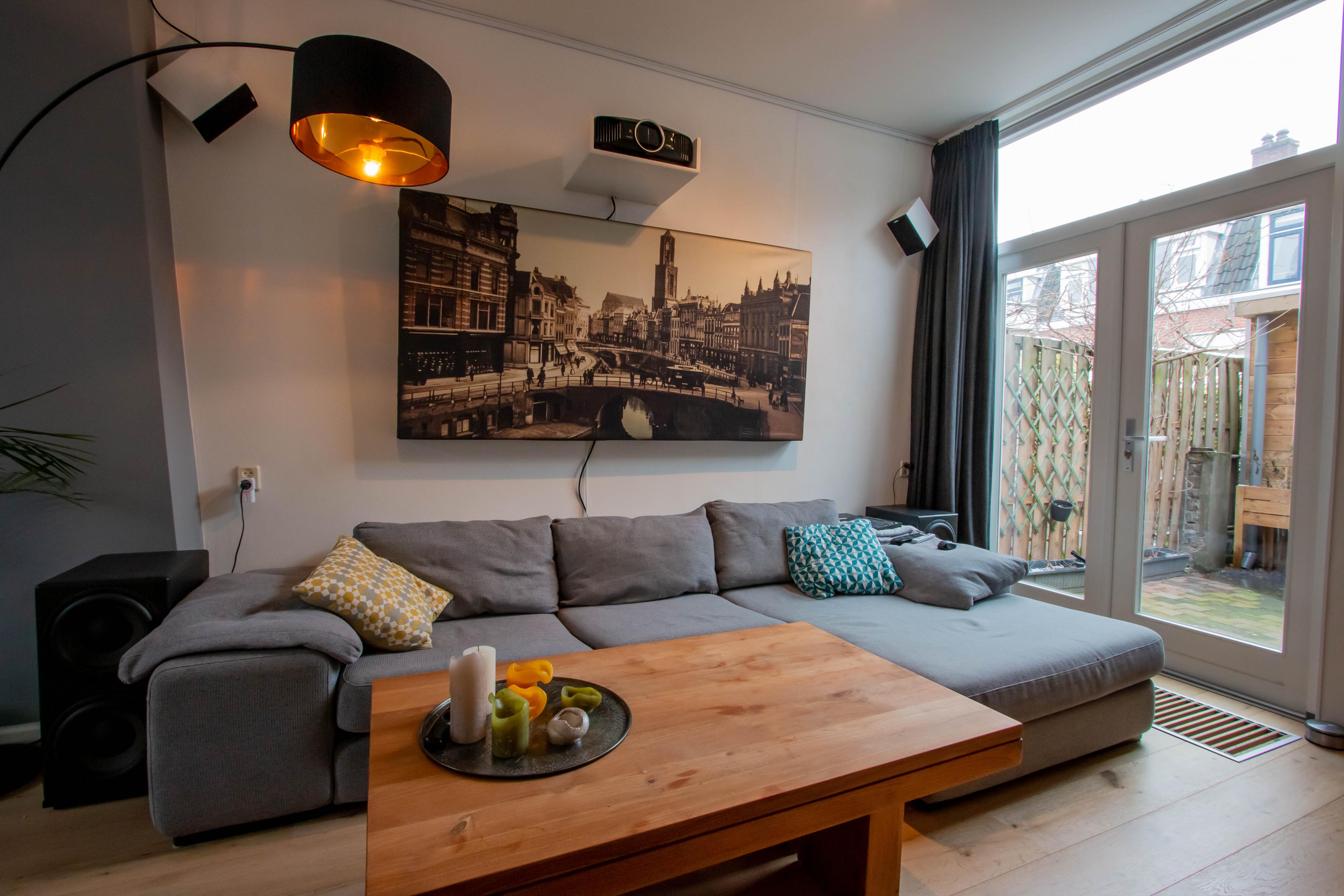

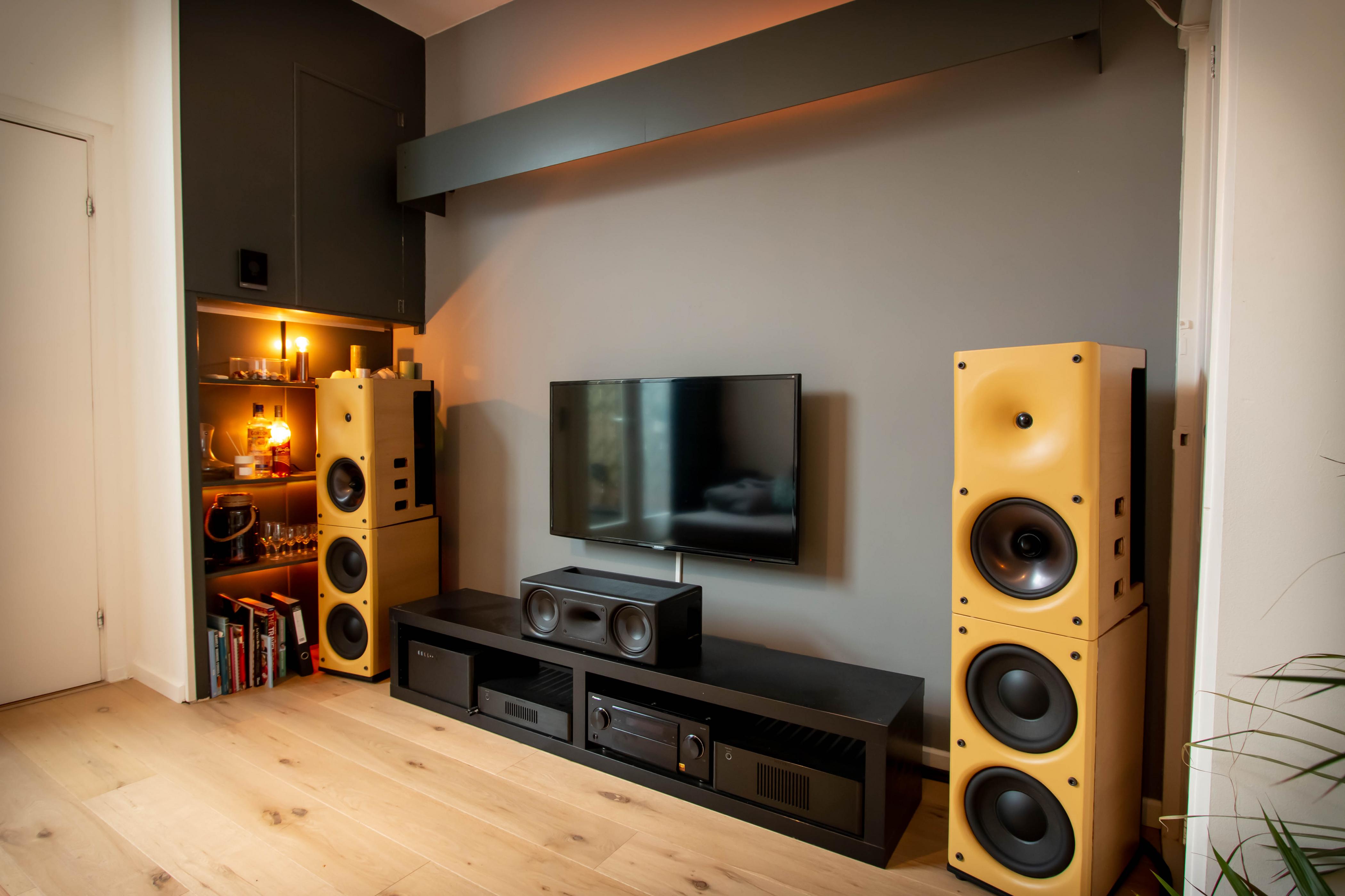

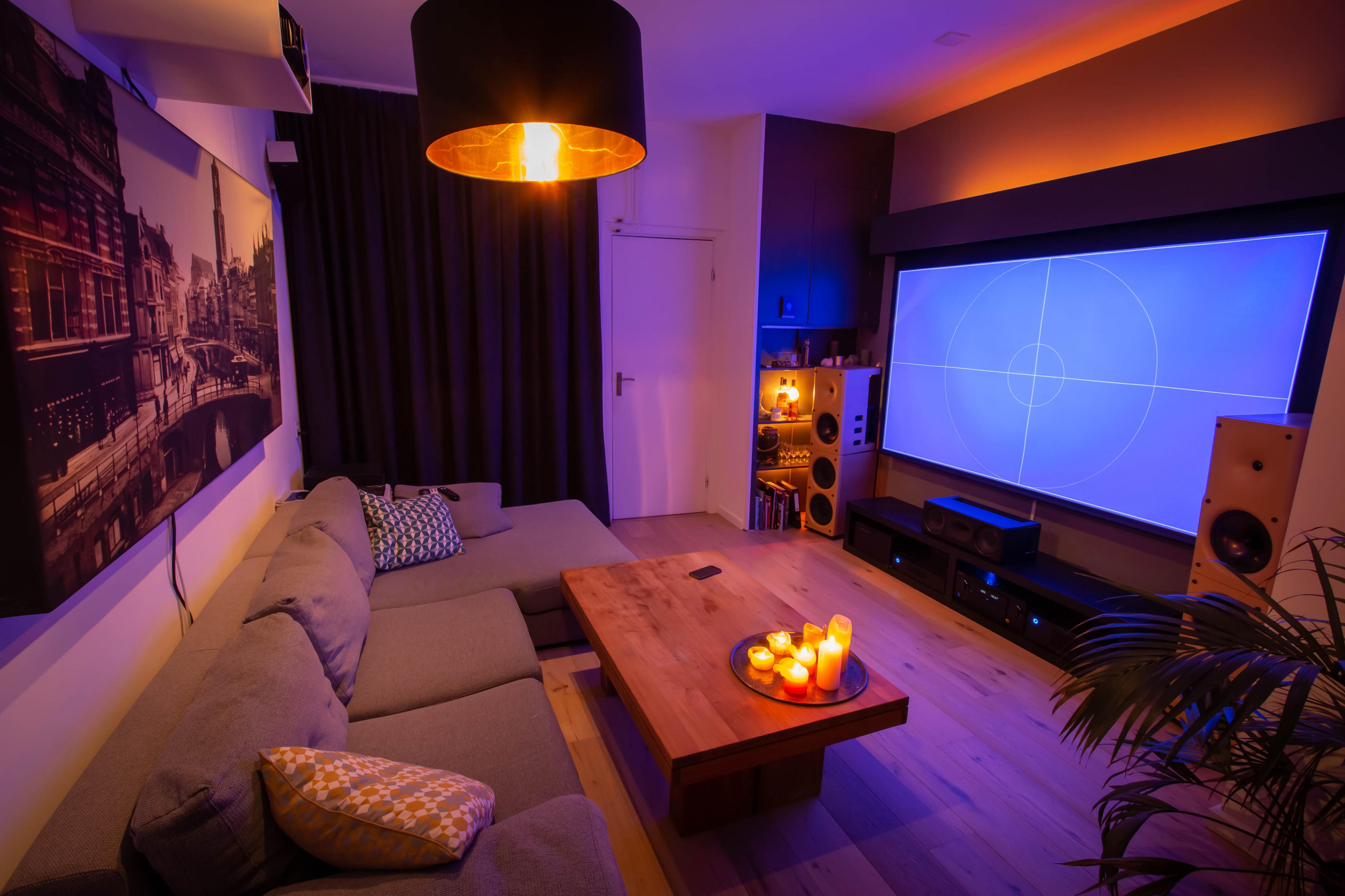

Finished build pics of my european style HT :)
