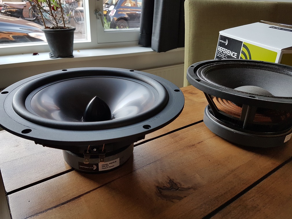

Before anything else, i will try the newly bought Dayton rs270 woofers 🙂.

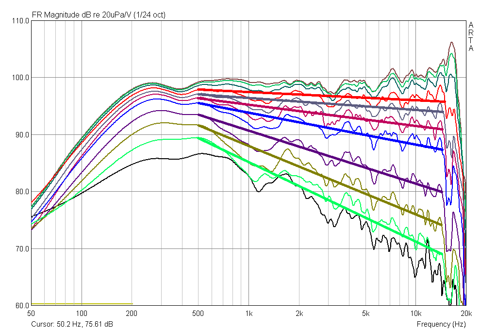

I just made a figure to go with my last post to show what I mean when talking about the trend from 500 Hz and up:
As it is now you are EQ-ing the response on-axis flat which results in a power response with a dip around XO. It should be very easy to test, just clamp two pieces of wood over the sides of the woofer. Start covering 1/4 of the width from both sides and go from there.

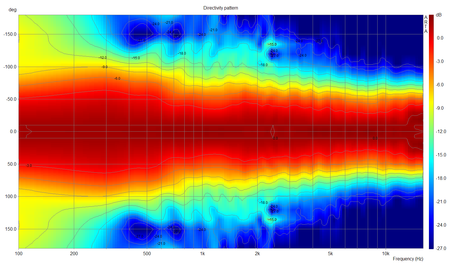

I understand what you mean. Indeed it does have some progressive directivity. The polar is a litte wider around 500Hz and then gets narrower between 1 - 2KHz. It might also be that the widening @ 500Hz is related to the cardiod midwoofer enclosure and the widennig @ 2KHz to the baffle. It would be interesting to see how it look in a sealed enclosure. I will try to post the results soon.I just made a figure to go with my last post to show what I mean when talking about the trend from 500 Hz and up:

That diagram is worst case scenario of a circular baffle, a rectangular baffle will smooth out the response above the dipole peakAbout dipole radiation characteristics,

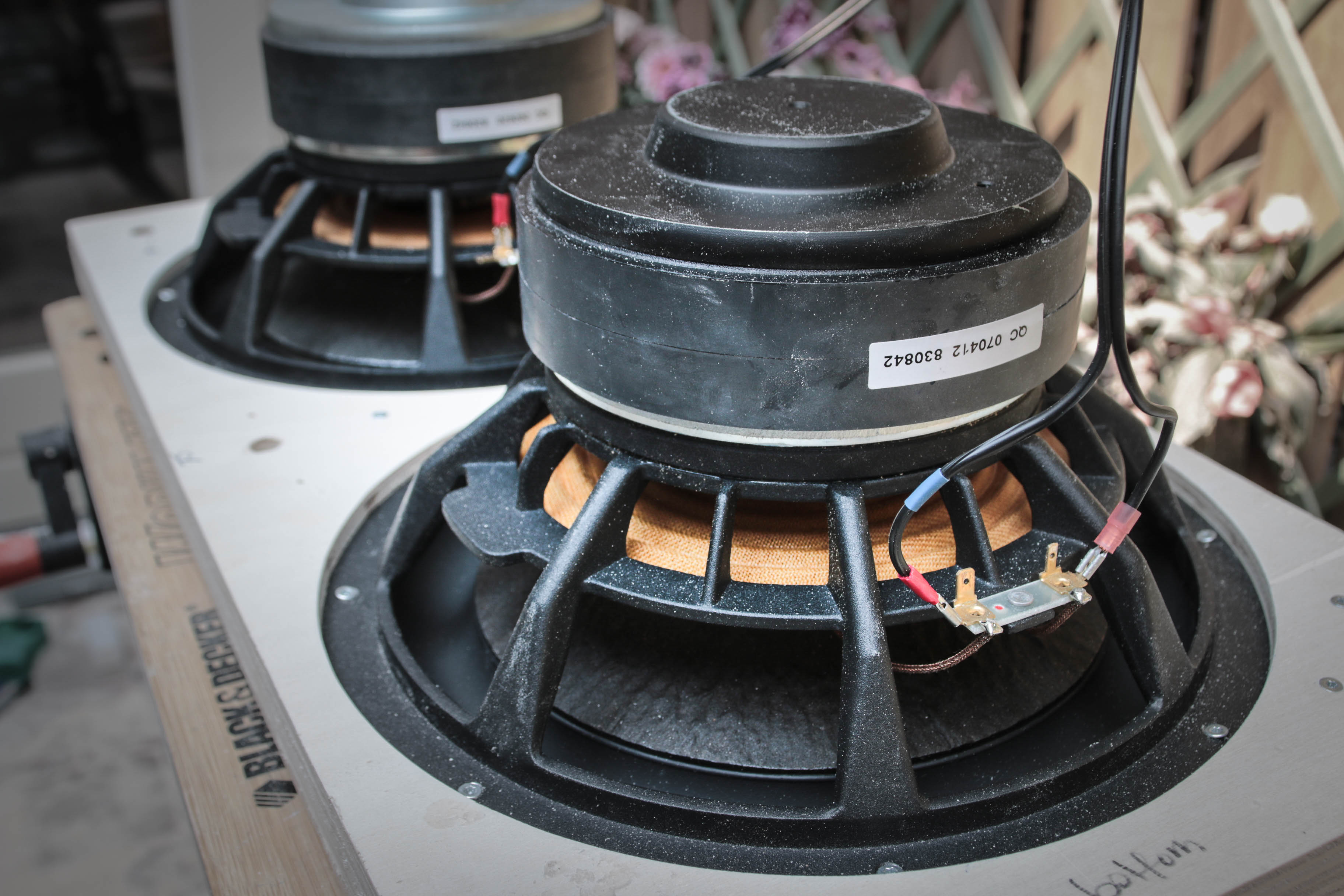

Yesterday i installed the Dayton rs270's. I don't notice any harsnesh in the midrange anymore with these units. Measurements (and more listening) will follow.

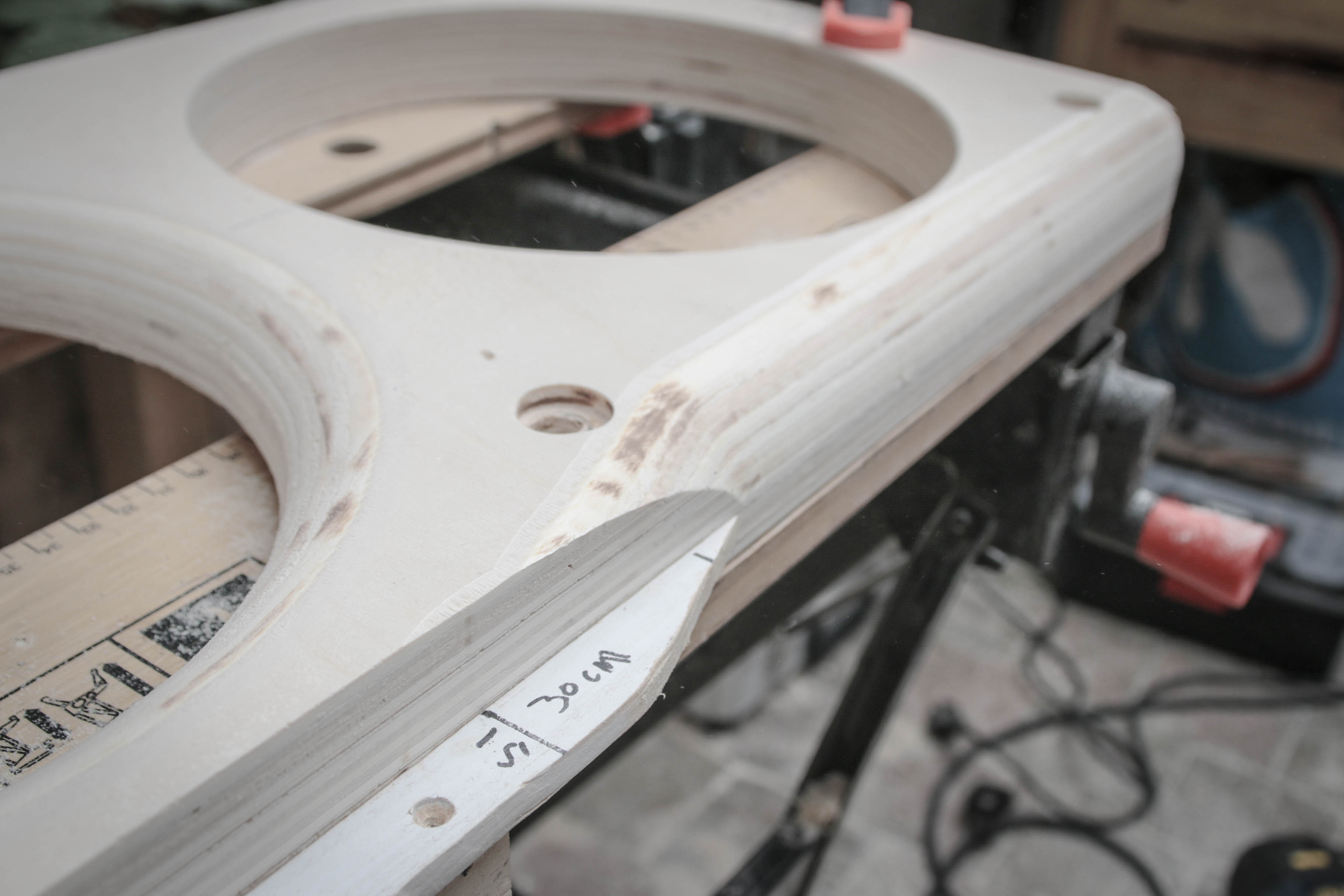

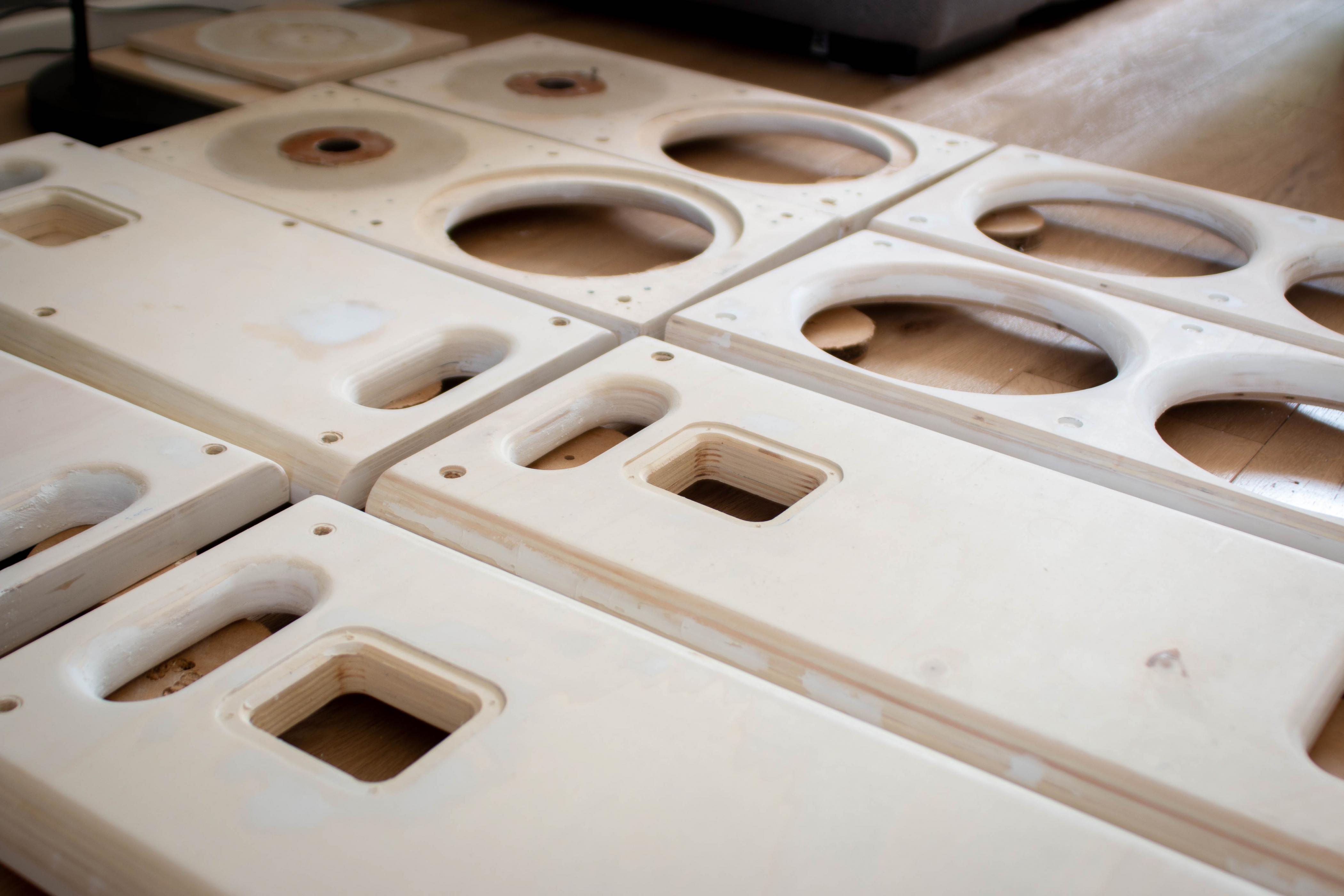

New baffles in the making 🙂

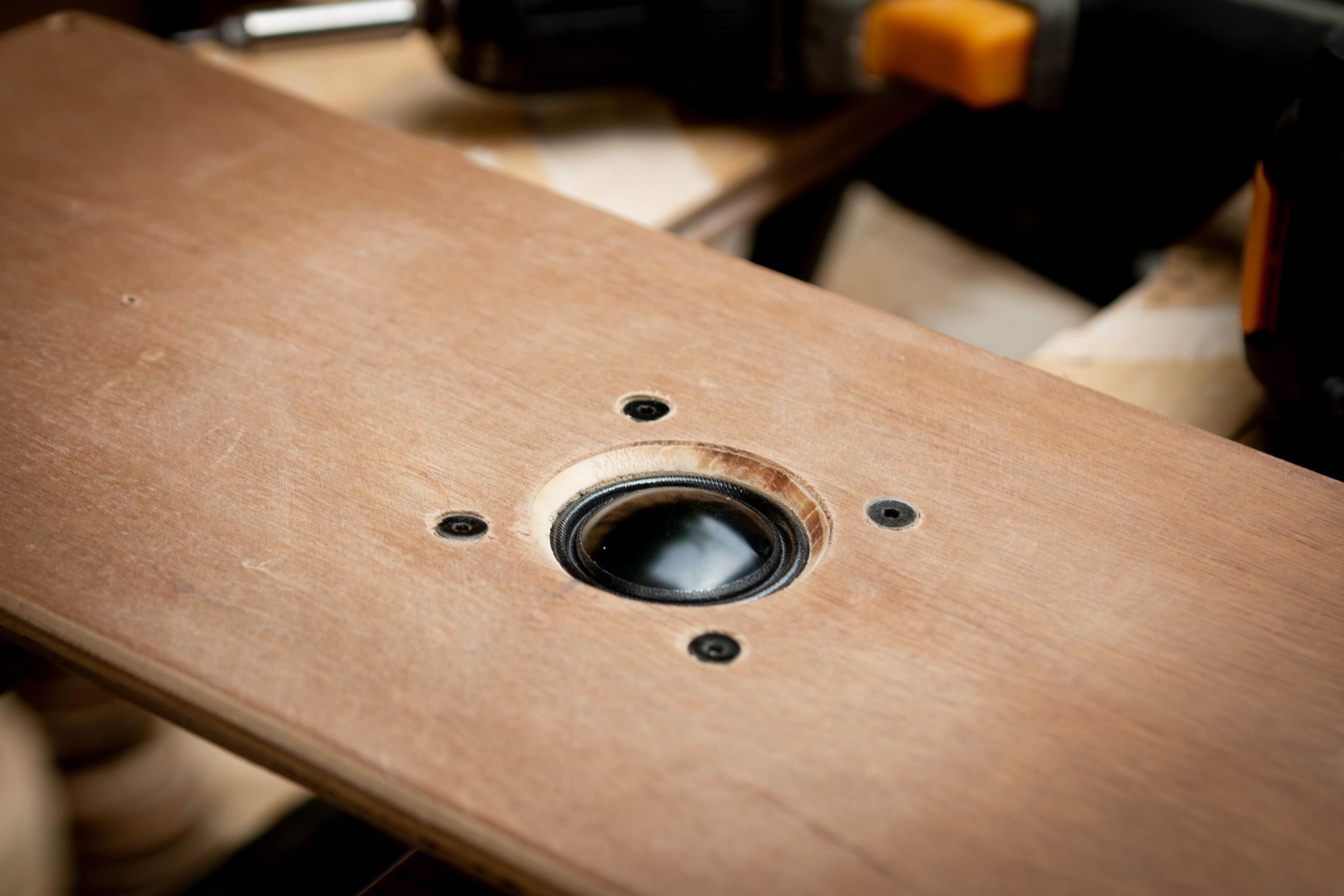

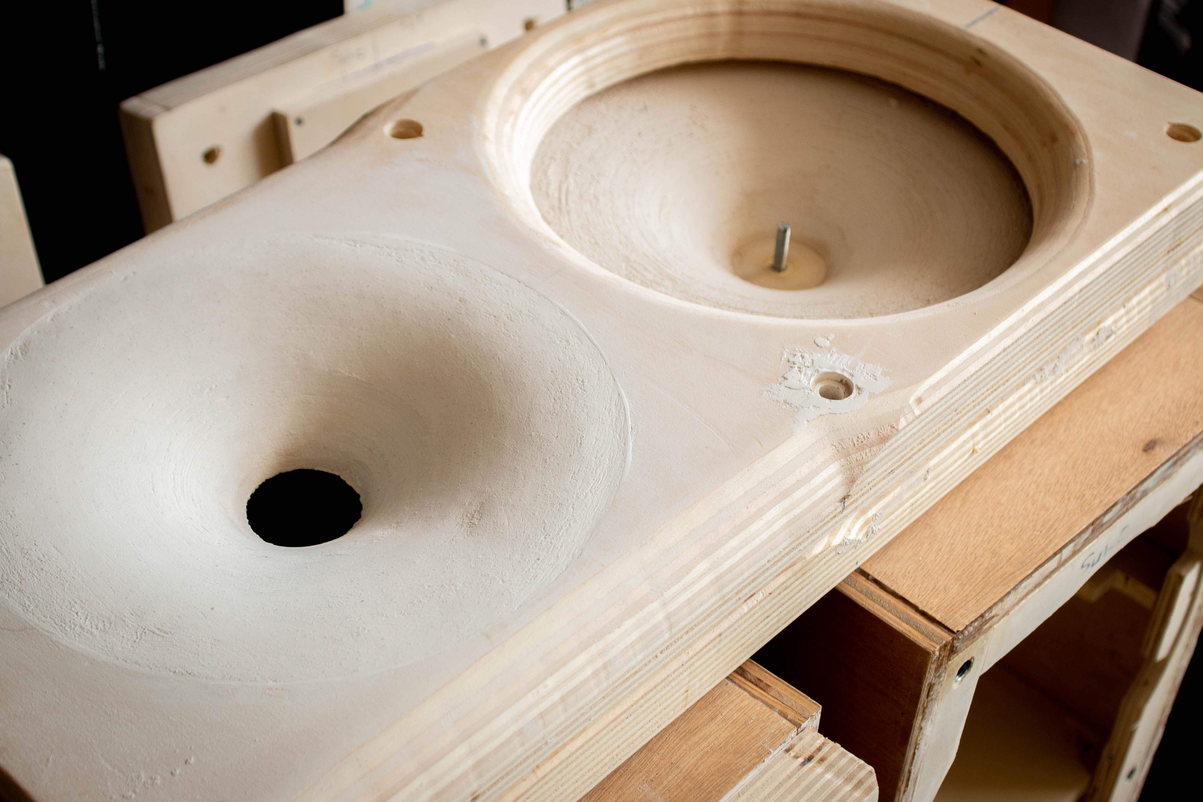

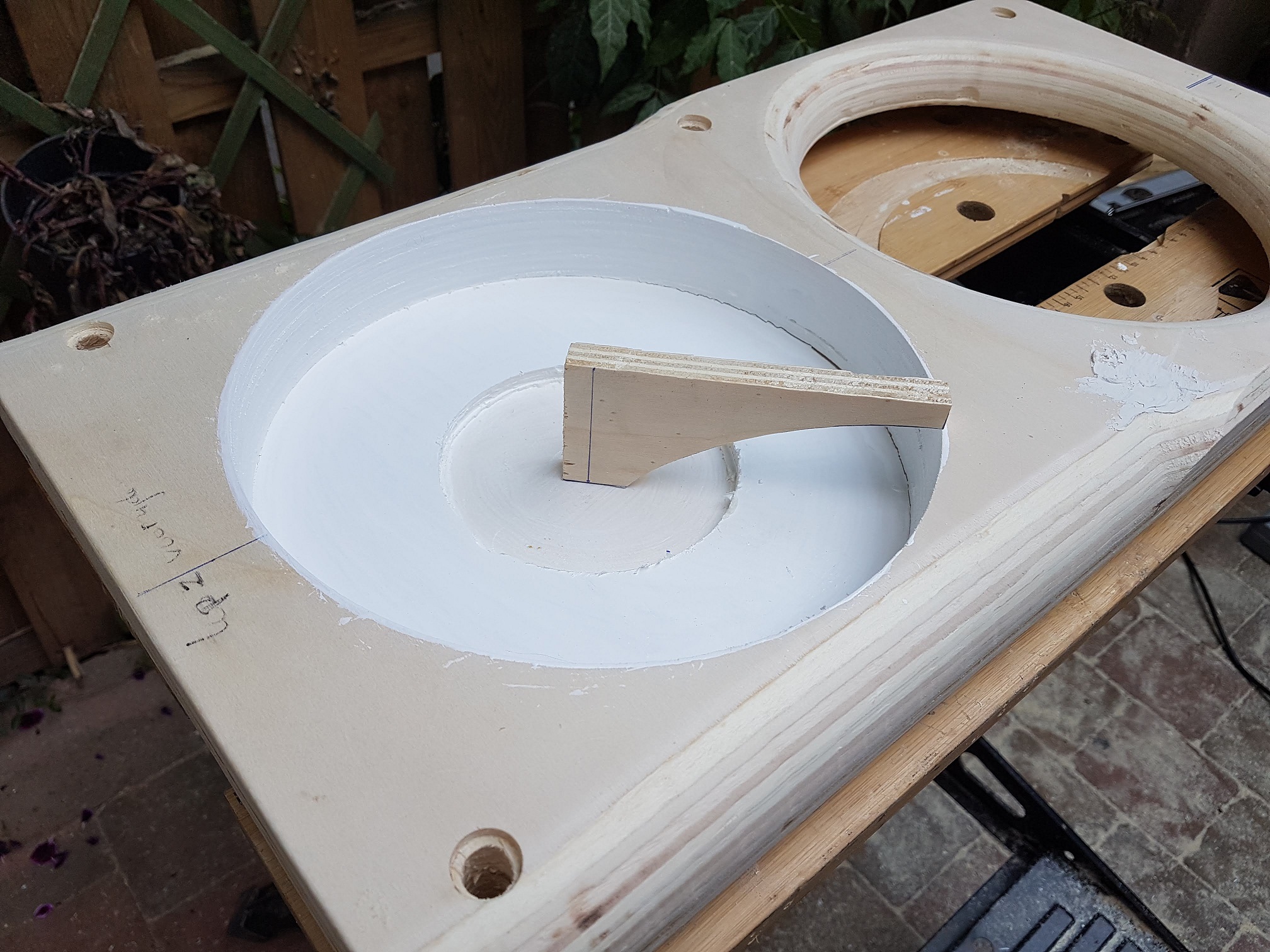

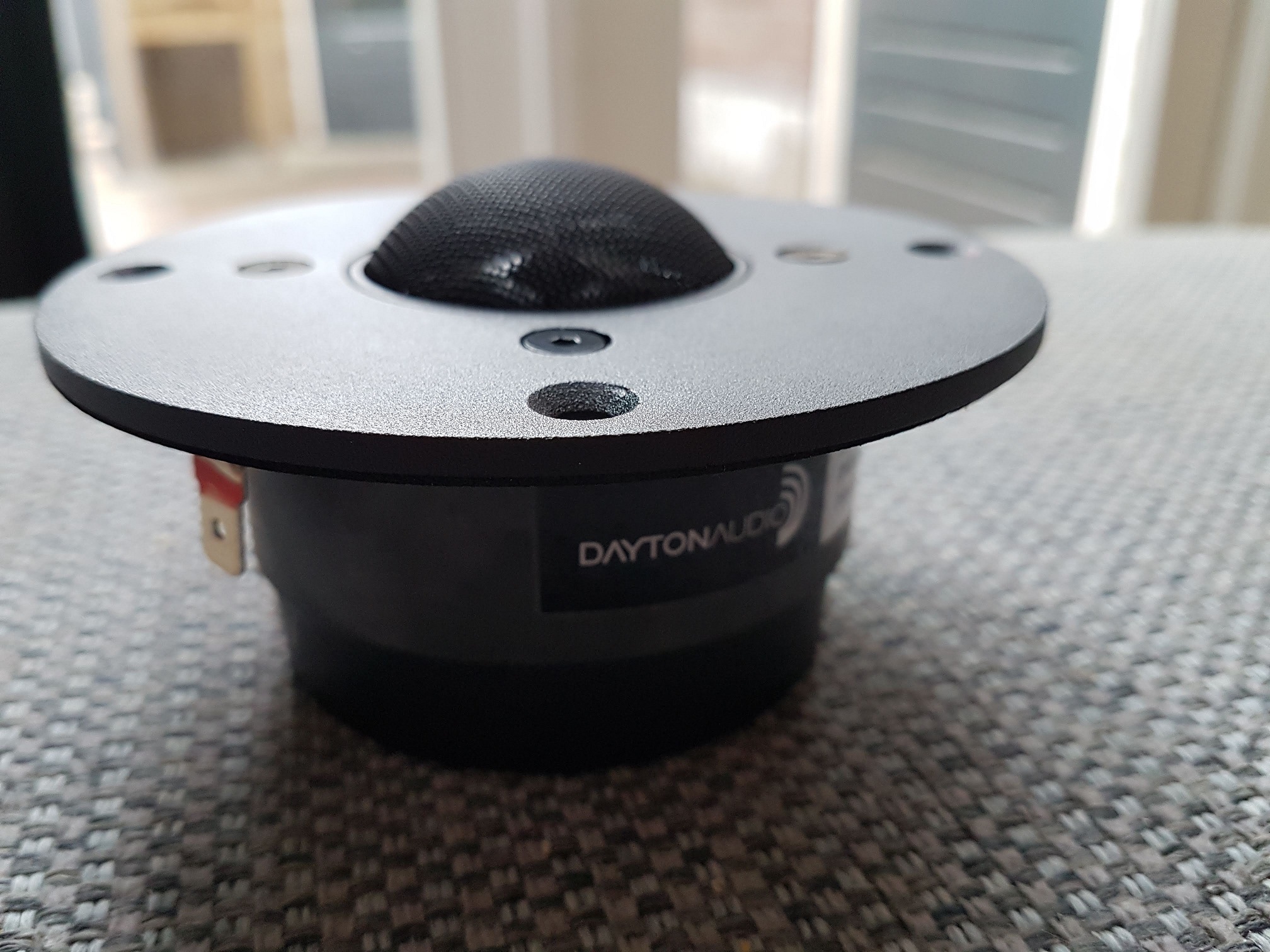

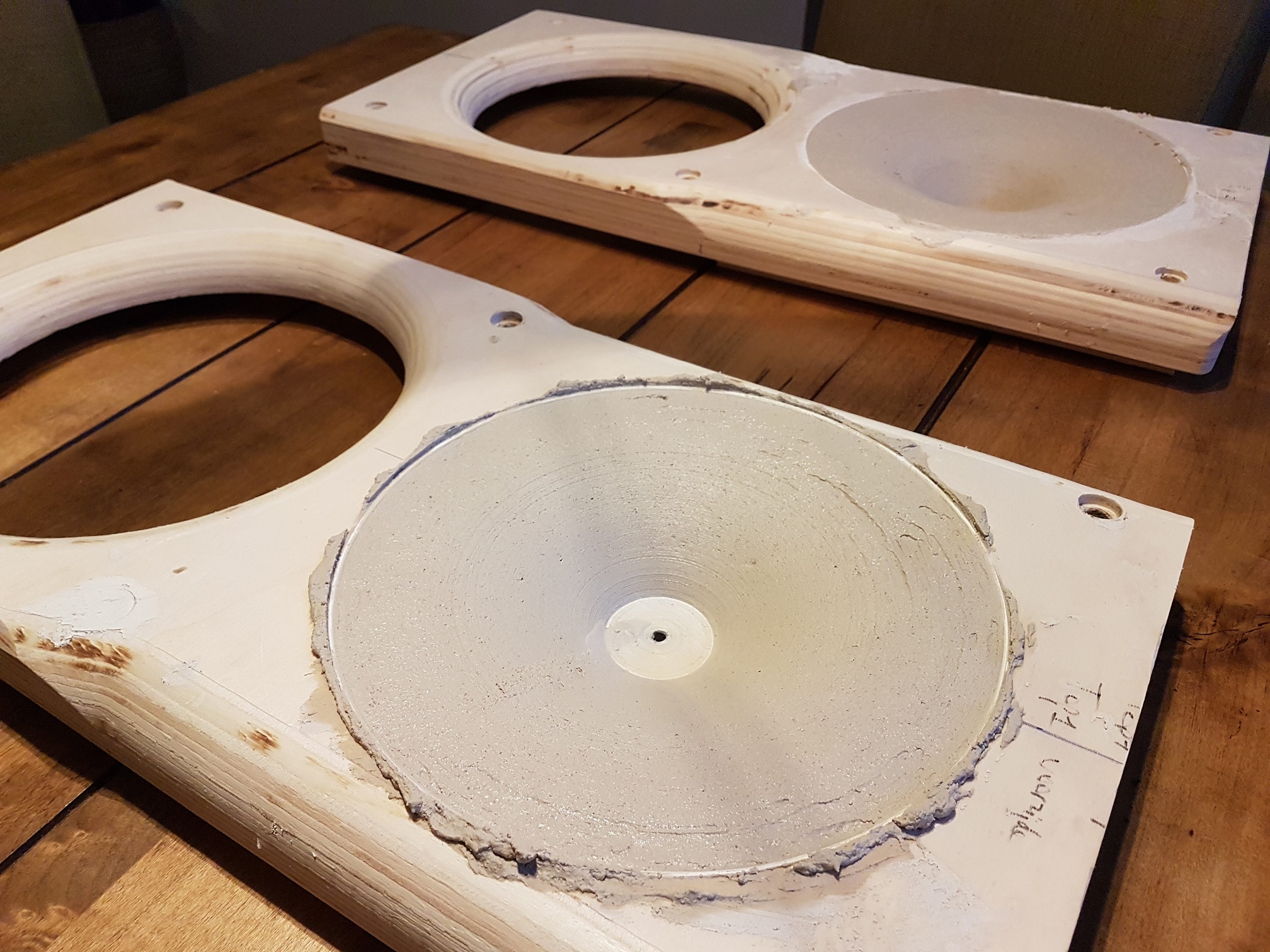

Just before leaving for vacation, i built two waveguides for the Dayton rst-28-a tweeters. One version which fits the tweeter with grill and phase bridge in place. And one version without grill to reduce any space left between tweeter edge and start of waveguide. Ill leave them to dry and make some measurements when i get back.

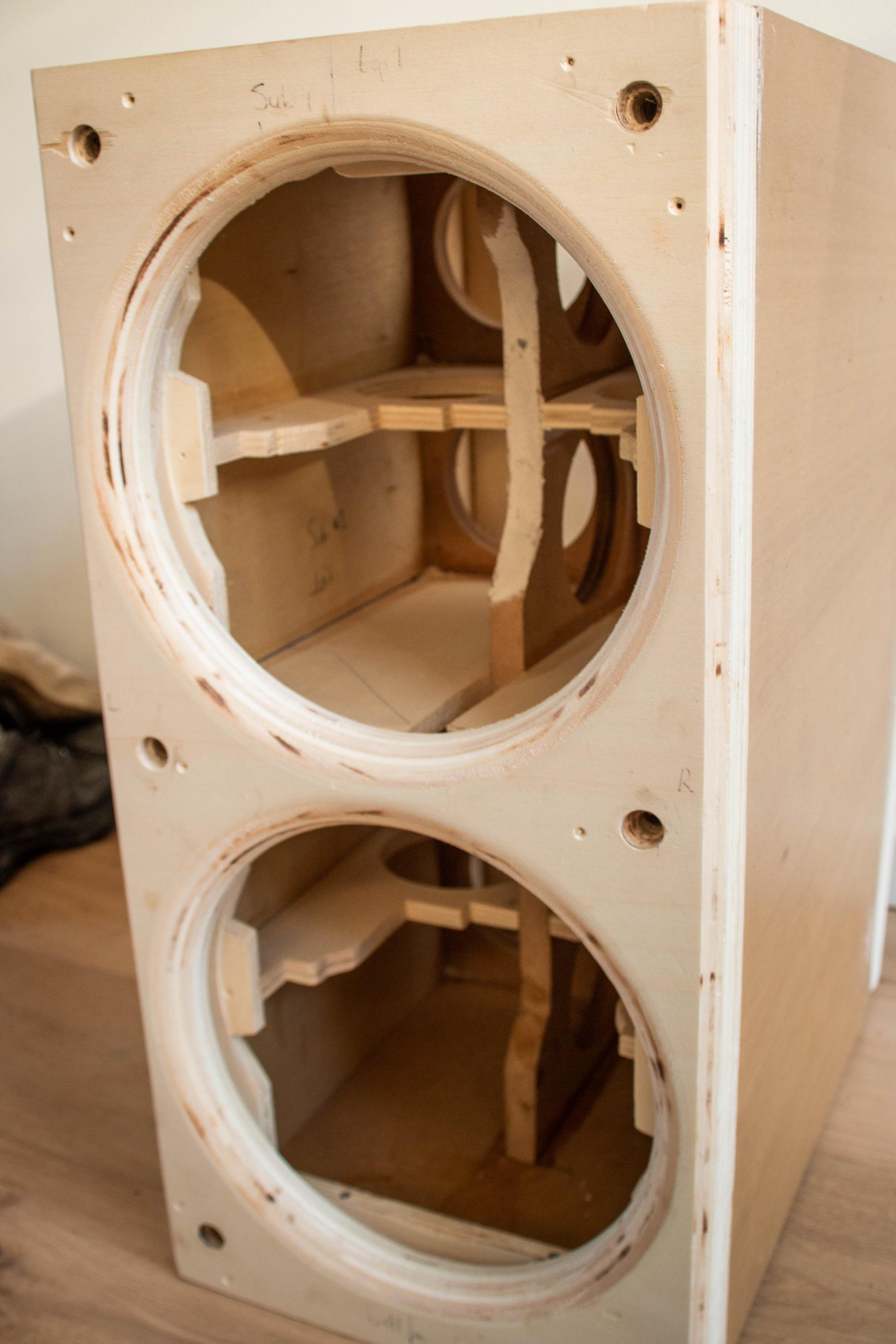

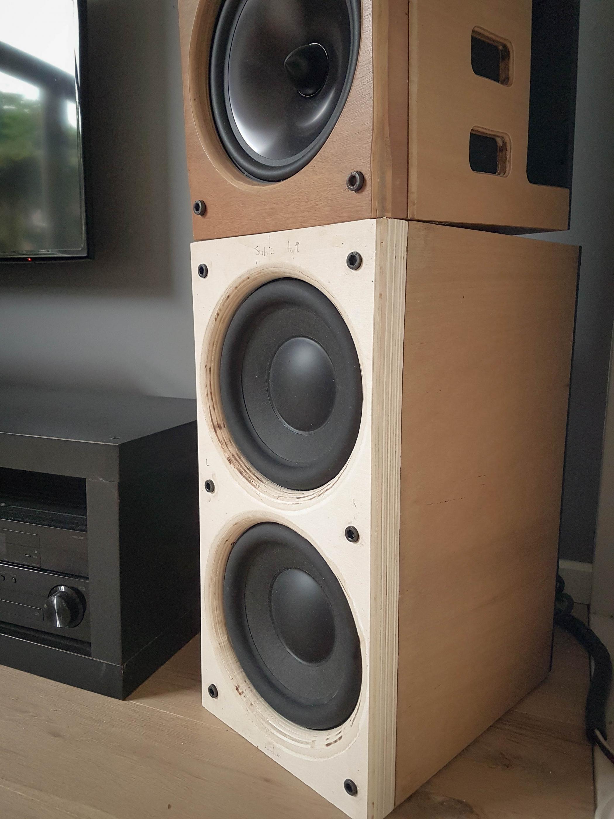

So, another update. Lot of work done. See attached images

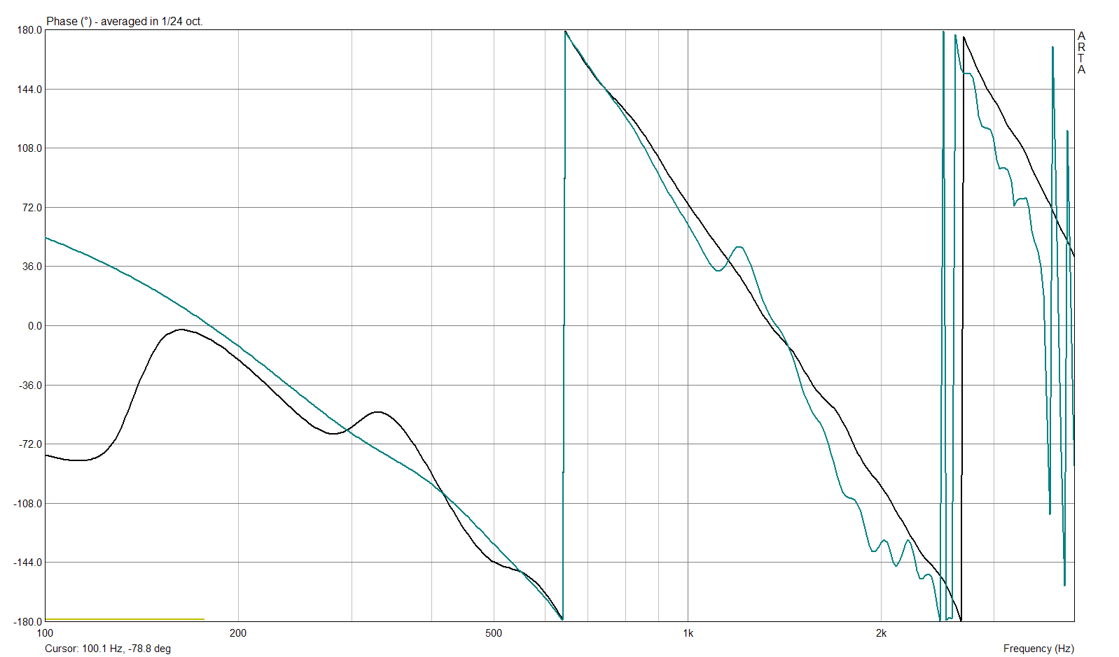

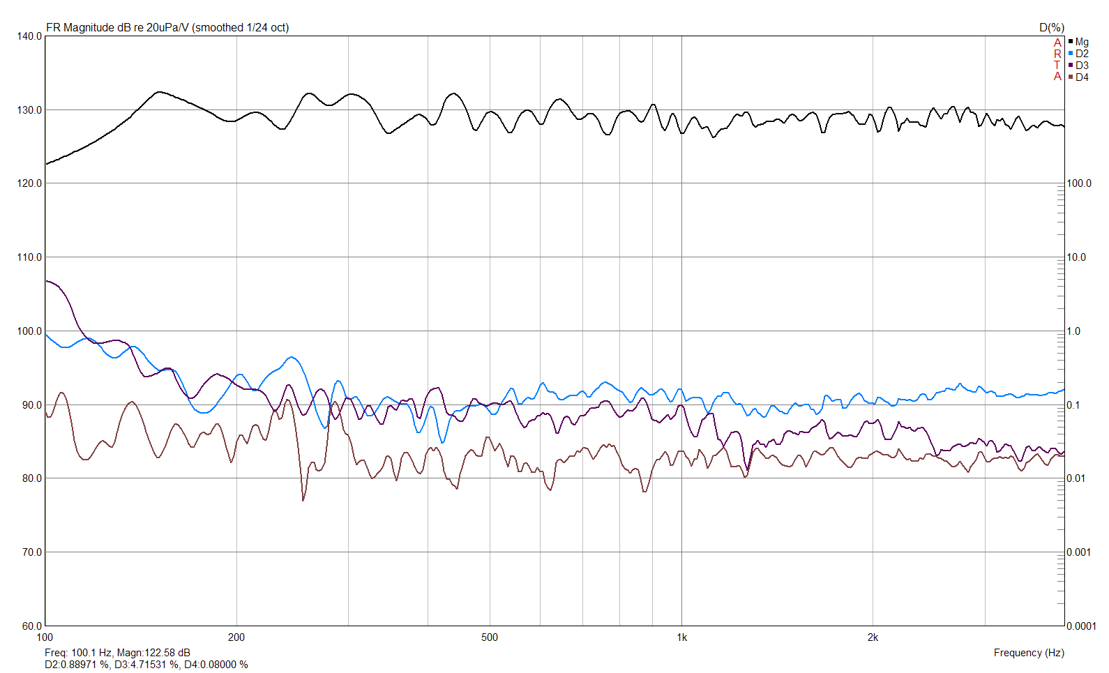

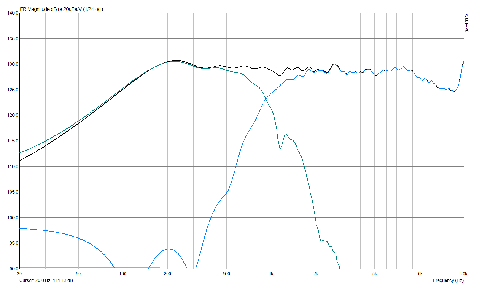

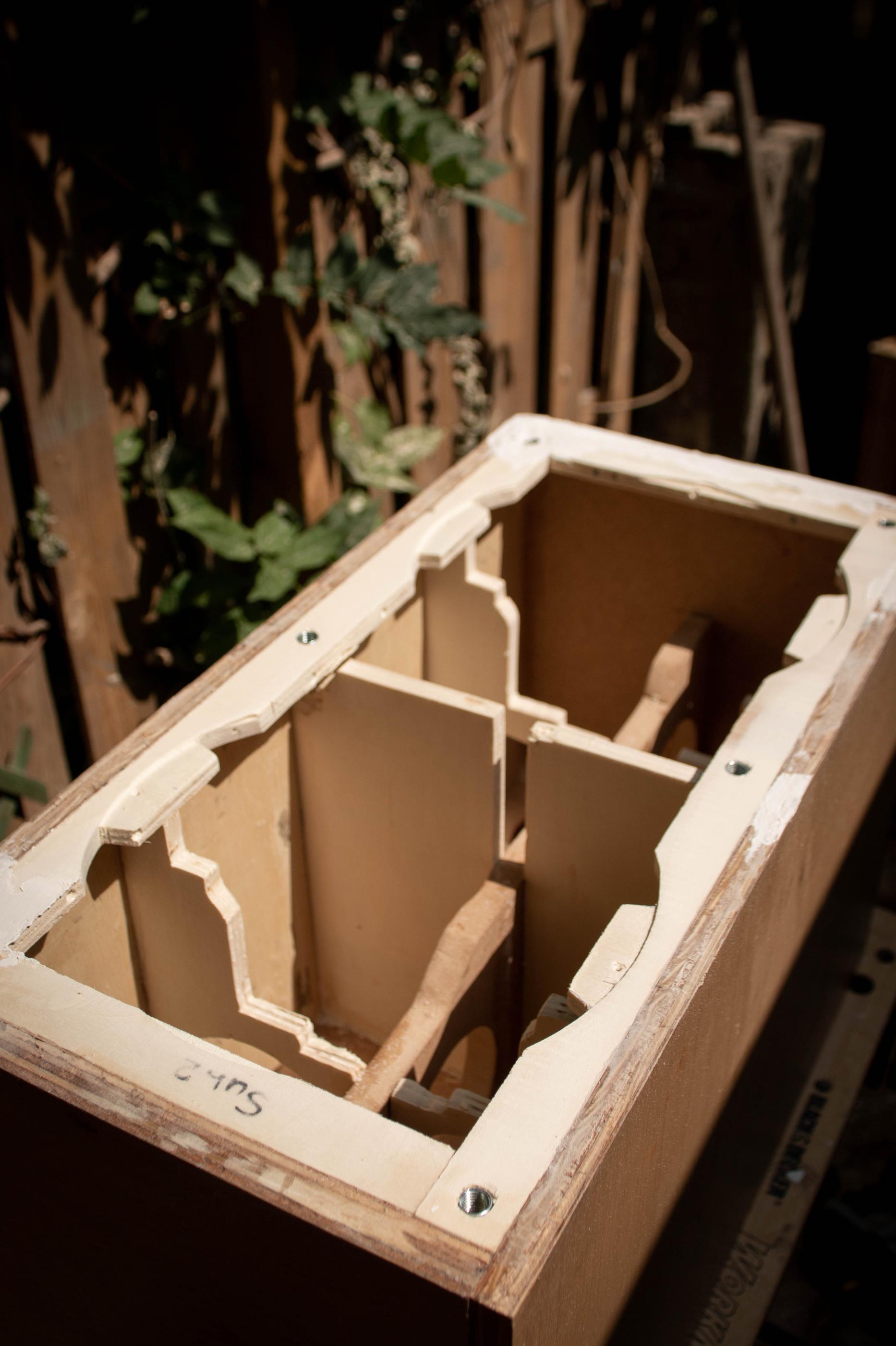

Updated the bracing of my subwoofers (also made a new baffle and rear side). And smoothed the waveguides and fabricated a new faceplate for the Dayton RST-28 tweeters which fits the waveguide throat. And i made a new crossover filter for the Dayton rs270 / rst-28 combi. The 900Hz xover using LR 4th order (acoustic) slopes, turned out to be the winner.
The phase overlap was excellent, resulting in good summing. I measured distortion using a 92dBspl sine sweep @ 1m. No rising distortion for @ xover freq was apparent for the tweeter.
And most importantly, the resulting polar response shows an improved constant directivity over the previous design using the B&C DE250. The dayton RS270 narrows at a lower frequency than the Beyma 10g400, however this is overcome by the lower xover frequency (900 vs 1200hz).
Next on the to do list is re-doing the multi sub setup using multi sub optimizer. My room had some acoustic changes (new doors, change of floor type). And after that all 8 new panels (4 baffles, 4 rear sides) need a finish 🙂

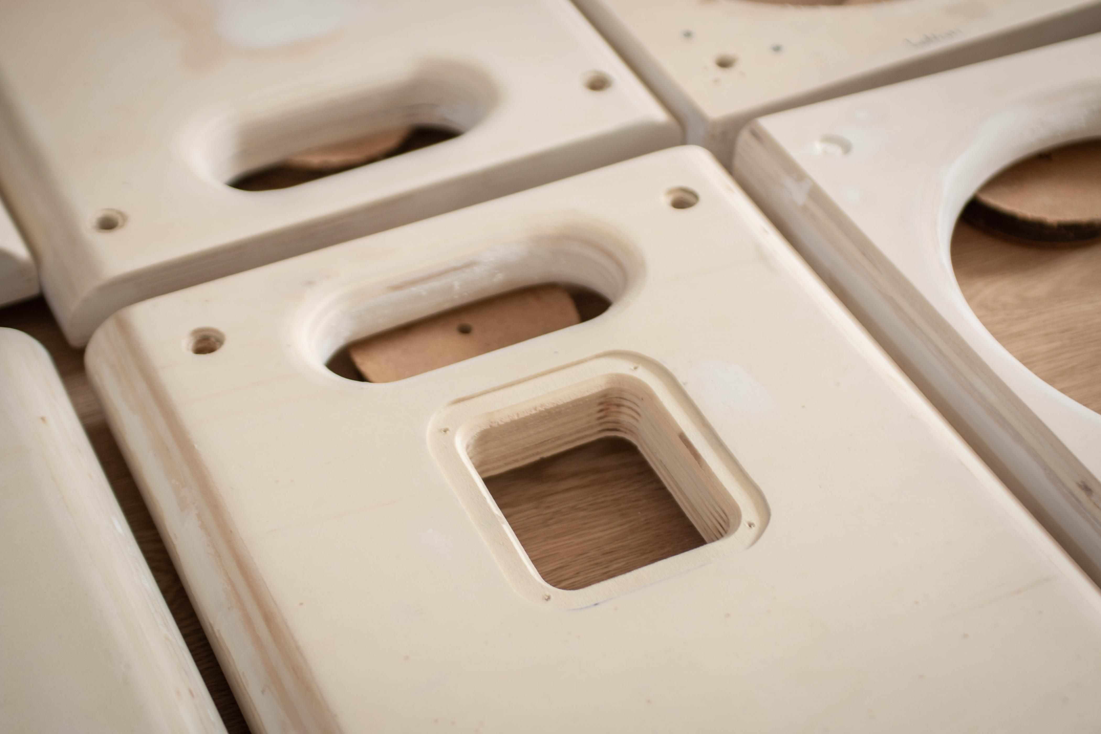

Amazing result.
Can you tell some more about your side cut out for the mid ... why the chosen size etc. and the stuffing ... your experience and tuning of the directionality with the amount of stuffing
The low crossover at 900 for a relatively small tweeter ... any harshness at higher levels?
Distortion measures at higher levels (I take it your measurements are not really at 122 db)?

Thank you 🙂. Side cuts are aprox 1/2 Sd. Increasing the distance between woofer and side port is supposed to degrade midbass off axis performance, but off course lowers the frequency at which LF roll off starts. I used akotherm for stuffing, before that rockwool. It both works, only akotherm is much more precise.
I didn't notice any harshness @ 900Hz so far. Distortion measurements were @ 92 dB(C)spl.

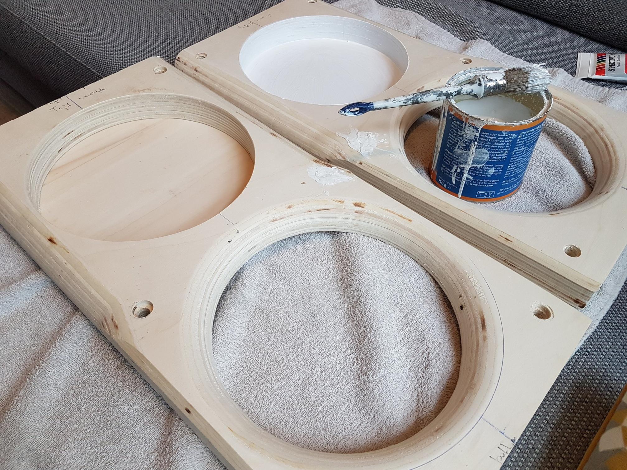

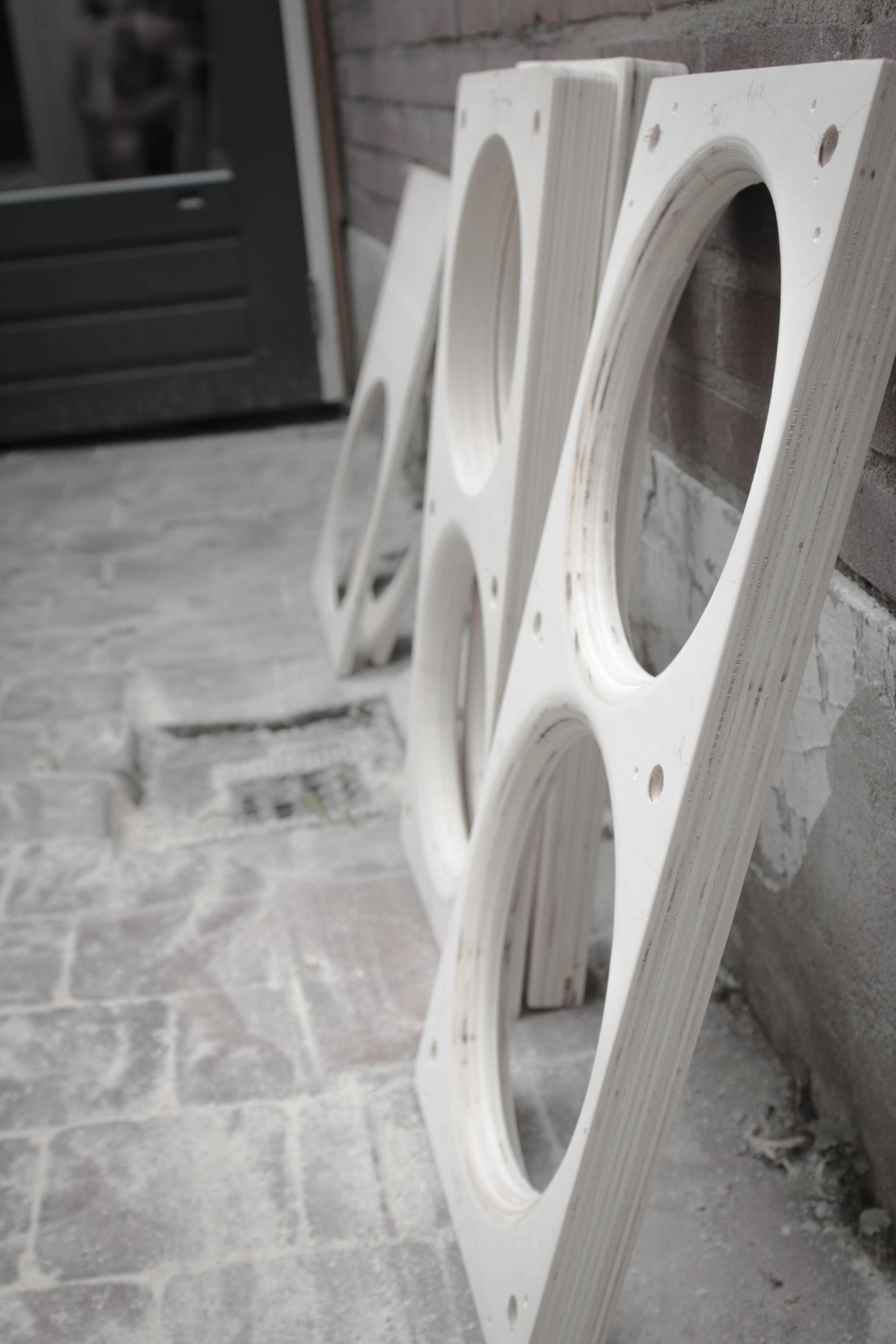

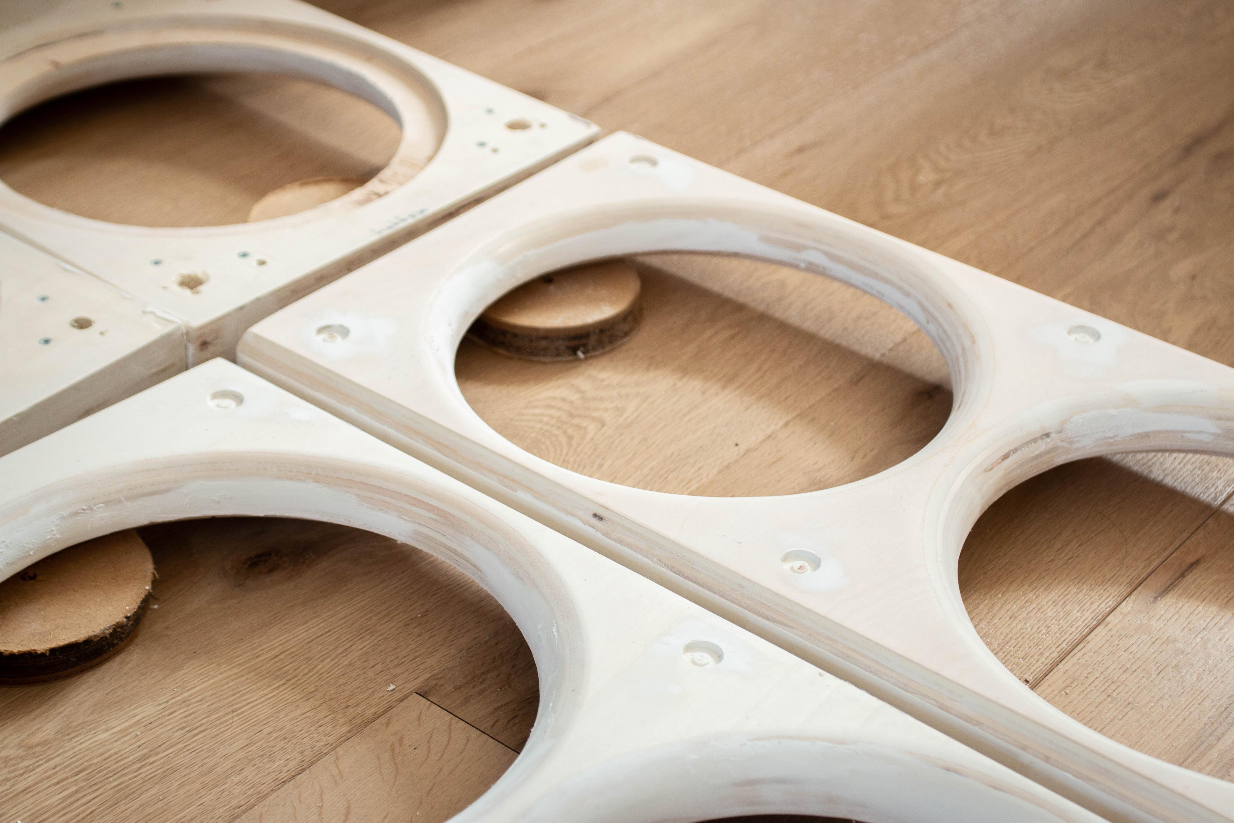

Now it is time to put on a finish on the new baffles / rear sides. I already did three rounds of filler / sanding. Maybe ill do a (small) fourth round 🙂. Mostly to correct for some small router errors (i do everything by hand). Finish will be a light matt lacquer.
Almost ready for the first layer of paint
However there's a problem with one of the waveguides, it didn't turn out quite right. The backside collapsed a bit. Still thinking about how to correct it.

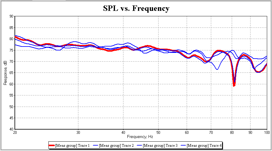

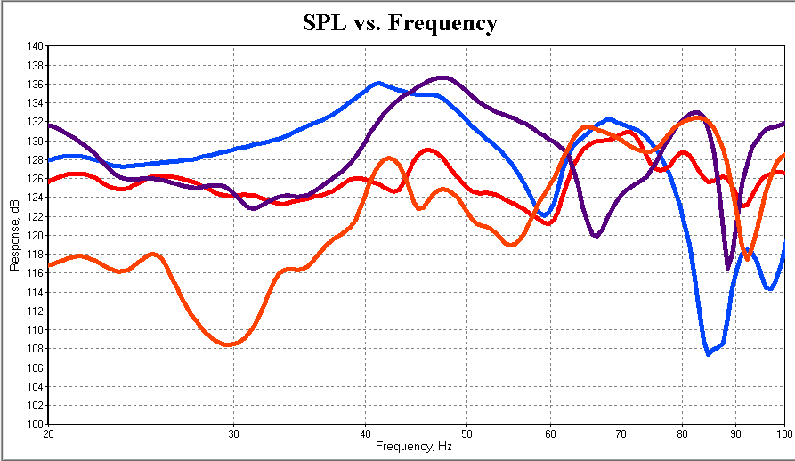

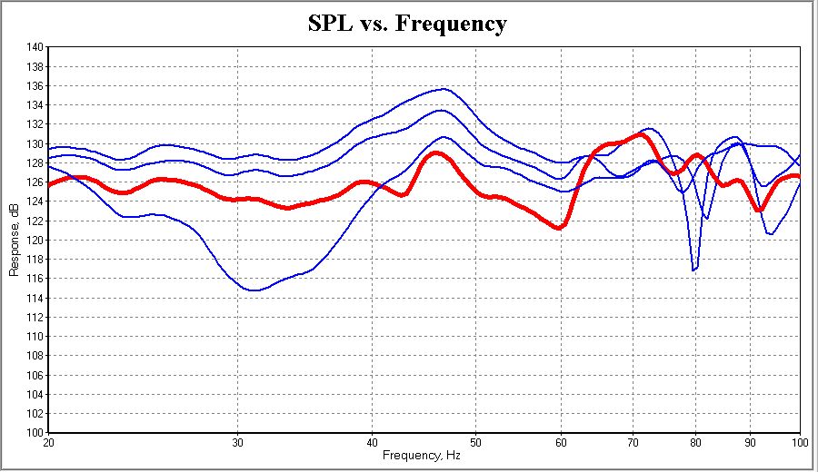

No fun without a good low end, so i re-did the measurements and simulations for the 4 subwoofers.

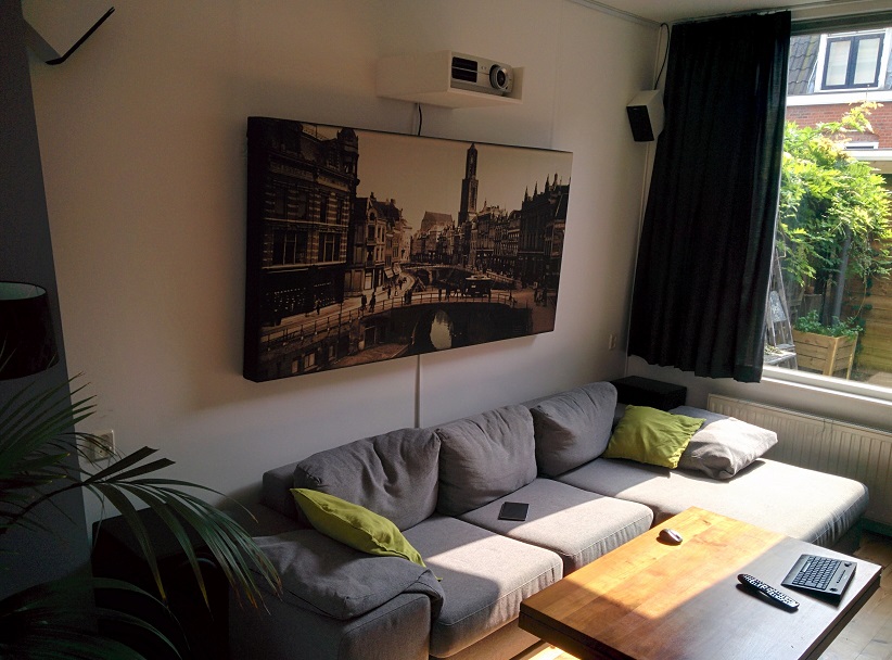

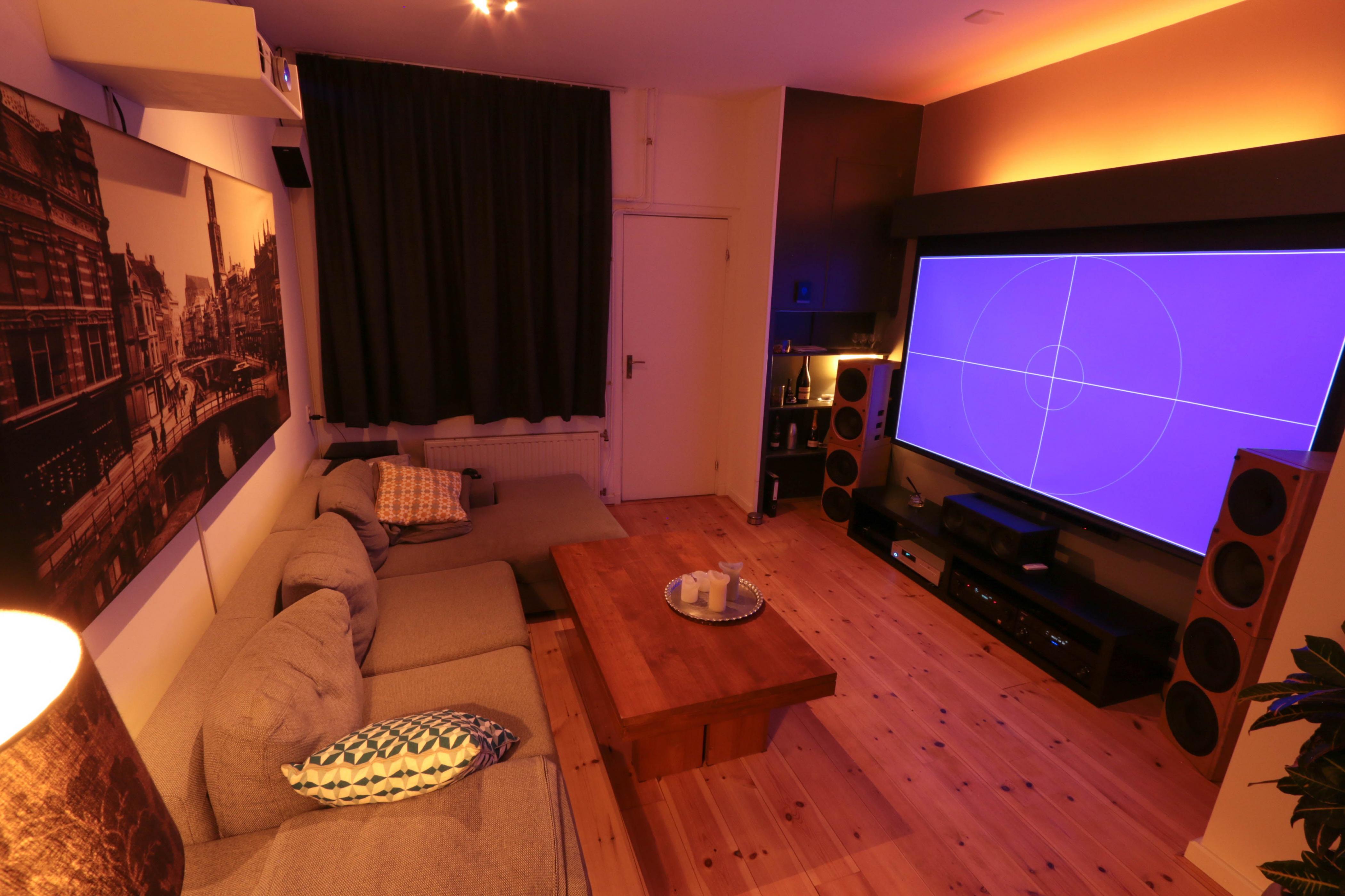

Overview of listening space (old picture, window is replaced by large doors now). 4 subwoofers, each with dual XLS10 drivers in sealed box. One beneath each topspeaker and one on each side of the couch.
Individual responses of the four (identical) subwoofers at the main listening position; huge variation 🙂
Subwoofer position 2, which the right front one, is quite flat. But when you look at the variation in response at the other 3 listening positions, you notice a +/-6dB level difference.
This after running MSO, much better!

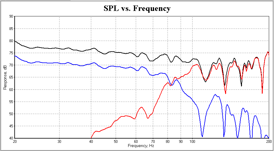

And closeup of integration of mains and subs

Impressive result!No fun without a good low end, so i re-did the measurements and simulations for the 4 subwoofers.

I really should build at least 1 more subwoofer (I have 2 now, FR and FL) and test MSO.
