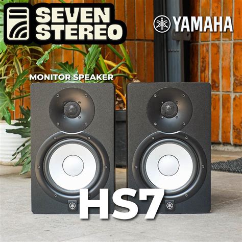

So as said, needs to work close to wall/in bookshelf firing straight out (no toe in), max volume is around 12 lites ( replacing Yamaha HS7 so similar size) and ideally does not need a subwoofer. Will be driven by Naim Atom / Nad M10 / Lyngdorf TDAI1120 / Eversolo DPM-A6 + F2 or similar, used for both music and TV in UK lounge (20ft x 12ft with 8.5ft ceiling firing across the short axis). And budget similar to the 2 Ways listed which is about £750-1000 for drivers and crossovers.
I know the requirements are a compromise but any suggestions on a full range (with shaping filter?) speaker that can do this would be greatly appreciated. Thanks in advance.
Yamaha HS7

The Ascilab C6B is a fully finished product, and a couple of inches taller than the Yamaha HS7.
