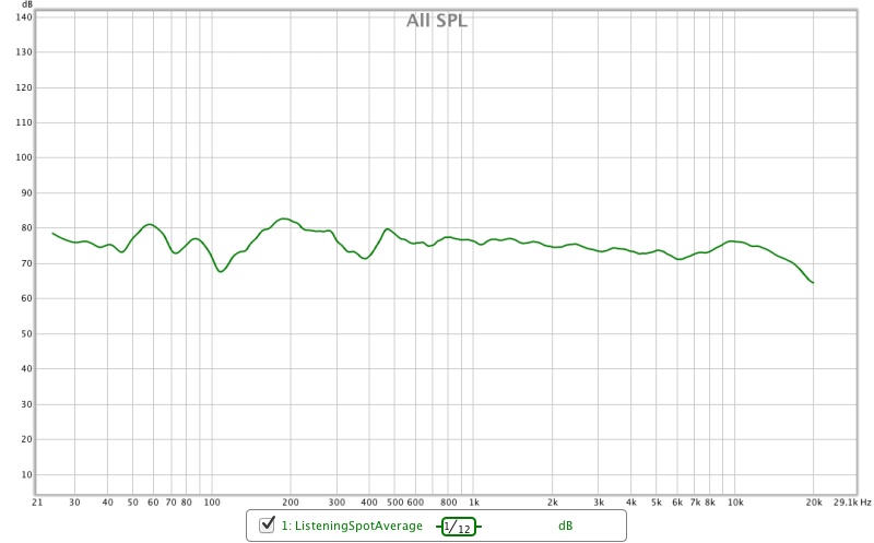

Here is the latest SPL response from my listening point, which is about 530cm's away from the drivers acoustic centres. It is 1/12 smoothed
I forgot to add, I also set the crossover of my tapped horn to 30hz with 18db/oct. It was at 60hz before, but now the upper bass horn and the Tad bass boxes are set and better adjusted, I do not need it to work up to there. This seems like an overkill but it really makes a difference, it changes the general feeling and creates a stronger foundation.

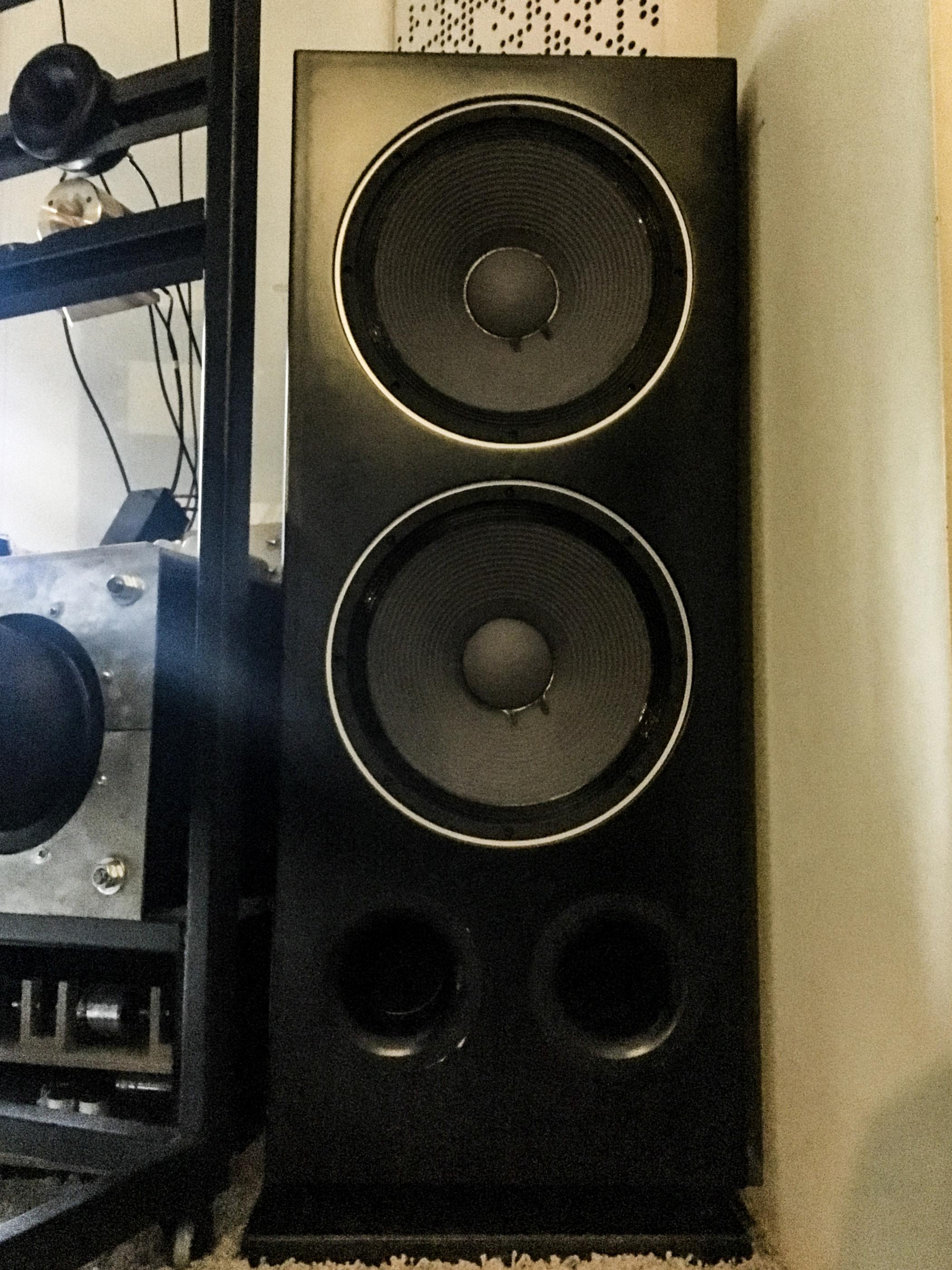

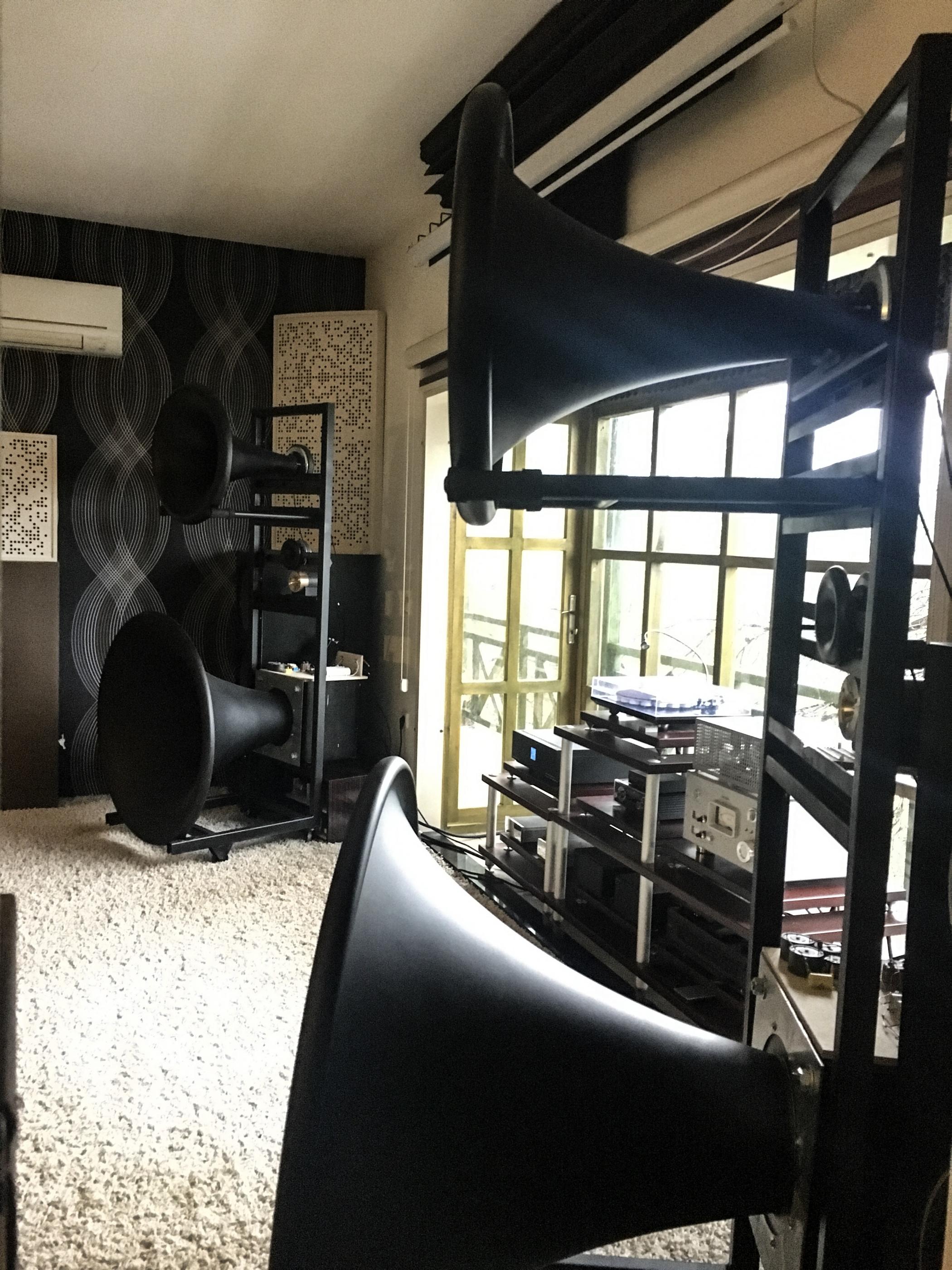

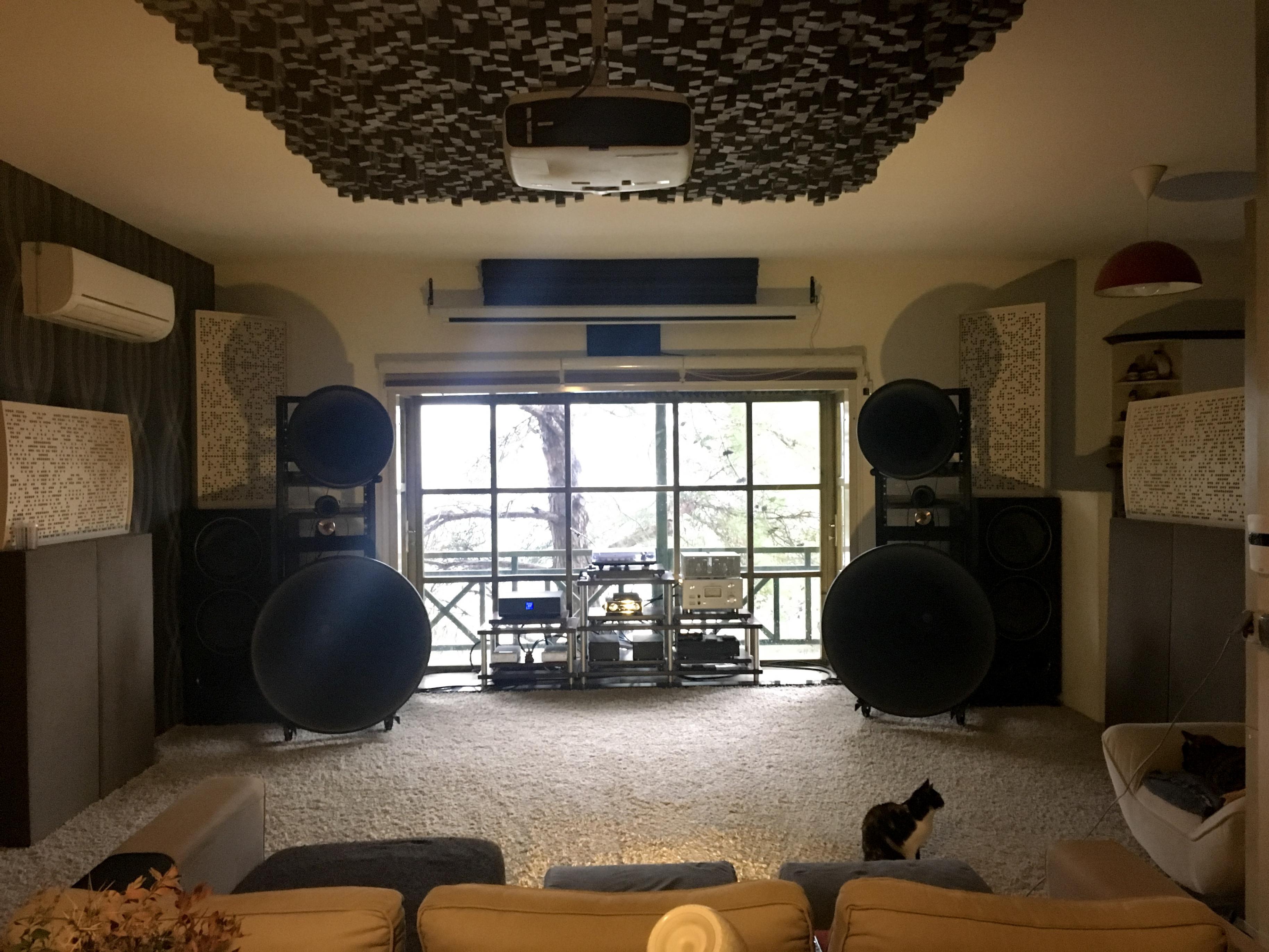

I can finally declare I have finished building my speakers 🙂 Well, at least technically, further than this will be all about aesthetics and different trials to learn new things...
The final things I was waiting to do were, putting the granite bases under the bass reflex woofer boxes, spiking the br boxes, and putting the rockwool covered with felt opposite the drivers in them. Now that I finished that, the incredible spacious sound of the system extended down to lowest bass too. I am very very satisfied!
ps. My plans for the next months will be trying a JMLC 270 horn, instead of tractrix 200 horn to hear the difference of representation. I may change the 110hz horn to wood with the help of my Iranian friend Arash which can only better this insanely good response from upperbass horn. I am designing a static frame which is more aesthetically pleasing.
If I do these, and succeed in keeping the sound as good as now or even better, I will have close enough material to build another pair, except for the crossovers and the tweeters. I plan on trying a raal lazy ribbon for that pair and hopefully sell it and finance more diy projects. I was already approached by people to sell them my system but I have told them I am not finished and it is my prototype.
