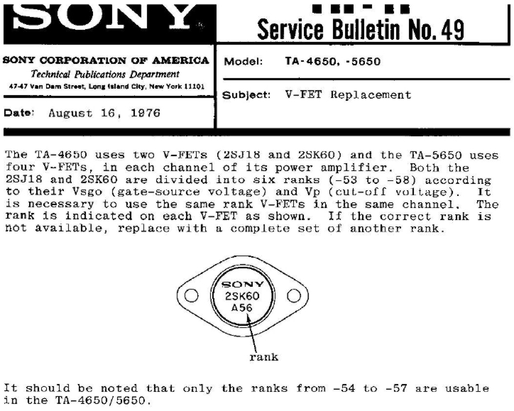

if one failed ,other one will also get damaged. Please be care full if you plan to go for repair. 4650 power supply have some issues. Most vfet failures are due to power supply issues. Modifications are required

Hi Arthur,
Sorry for late reply. No 57 rank devices. Rank 52,53,55,56,34,35,36,26,28 are available.Some of them are used.

I have 2SJ18 j54 rank and 2SK60 jh55 rank.
