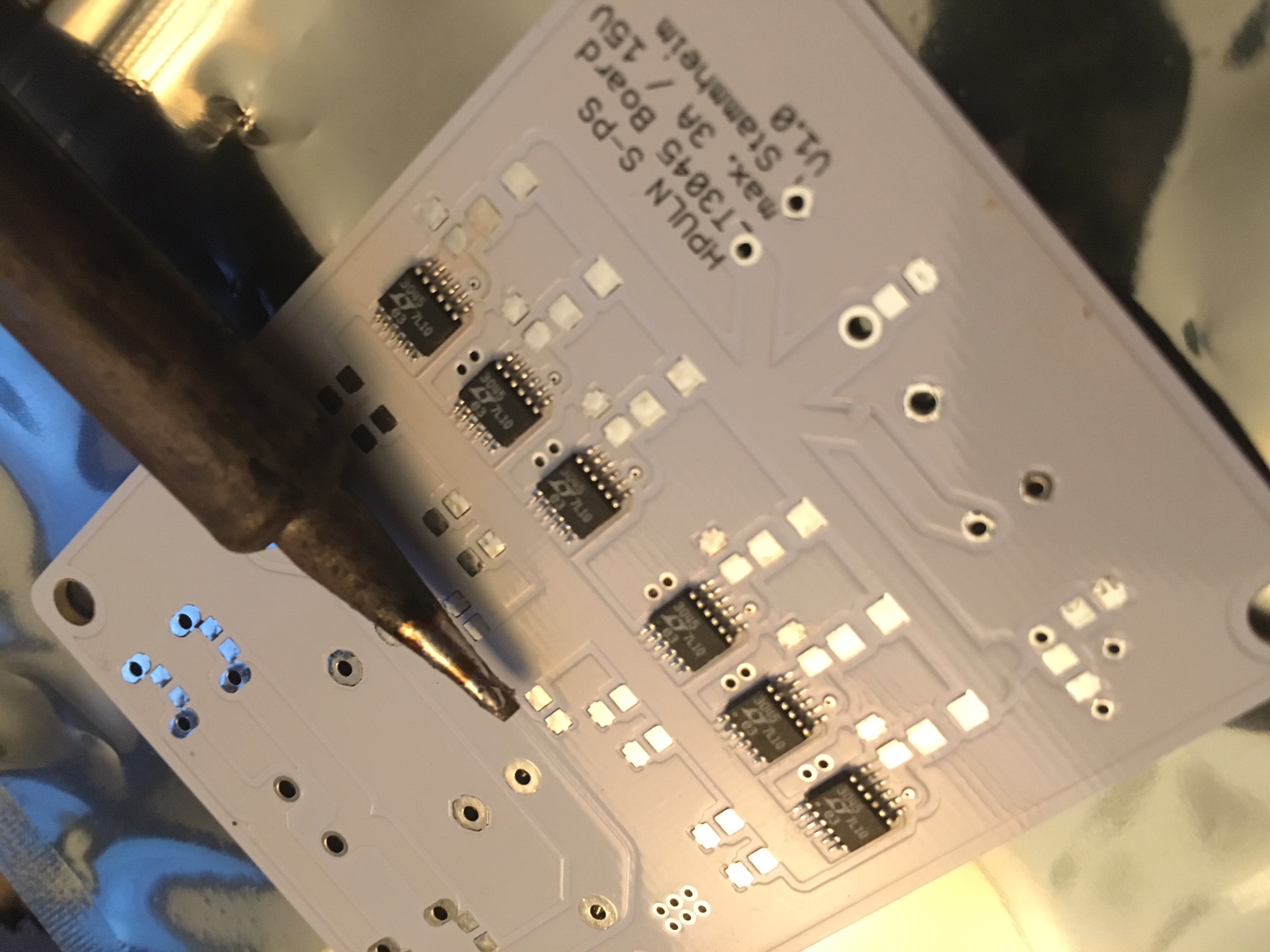

SMT soldering and your third double expresso of the day don't mix. Luckily after a couple of pints in the pub I was in tip-top soldering mode... ;-)
The good looking side
The business side
She's rock solid, and by using rectifiers with a bit more froward drop I've managed to keep the heat pretty low as well. My dac never sounded better.
My first steps...
Hmmm... iPhone's orientation is a bit funny...

"SMT soldering and your third double expresso of the day don't mix. Luckily after a couple of pints in the pub I was in tip-top soldering mode... ;-)"
Good work!!!
Which diodes do you choose? And why?
Congrats to you new users building up the ps by your own! Have fun with it!!!
