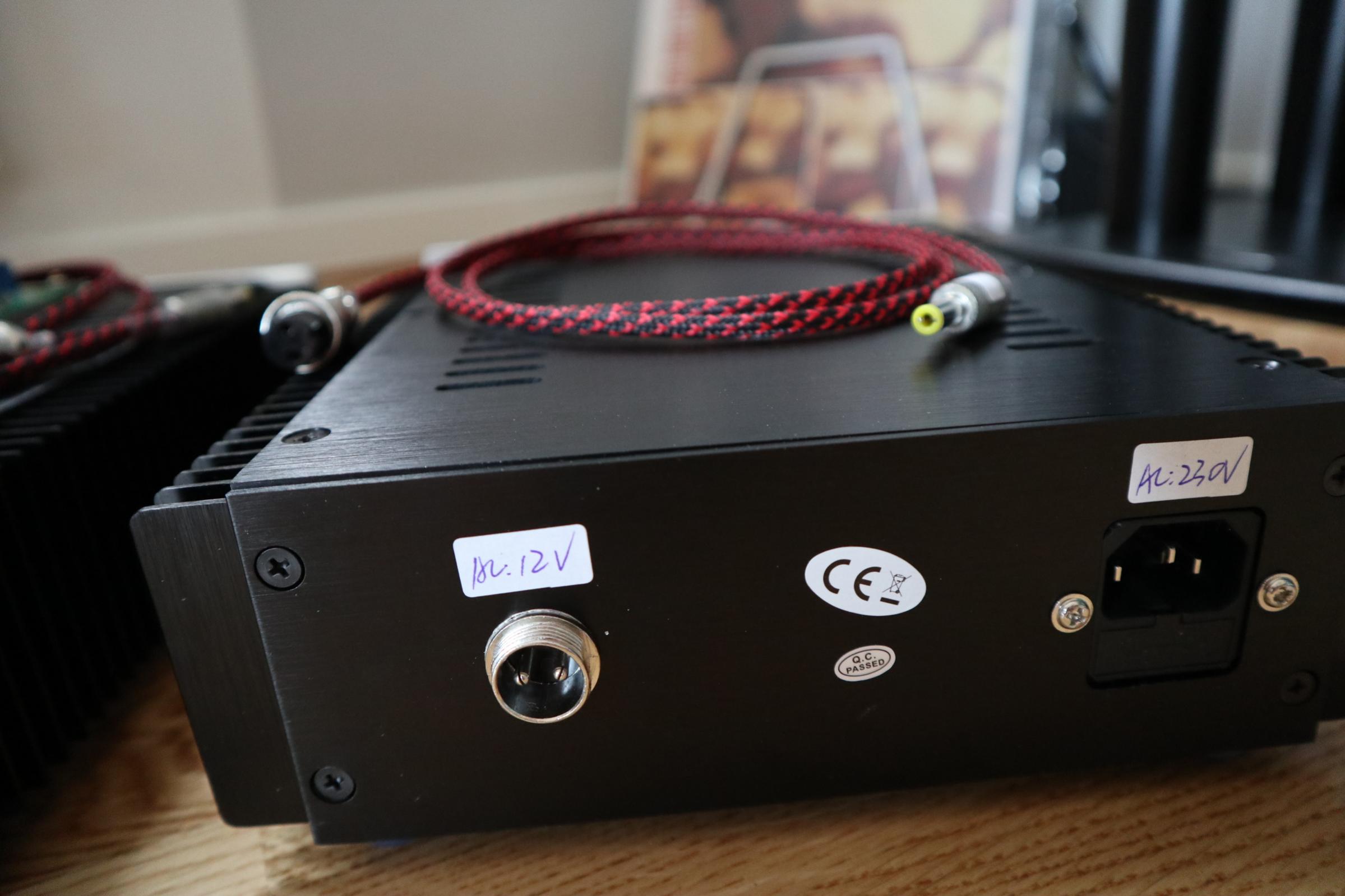

No, the rectifiers is not needed with Gophert, but I want to keep mine versitail to be able to compare Gophert to the 12VAC balanced isolated ps that actually arrived on my doorstep today! :)
