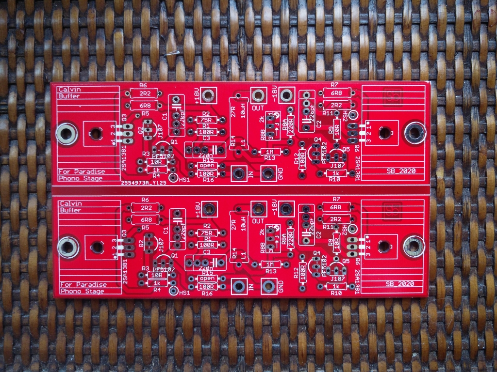

Calvin PCB arrived. Don't know if I'll be able to find enough envellop for shipping, all stores are closed for the next two weeks. If I'm lucky there are some at the drug store... So let me a few days to start shipping.
