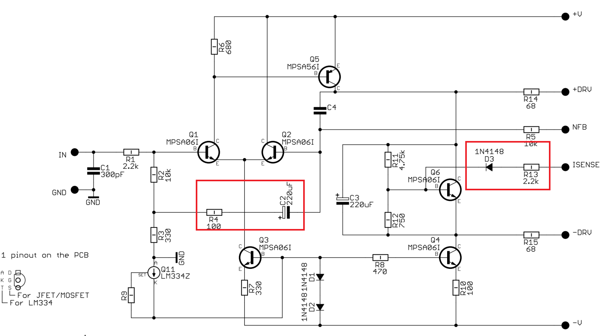

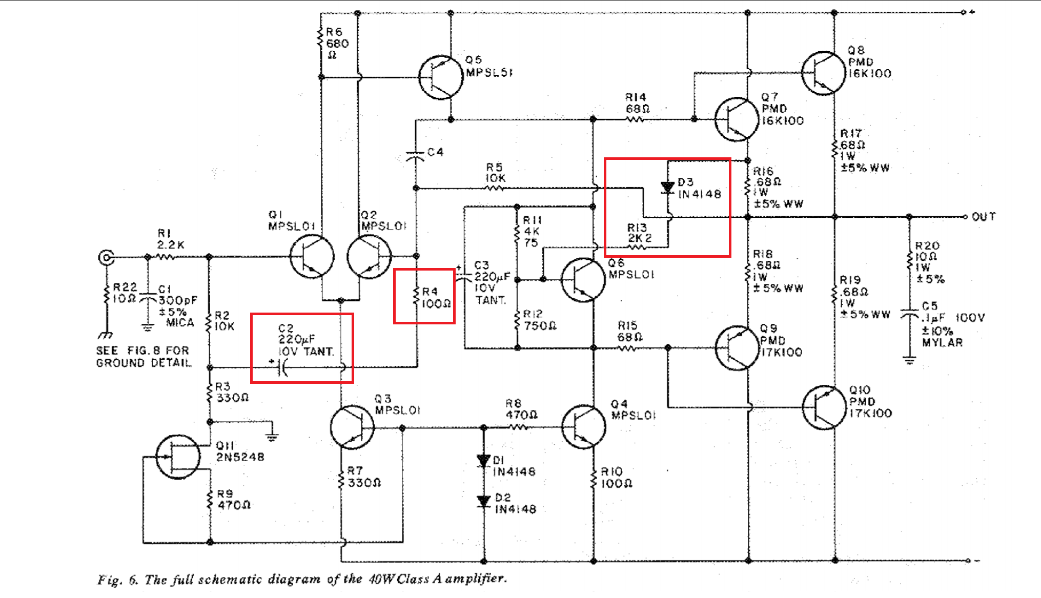

I attached NP's orig A40 schematic, and your schematic. The position of C2/R4 and R13/D3 on the original is reversed on yours. Just curious as to why this was done, and i'm assuming its ok?

The order of components connected in series doesn't matter.
On NP's schematic, the order is different from that on NP's PCB. My PCB closely follows NP's PCB, but my schematic and the board are in sync, so the order on my schematic is different from that on NP's schematic.
Again, this does not matter from the electrical standpoint.
