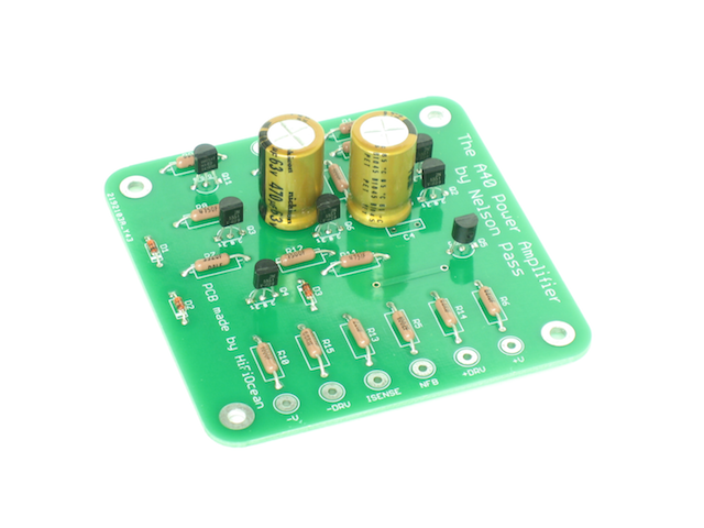

Alex, some questions for you.
1. You mention you have added a Zobel network as can be seen on the pcb artwork in post #13, C5 is 0.1uF but I cant read what value/rating the resistor is shown as R16 (Note, R16 on original schematic is an emitter resistor for output transistor Q7)
2. In post #17 you show a photo of the pcb, but the Zobel network components are not on that pcb - so I am assuming that is not the latest correct photo.
3. Also the Zobel network components are not on the Mouser project as far as I can see that you linked.

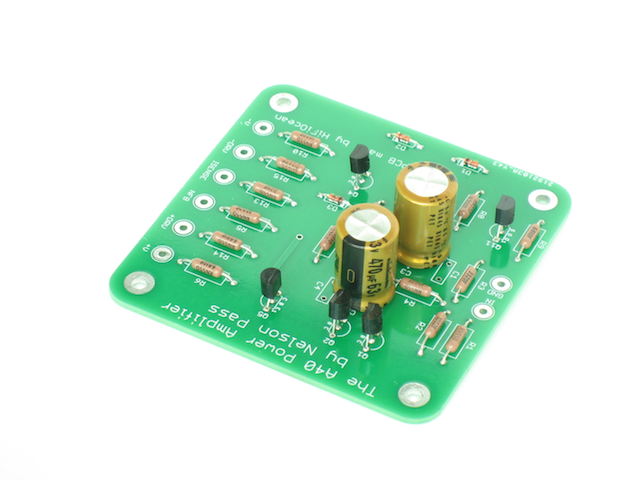

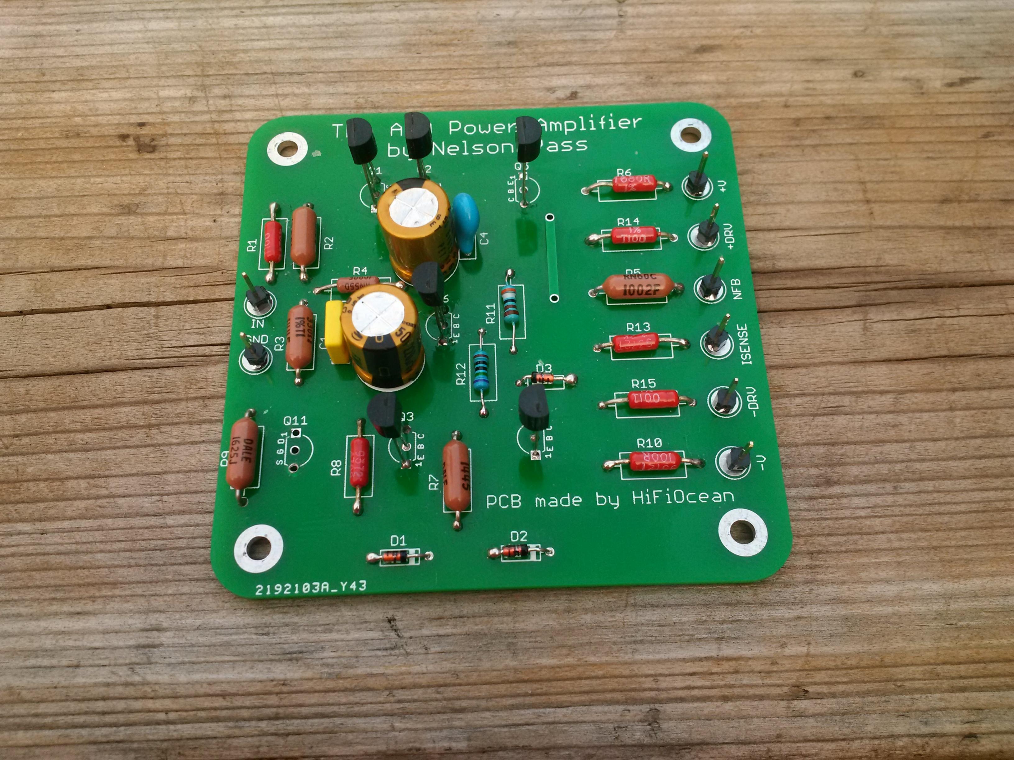

Gary,
Apologies for confusion here. The new boards have no Zobel network, as it was not implemented on the Nelson Pass’ board design as per the original article. The photos in post #17 are correct.
The confusion stems from the fact that my original boards, made years ago and shown in the photos attached to post #1, did have the zobel network implemented (R16/C5 on the silkscreen; should have been R20/C5). The motivation was that the board for the A75 has it, and there was some space available. For the new board, however, I reverted to the original design.
The shared project at Mouser has the resistor for the zobel network (R20, 10ohm 1W), but it seems the capacitor (C5, 0.1uF 100V) has vanished from the list. Sorry about this; I will update the project.

Hi Alex,
Thanks for clearing up the confusion on my questions. One can always add the Zobel network off the pcb.
Did you implement the Zobel network in your latest A40 build or leave it out?
Gary..
Gary..

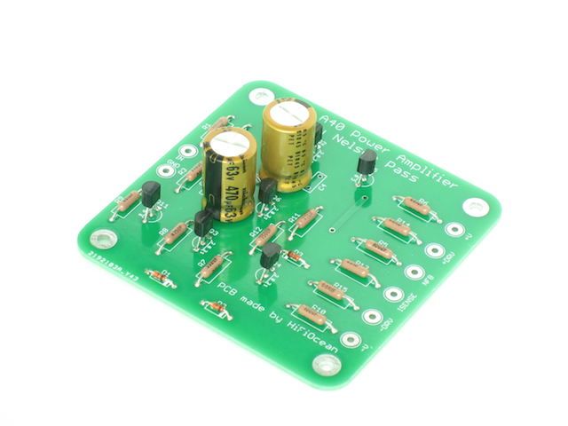

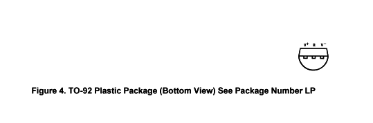

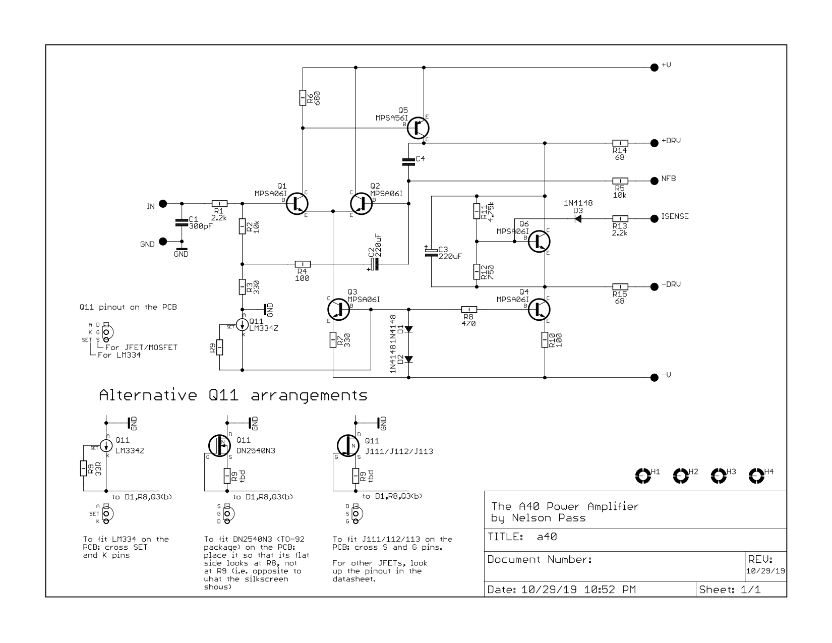

Q11 pinout error in post #20 schematic
I spotted an error in my schematic in post #20 above - the LM334 current source is connected incorrectly. I am sorry I did not spot this one earlier.
In the schematic from post #20, the junction of D1, R8 and the base of Q3 is connected to the adjustment pin of LM334. It should be connected to the V- terminal - see the attached pictures. Because of that, when using LM334 as Q11 with the PCB, its adjustment pin and V- pin must be crossed. I apologize for this.
The markings "D G S" on the PCB are correct, and if you use a JFET or a depletion mode MOSFET as the current source, you can plug it in according to those markings.
On a positive note, you can use DN2540 depletion mode MOSFET in TO-92 package as Q11 on the PCB. Its pinout is "S G D", so it goes into the PCB with the flat side towards R8, not R9. I will post photos over the next couple of days.
Hi Alex,
Thanks for the correction here on Q11, you should correct the schematic with a revision # and repost that, referencing your post above and photo's so there in no ongoing confusion.
Gary..
Gary..
Thank you Gary for the suggestion. Here it is:
This schematic corrects the error described in the post #26 above and replaces the schematic attached to post #20.
It also adds information on using LM334, DN2540N3, and J111/112/113 in place of Q11. Note that using a MOSFET or JFET as Q11, you need to determine the value of R9 experimentally, so that it sets the current thorough Q11 at 2..3mA.
That was quick Alex, your revised schematic should be handy for all with those options.
Any clues as to what value to start with for R9 using the LM334 - I assume your testing will have you settled on a value - or are you still testing late at night there?
Unlike FETs, LM334 is predictable, and for it R9 can be calculated using the formula from the datasheet. The formula gives about 22ohm for 3mA and 33ohm for 2mA. I will test it IRL and report.

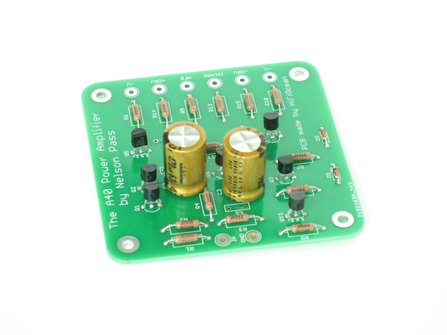

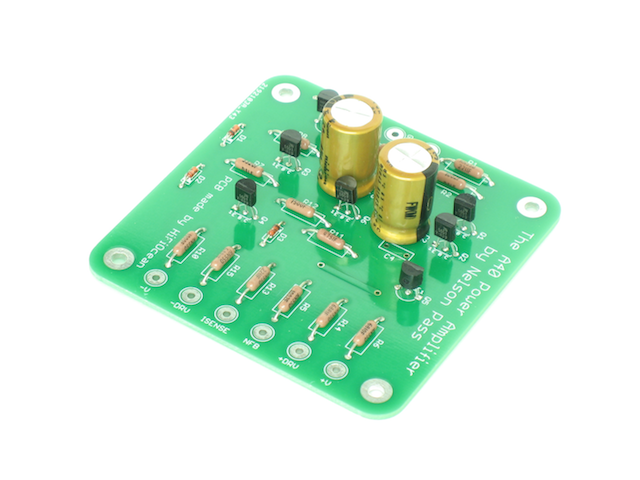

Example build
This is an example build of the A40 front end with 2N5551/2N5401 bipolar transistors, a DN2540 as Q11 (R9=680ohm, I(D1,D2)=2mA), RN55 resistors, Nichicon FW capacitors. Tested so far without the output stage ("NFB" connected to "-DRV" to close the feedback loop).

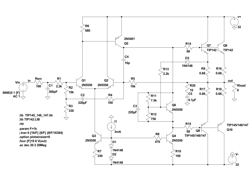

LTSpice simulation of the A40
Attached is an LTSpice simulation of the A40 amplifier. The models for the output Darlingtons are from ONSemi, everything else comes with LTSpice. R11 had to be adjusted to keep the quiescent current of the output stage at approx. 1.5A as per the original article.
LTSpice can be downloaded from Analog Devices.
Awesome for sharing that, I really appreciate it. I love running a build through SPICE before assembly. Very good learning when these things combine...Attached is an LTSpice simulation of the A40 amplifier.

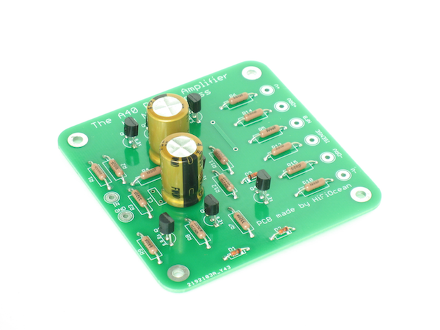

As stated in the A40 part substitution article, you can use a 10kOhm or so resistor instead of Q11. The amp will have more noise but otherwise will work the same.
You can substitute this part with a convention N channel JFET which has been tested to act as a current source in the circuit with R9. The value of R9 has been chosen so that the JFET passes about 3 mA or so (not critical). You can also substitute in a monolithic constant current source if you can find one, rated at about this current and 40 volts.
If you can’t find any JFET for the current source, or are impatient while waiting for one to arrive, you can simply use a resistor as a poor man’s current source by putting a 10 Kohm resistor where the JFET goes, connecting between R9 and ground. This will work, but is noisier that a constant current source. This can be improved with an electrolytic capacitor (say 100 uf @ 50V) between the negative rail and the junction between R9 and the 10Kohm resistor, with the positive pin of the capacitor between R9 and the 10K resistor.

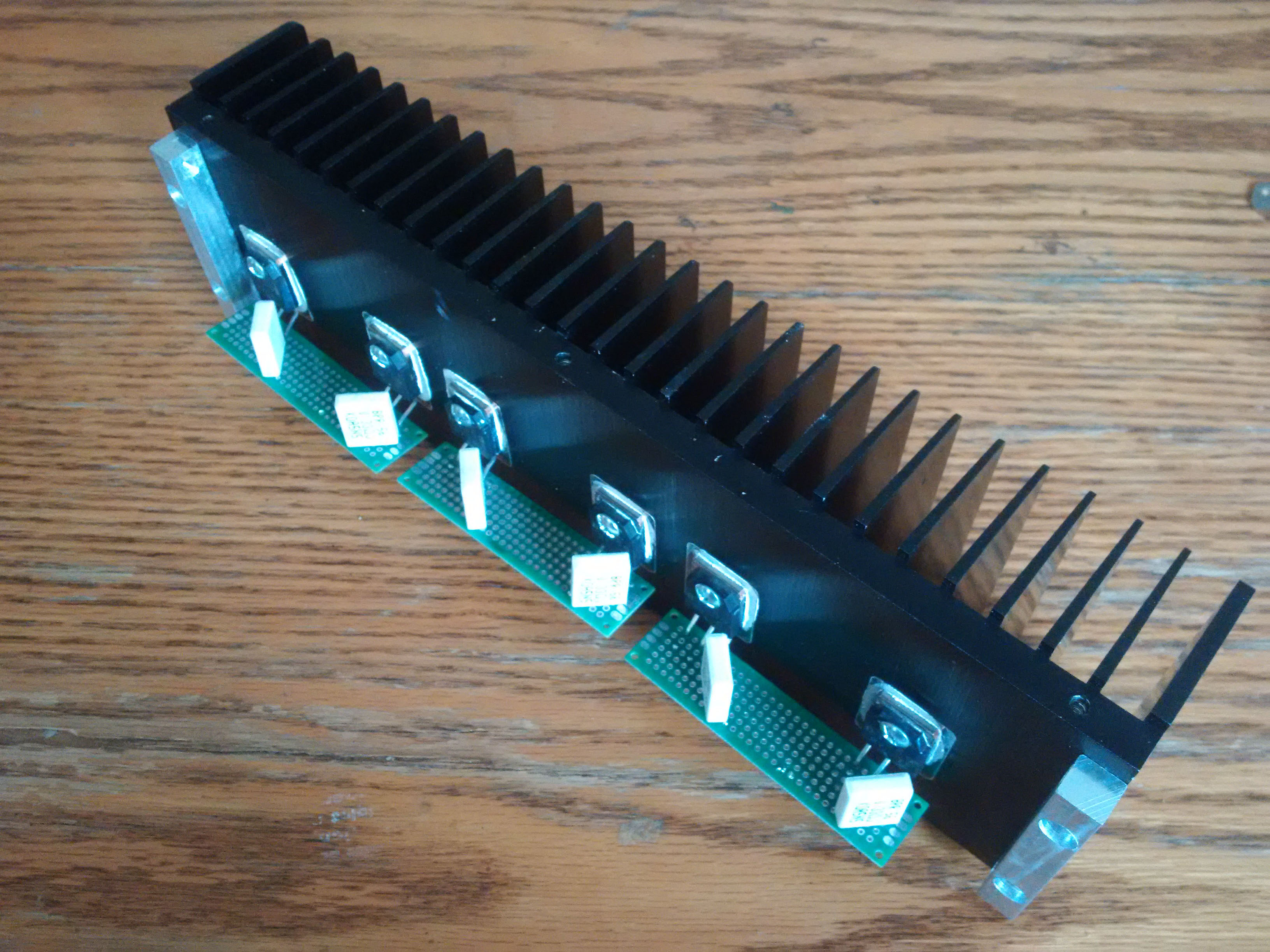

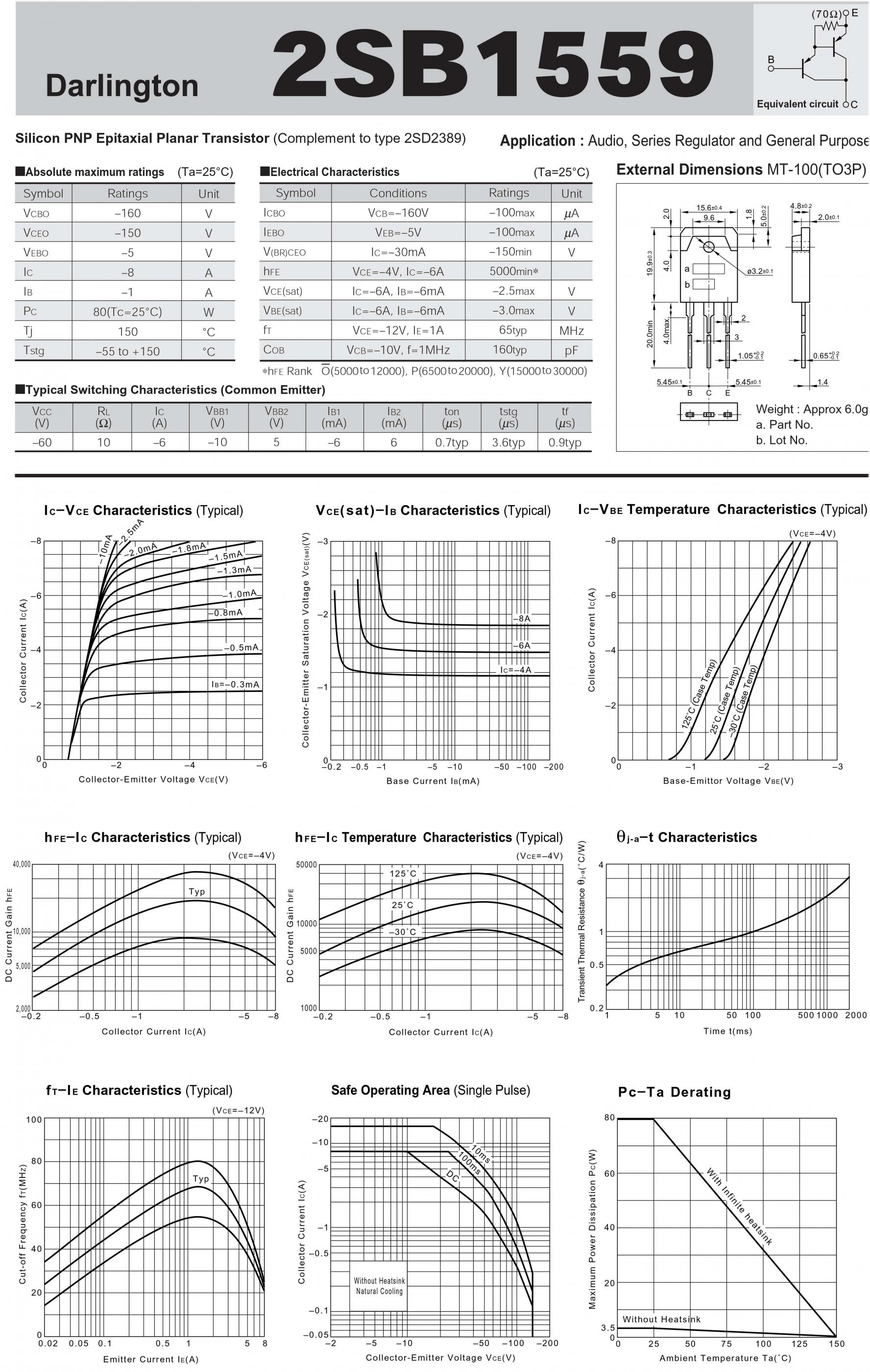

Here is one channel of Sanken 2SD2389 x 3pcs and 2SB1559 x 3pcs. Gonna run it on +/_25 VDC rails. I'm kind of stuck at home so I guess I will build this thing. I forgot to tap the holes for the thermal cut off when I was machining the threads for the darlingtons, I'll do that tomorrow when I go to work on the other heatsink.
I think the Sanken's will be a great match to the A40?

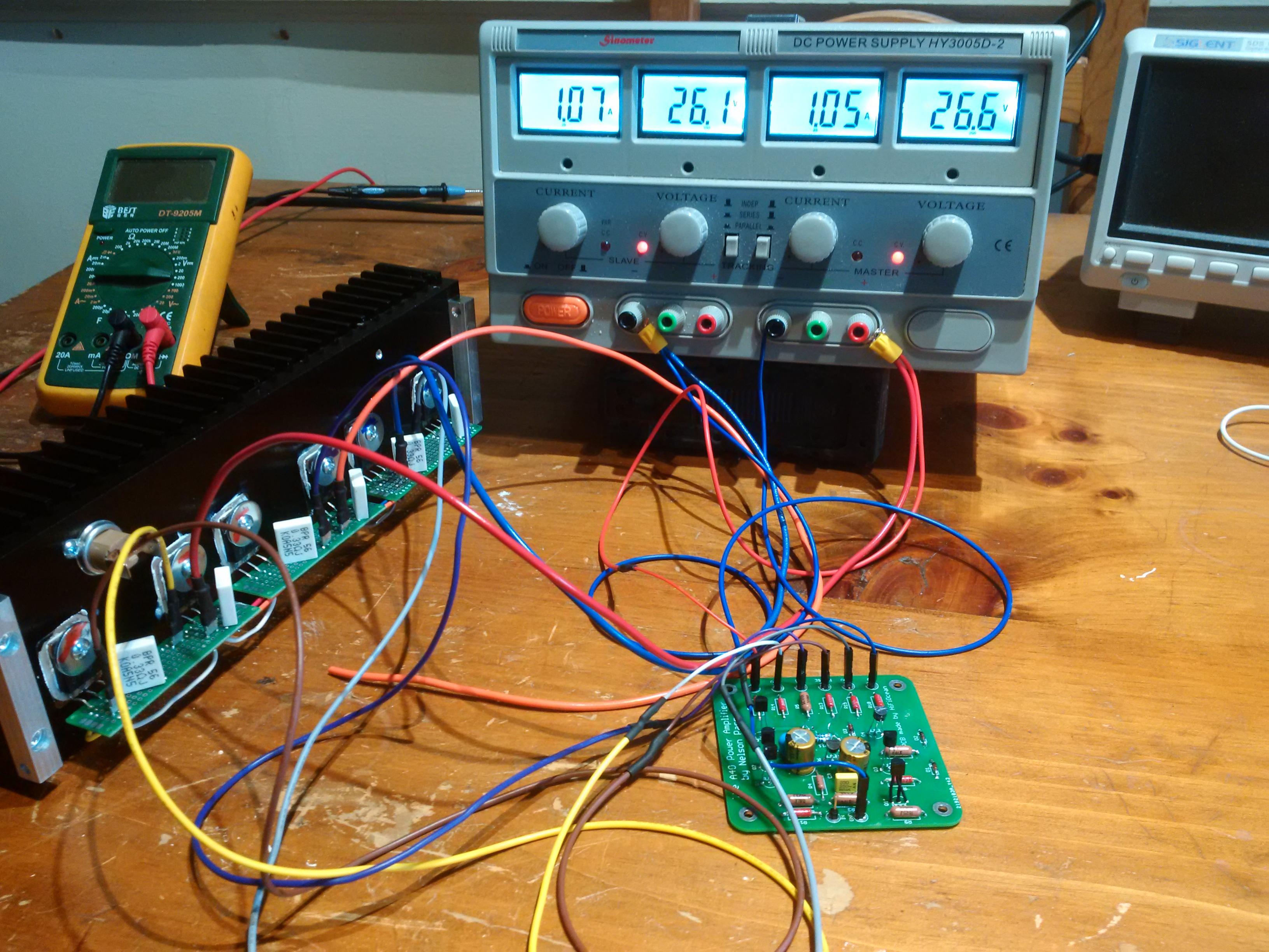

I did end up using J111 for Q11 and adjusted the leads accordingly.
My heatsinks are not massive and considering supply line voltage variations, I settled on a bias of just over 1 amp per rail. Should provide near 30 watts-ish of class A from 27 volt DC rails.
R11 thus became two resistors in parallel to yield 1890 ohms-ish.
Each heatsink is idle at 42°C-ish
When it goes in the case with the actual power supplies, then I can take away the 'ish' factor... and hopefully soon.
When I get it all together, I may put a full description and complete build pictures in the Pass department of DIYAUDIO but I must give one final nod to alexcp. Cheers & thanks.
