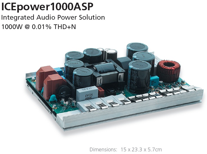

Possible good chassis for making an IcePower Amp?
I just ran into these on a surplus site. If it looks as good as the picture, it should make a nice easy to do chassis for mounting a couple of the ICEPOWER boards. I'm tempted to try one for a preamp, too, but I can't tell whether it would be possible to put knobs on the front.

I bought 7 of those enclosures 3-4 months ago and was planning on using one for this project. It's very nice.

So, how practical would it be to put controls on the front panel with knobs (and still have it look decent, I mean)?
Sorry, I should have read your last post more thoroughly. It wouldn't be difficult at all. The front piece can be remove with 4 screws. My plan was to replace it with a piece of thick aluminum or some nice wood mounted in the same 4 positions. The are a couple of openings in the front panel that could be utilized. I'll try to get some pics posted of the unit with the front plastic panel removed.
Here is what the inside of the surplus chassis looks like after 15 minutes of stipping. It's a very very nice little chassis.
The front panel attaches with 6 screws and would be very easily swapped.
