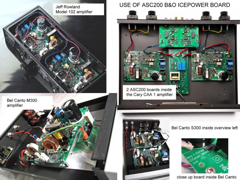

use of ASC200 boards in US made amplifiers
The ASC200 board is used in the following US amde amplifiers:
Jeff Rowland Model 102 - 2 boards
Cary Audio CAA1 - 2 boards
Bel Canto - M300 - 1 board
Bel Canto - S300 - 2 boards
I included a compilation photo with some insde overviews of the above mentioned amps.

The PCBs have a cap and a resistor connected to the center hole. I suppose that is the one that can be connected to safety earth/ground. However, one of those parts is shorted with a jumper.
BTW Wim, Dan Fraser probably is a good engineer but connecting the (signal) ground of audio electronics wit zero Ohm to a case which is connected to safety ground/earth is not good engineering. That is if I understood correctly what he does. RF can creep in that way and so it can pollute (signal) ground. That is one of the reasons a resistor and cap in parallel are used most of the time.
Does anyone know what the solder blobs on the PCB are ? I guess they are for offset trimming ?!
I'm not sure I understand this reasoning.
In some industaial amps the resistor / cap combination is supposed to do the opposite.
At LF, the cap is high resistance. This way, the resistor dominates, providing some reference, but not enough to cause LF ground loops or mains frequency humming.
At RF, the cap is virtually shortening the resistor (if the cap is good), thereby connecting the signal ground to the enclosure. This gives an effective shielding against radiated RF.
These units are class II supplies, so they need not (not intended to) be connected to safety ground.
