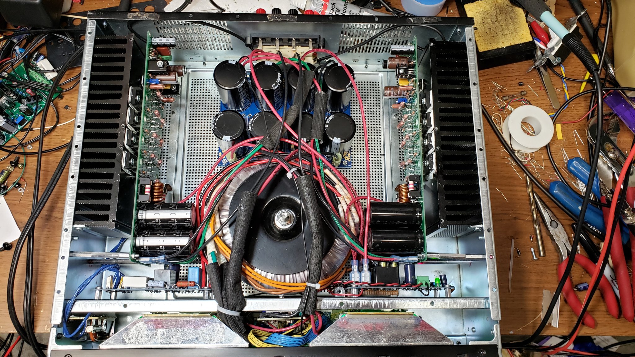

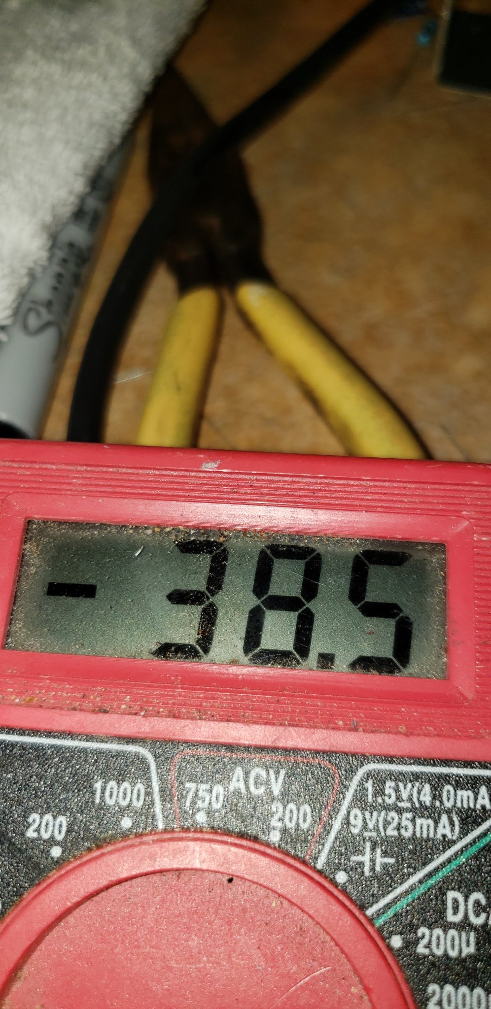

That you see low voltage at speaker output is encouraging, but at same time I'm baffled that output trimmer is unresponsive. That's probably worth exploring/understanding. Would you report output voltage, say at L601 or any similar convenient point, and input-pair base voltages at R615 and R627. That's a first pass at expected feedback behavior around the amp. You should also see +0.6V at TP K and -0.6V at TP L and these voltages should appear across VR601 and at the wiper terminal as the pot is adjusted. There should be nominal gain from pot wiper to the amp output of -(R673/R627) = -0.22 V/V, or about +/- 130mV at output as pot is adjusted stop-to-stop. If isn't the behavior seen, something's amiss and needs to be understood.

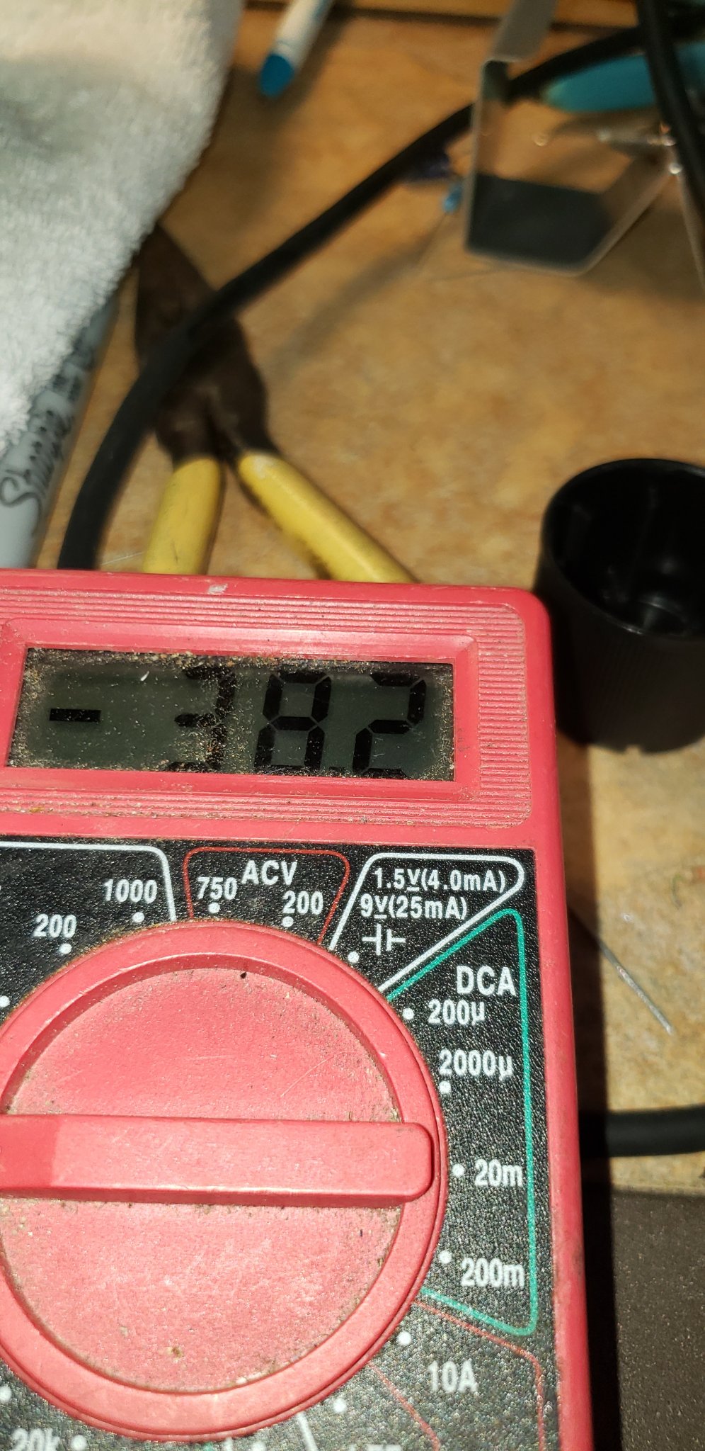

I have 7.6vdc at L601, 7vdc on one side of r615 and r616 and 0vdc on the other legs. I have a cycling 7vdc to 8.4vdc on one leg of R627 and 1vdc on the other leg of R627.I applaud a thorough visual inspection!

I have a fluctuating 5.4-6vdc on one leg of vr601 and 2.2vdc on the other leg.
I hope I'm covering what you need.
Let me know if this seems correct.
Screw it. I just killed it. I had it unplugged and started to touch up solder joint and arc-ed a transistor. Dim bulb shows direct short.

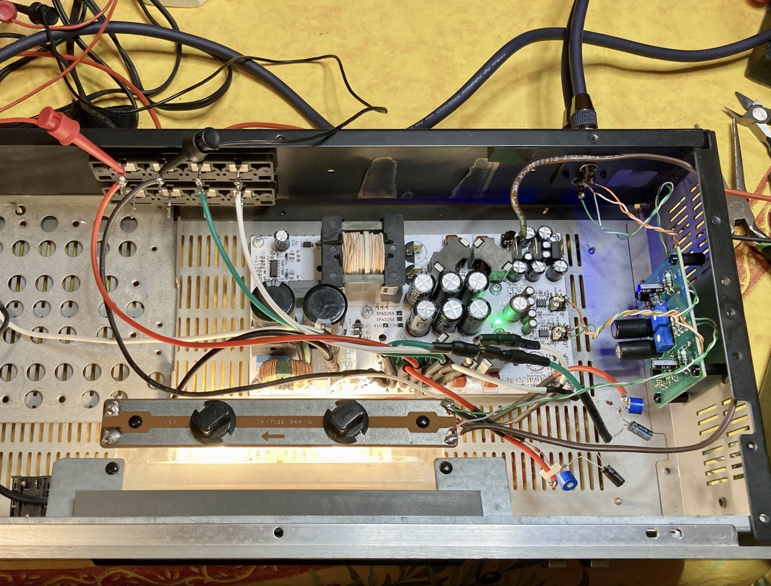

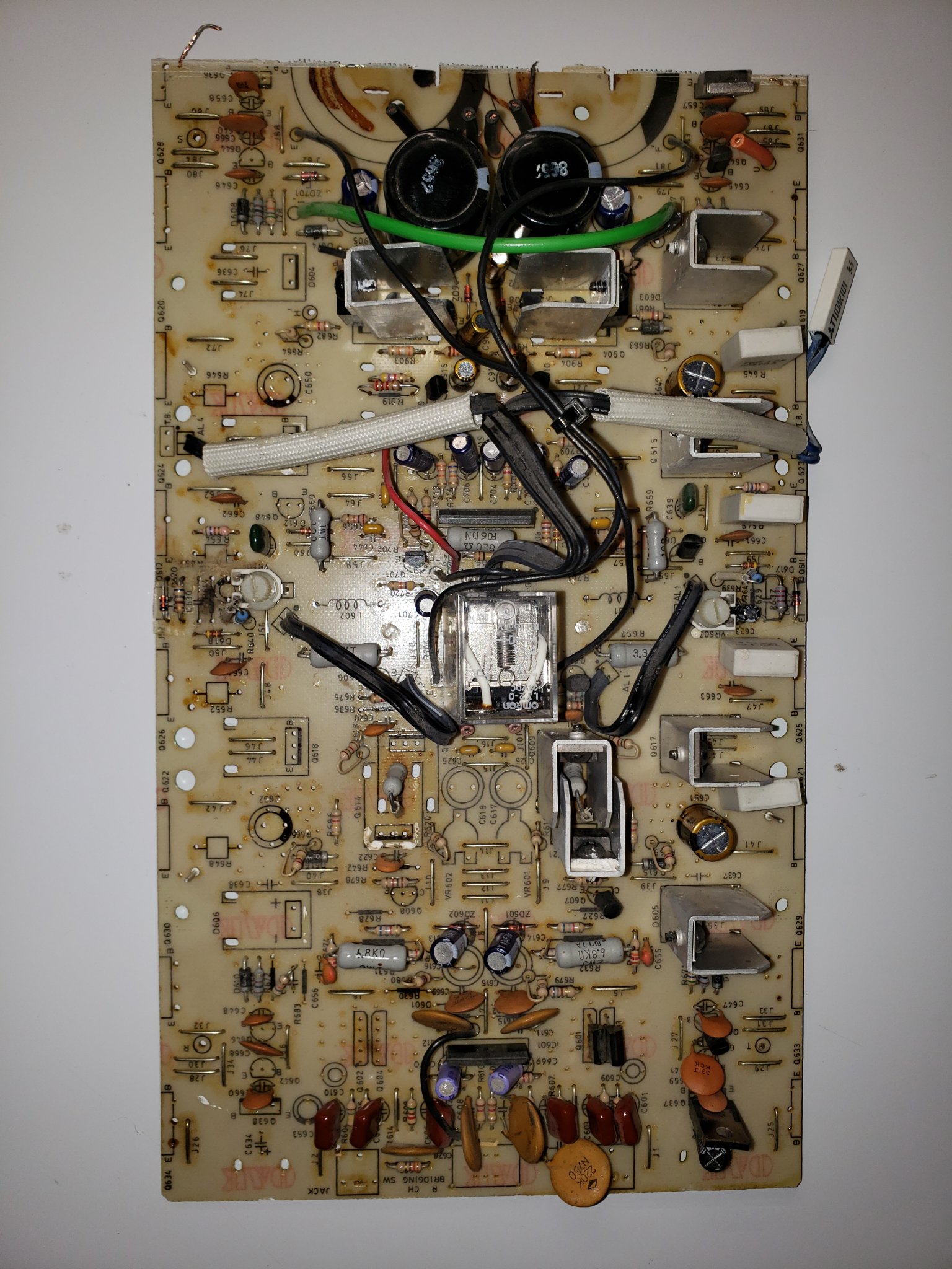

I was just going to ask what would be cut out. Im going to cheat and use 2 mono 1000w Class D amps.I also smoked one of these amps probing trying to set bias. I did rebuild it with AB100 boards off this forum and cut the meter driver portion off the Proton main circuit board at the front and built a small power supply to power the meters. It works perfect.
Can you recall what and where you physically cut and your power supply?

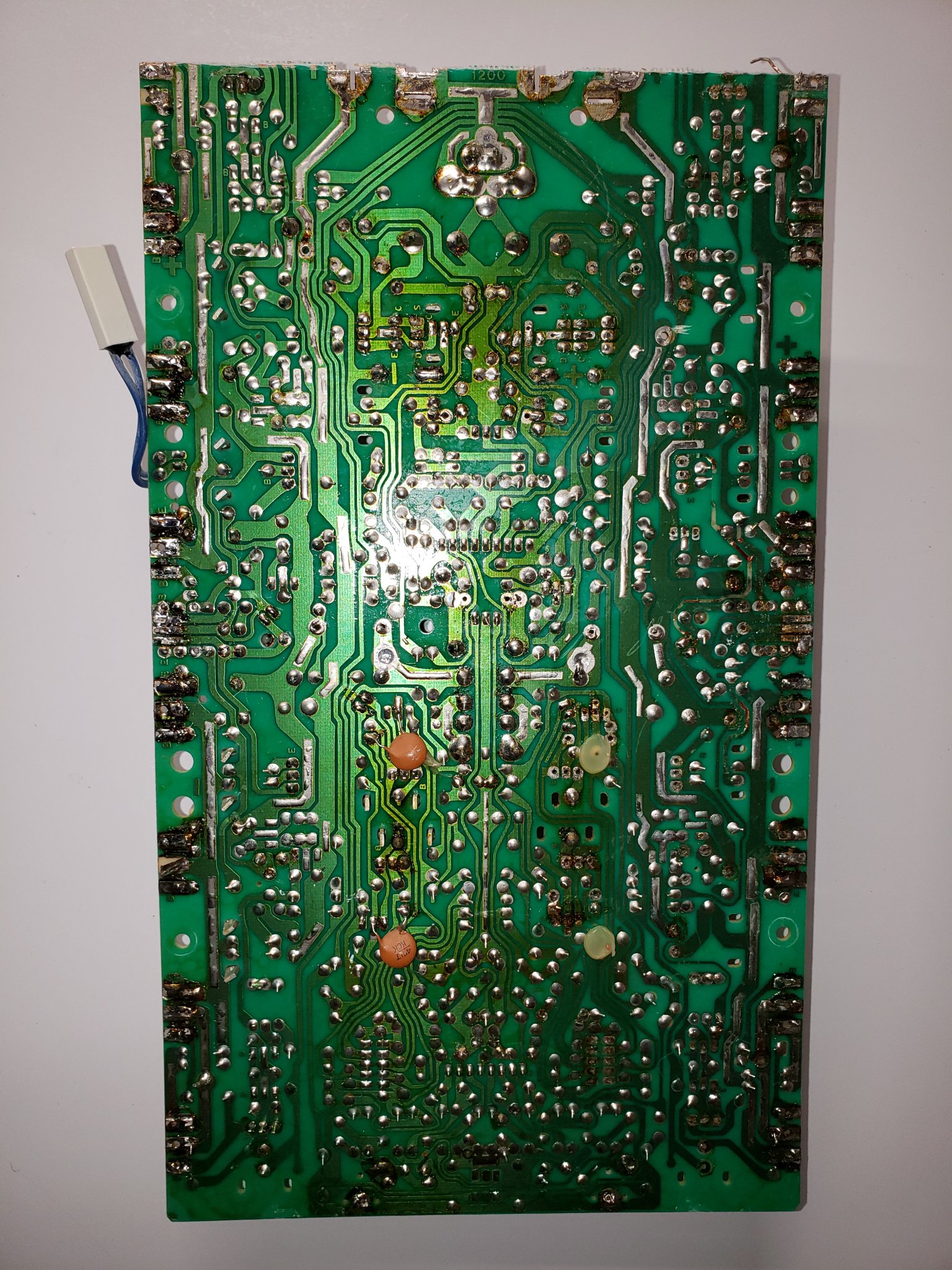

I believe I cut right behind were the screws mount the board on the front cross panel. I've attached pictures of the main board from the top and from the bottom. Also, the end result.
Thanks, I saw that it needs +-14vdc. How did you accomplish that? I suppose 12vdc wouldn't cut it. The amp power supplies have 12v. Then you ran your outputs through the board?The meter board needs +-14VDC.
