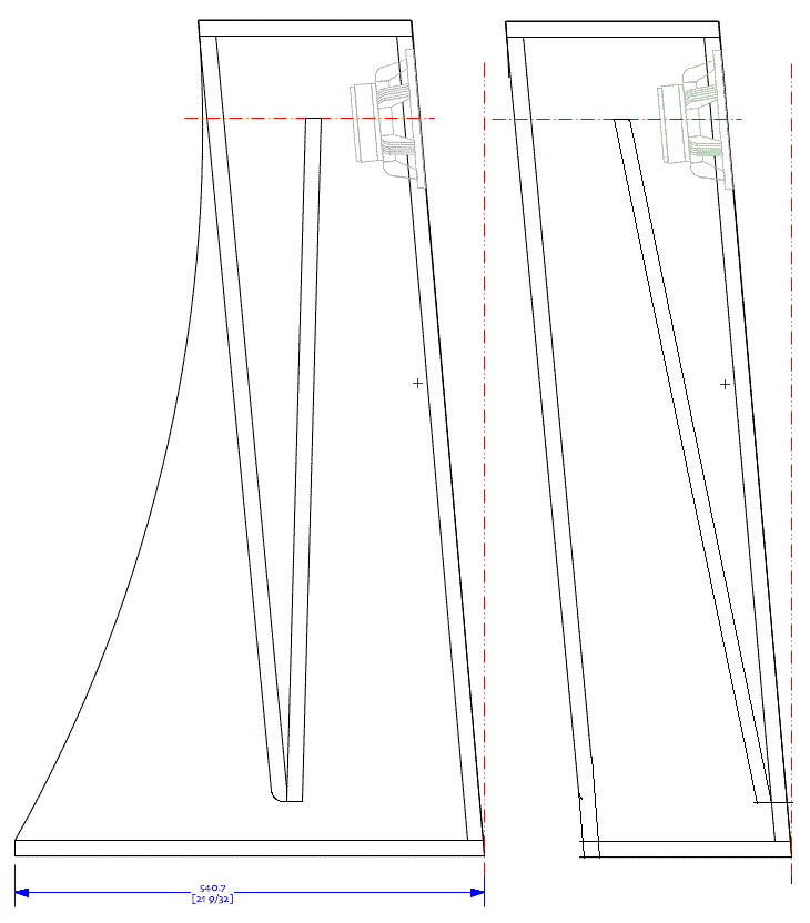

First, I’d like to say congratulations and thank you for the design of those speakers.
I don’t know if this has been already discussed but for space available in my apartment and personal taste reason, I d’like to know if it’s feasible to reverse the central panel so that we have the port at the front of the speakers? This should reduce a lot the footprint of the speakers.
No, you can't do that with this specific enclosure design, and expect it to work. What you've drawn appears to be a TQWT, which is fine if you model it for a specific driver.
If you want a smaller footprint, build a Pensil enclosure. You already have drivers?

As above, no, I'm afraid not. FHXL is a corner horn, it uses room boundaries for proper functionality. There is no 'port', and the curved back is an acoustically functional part of the design. If you need a more compact enclosure, there are a number of alternative options around though.

For aesthetic reason I wanted to have a tilted cabinet (3/5°), do you think it will significantly affect the sound quality if I implement such modification on the design ?
Pensil can be tilted back with few issues.
