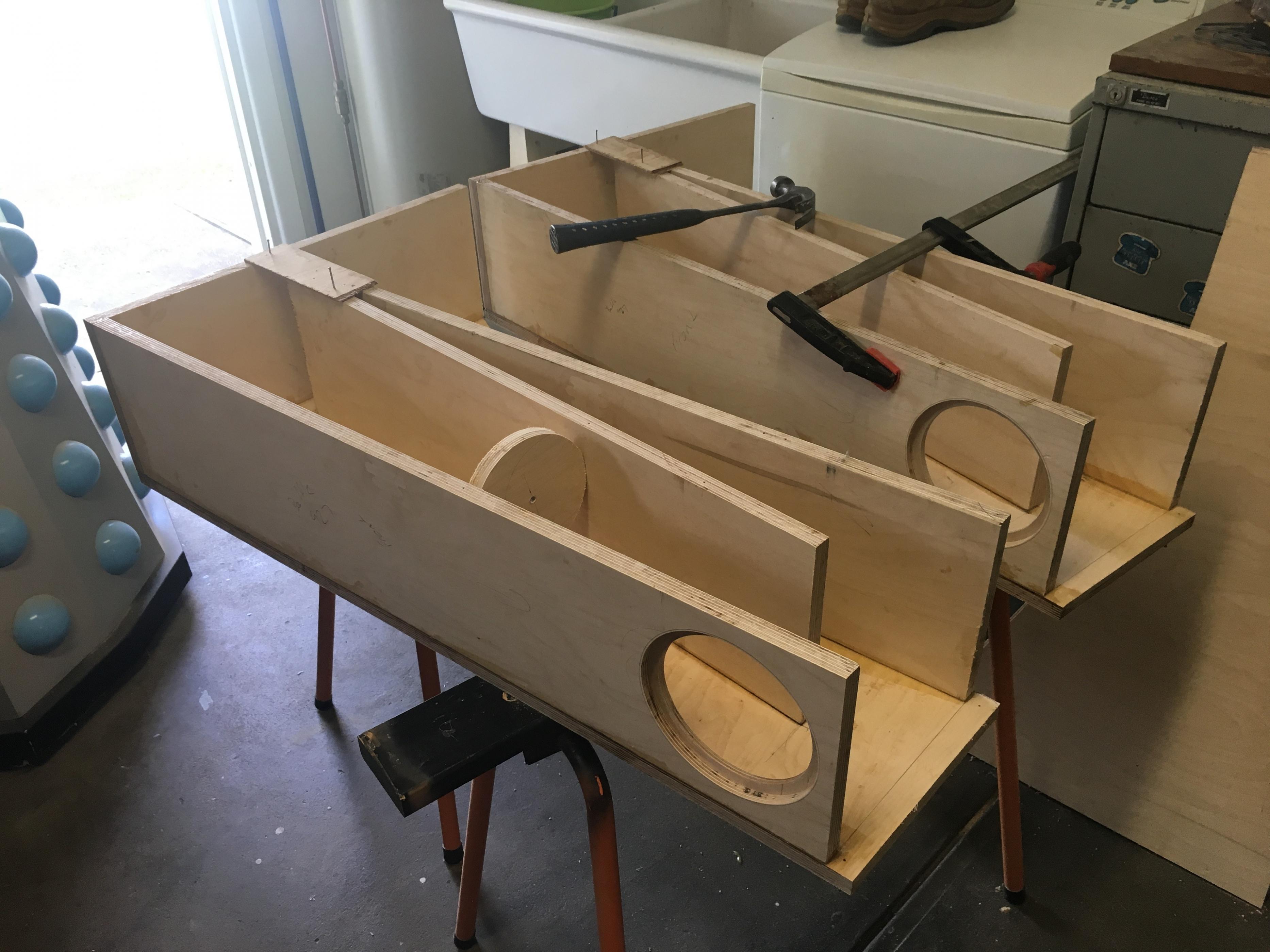

Received the plans thank you. I have cut out my FH-XL from 18mm birch ply and glued in the internal and rear panels. (BTW, I am using West Systems Epoxy as I have a couple of litres on hand from my boat build). I am ready to route out the driver recess, but I don't have the drivers on hand. I am going with 10p because they are in stock over here in Aus. It seems that most don't use the bezels, but the dimensions shown don't give the OD without bezels (unless I am reading it wrong). Is somebody able to enlighten me on the best OD and depth for the recess?
Thanks, Glenn.

Thanks Eric. I totally agree. Problem is this build is kind of like taking out a mortgage to build a house. The money is only released in stages. I can't get the drivers until the cabinets are complete to the satisfaction of the bank... 😉 Here's hoping I made a suitable allowance.
I have one other question. I live in Queensland, Australia and we have little critters called Geckos, which, while quite cute and harmless, like to get inside electrical equipment and cause havoc laying eggs and leaving behind other surprises.
Is it ok to put a screen over the rear port to keep them out? I realise it would have to be a very open weave.
Thanks,
Glenn.
