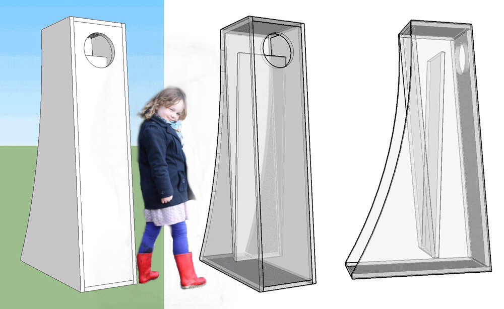

Ok lads, I've done the Maths and a quick mock up. Plans available on request 🙄
Megalithic 🙂

Apologies - the mock up below for the FHXXL 12p is a poor attempt at humor, I do not possess plans. If the Megalith ever gets on paper I'll be in the line with the other crazies looking to build a set 🙂
Megalithic 🙂
It should be noted that Maeshowe, Silbury, Avebury are the Megalith Series (ie that name taken already) 😀
