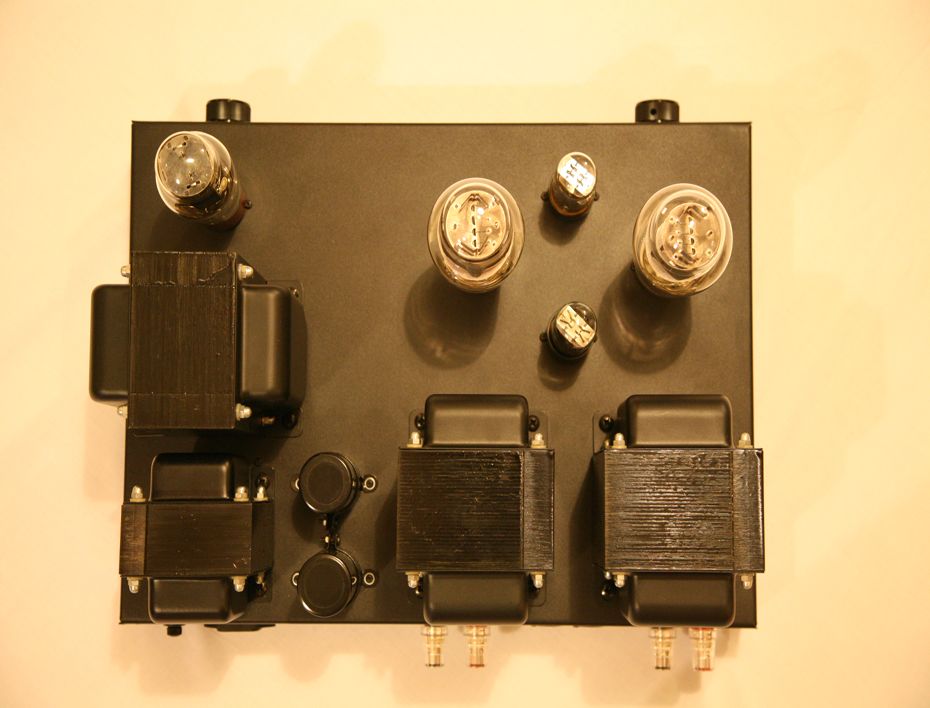

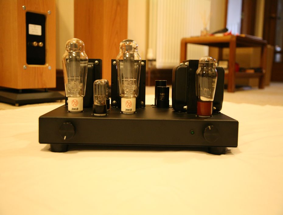

Oh I know, i was a habitual box swapper for years getting up to the dizzy heights of a 30k system! the recession saw me selling everything to pay the bills, so only getting back but having a gret time with "frugal" (excuse the pun) funds.
When i had enough to get started again a hi fi dealer in Scotland ( Musicarch) was making his own 300b SE power amps and i was interested in his experiment. i had a small ( for hi fi) budget and he made me a 1 off 300b SE amp which he stated if this is not better than anything up to 10k i will give you a full refund!! so £2800 later i have yet to own or hear anything as good. he is now in full designing and making mode making 300b monos, 300b Se fixed bias power and a one off no holds barred special 300b power and mono blocks with very very nice trannies. I had some very expensive stuff through my home inc Audio note, Art, Border Patrol, Wavac, Hovland and none sound as good as my amp. his new stuff is supposed to be in another league.
my amp here.( now upgraded and superceded) im ordering a new one next year!)
very simply designed with off the shelf carcass and simple looks but new sold wood designs or CNC machined chassis to follow, im ordering my new amp with solid american black walnut case with stainless steel top and bottom plates and very well made italian potted trannies made to musicarch's spec.
Donald is so infected by these DIY amps he has sunk a lot of money and time with transformer companies getting them the way he wants. His new 300b to of the range have been put against £33k Audio note, and 100K jeff rowland amps and have trounced both with no bother Donald is an AN and JR dealer so has the kit for comparrison.
Great dealer with the best customer interaction i have never seen in my life. He is bringing his new amps over to Northern Ireland for us to play with for a day or two, i for one cant wait. I cant do electrical DIY and this is a great way for me to get it done and get great support and a life time warranty, he even serviced our amp for free collecting and delivering each one in person at great cost to him.

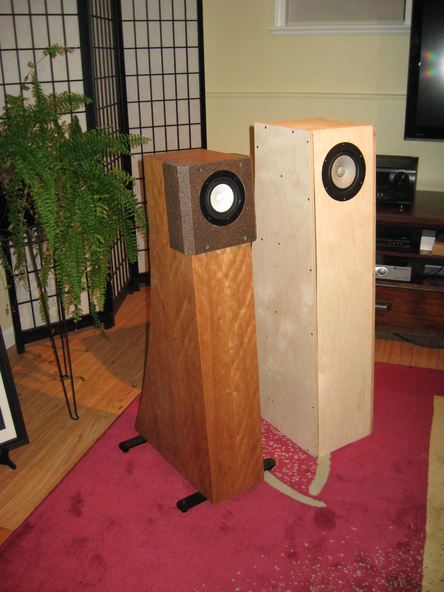

Ron,
Beautiful amp - slim, clean look. I think you will like the Alp 10.3... I haven't heard 'em yet but what I am reading on forum, it should be a good sounding wide-band driver. I have a pair still sitting in their boxes.
The FH-XL enclosure can elicit an impressive amount of LF performance from the Alpair 10P. Folks say that the Alp 10.3 metal is more extended on top and bottom - so I am guessing the combo will be a nice one.
When you do your build, consider having a removable top - that will make it easy for you to play around with the stuffing.
Keep us posted on your progress.
