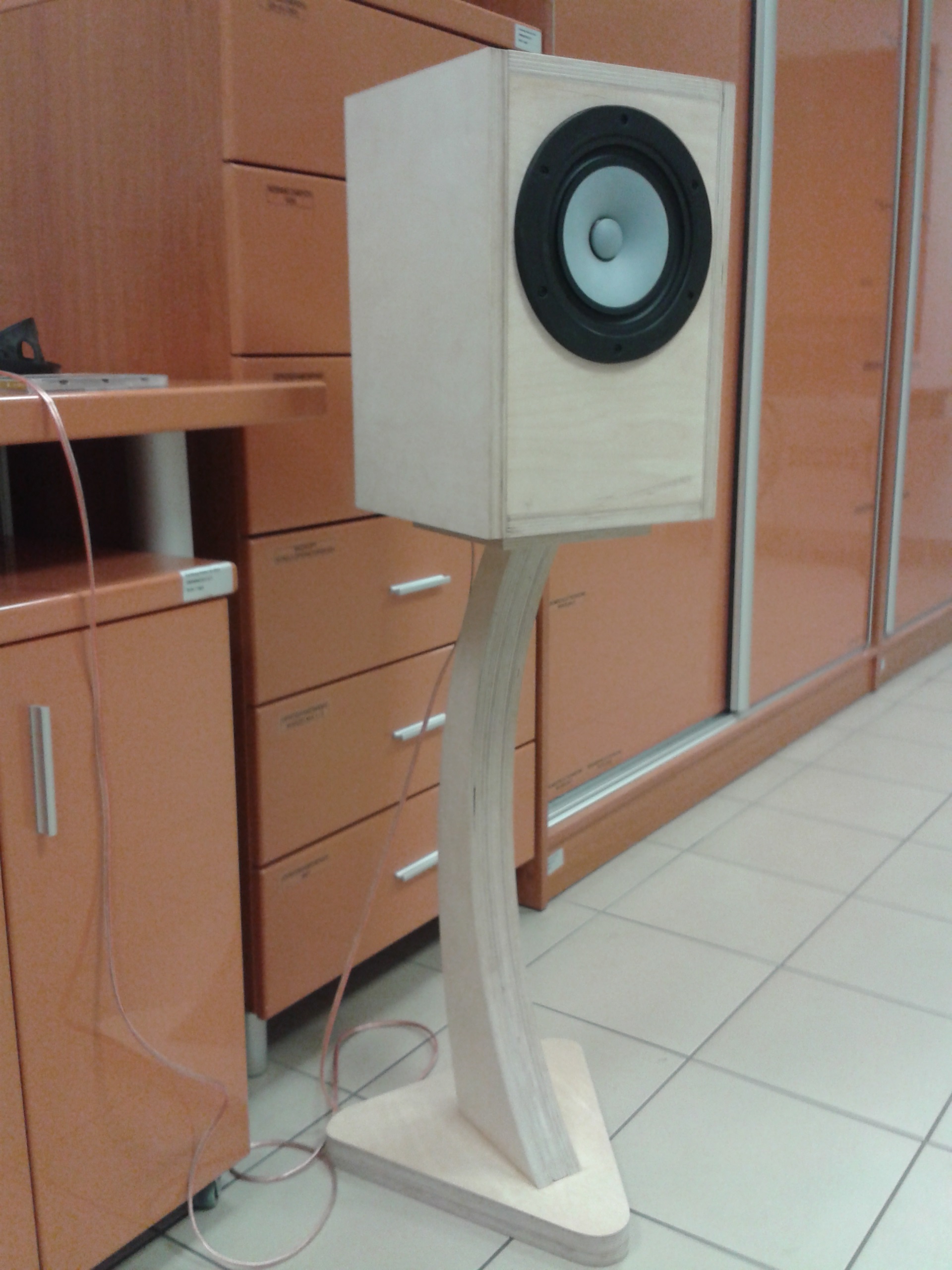

On other thread I read about using Fostex 168eZ in Frugel Horn XL cabinet. Is it possible use Alpair 12p (real 6.5" driver) in this cab?
I leave it to Scott to do the sim. A12p needs similar box size -- at least in a BR -- to A10p and does not go quite as low so it is possible A12p would work .
One would need to make the baffle full width or add a supraBaffle to be able to actually fit the driver, and the side walls would be close enuff for the issue of side wall reflections to degrade the performance.
The only advantage the A12p has over A10p is a tiny bit of greater sensitivity, and greater dynamic capability, as well as bragging rights for the largest driver, so if you don't aleady have A12p i'd personally recommend A10p which does everything else a bit better.
dave
dave

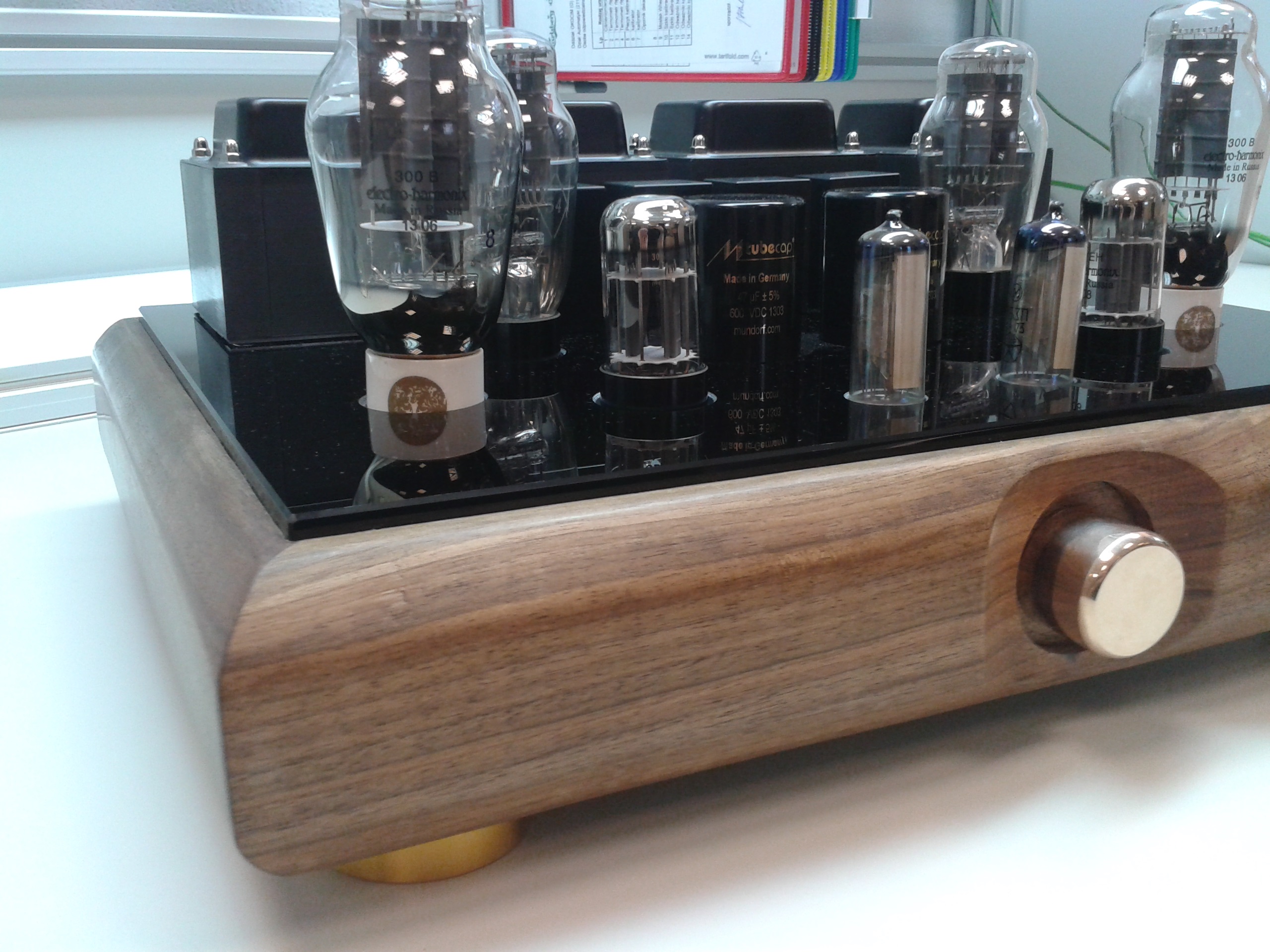

Thx for your reply. I just looking for speaker with higher sensitivity for 2a3 amp. On my previous question in other thread I get answer it 10p is enough for this amplifier. Now I have finished 12p in BR playing with diy 300B amp.
Love the look of the amp mate what is it?
Nice looking amp.
Any pics of the EM84 tubes in action? 🙂
