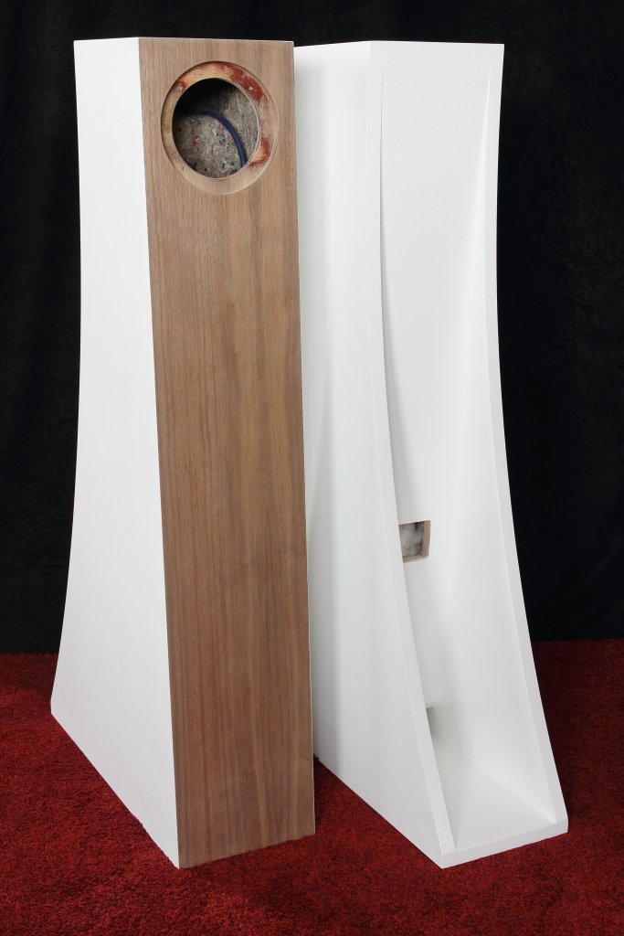

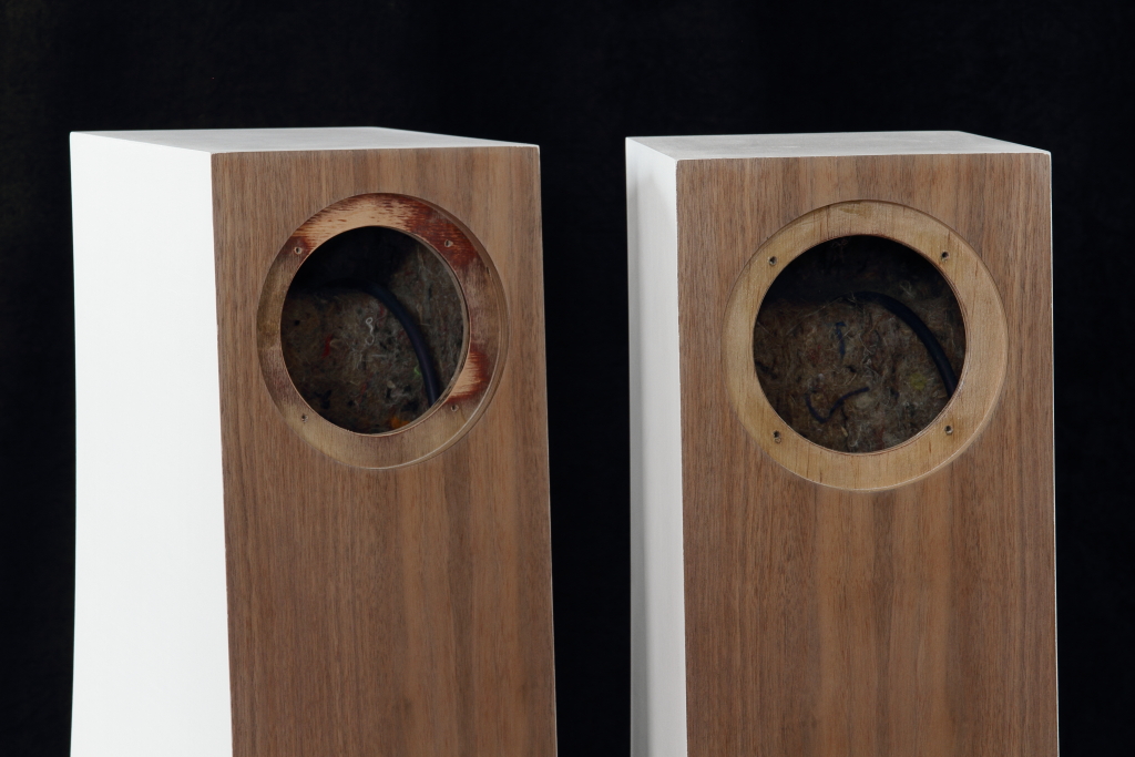

Re veneering sequence - after letting the particular sheet of veneer "whisper in my ear" 😉 to determine layout pattern dependent on figuring and grain, I like to layout full size and mark each piece with matching ticks in pencil.
One of the downsides to the FH3, FH-XL and the taller Woden Monoliths, is that the curved shape of side panels kinda wastes a bit of material - c-est la vie! The photo below is Cal Weldon's pair of FH3 in book flat sliced Oak - not a particularly highly figured sheet as it turned out, but I tend to want to center any figuring in the center of fronts and rectangular side panels.
To maintain a consistent edge reveal around the perimeter, I like to apply the back and fronts first, then the sides, and tops / bottoms last. In more rectilinear enclosures such as the Pensils, small stand mounters, etc, its possible to wrap a single piece around the front and sides in a single piece - particularly if the long egdes have a large radius or chamfers. It depends on how you like to match the grain pattern around the box. I generally like to wrap the sides / tops / bottoms continuously, but there is no "right" way AFAIC.
Re the Neopolitan stranded Bamboo - yes that's quite warm and lustrous with an oil or my preference, matte sheen (15-20%) nitrocellulose lacquer. The second pair from the left in second row with FF125WKs are finished that way.

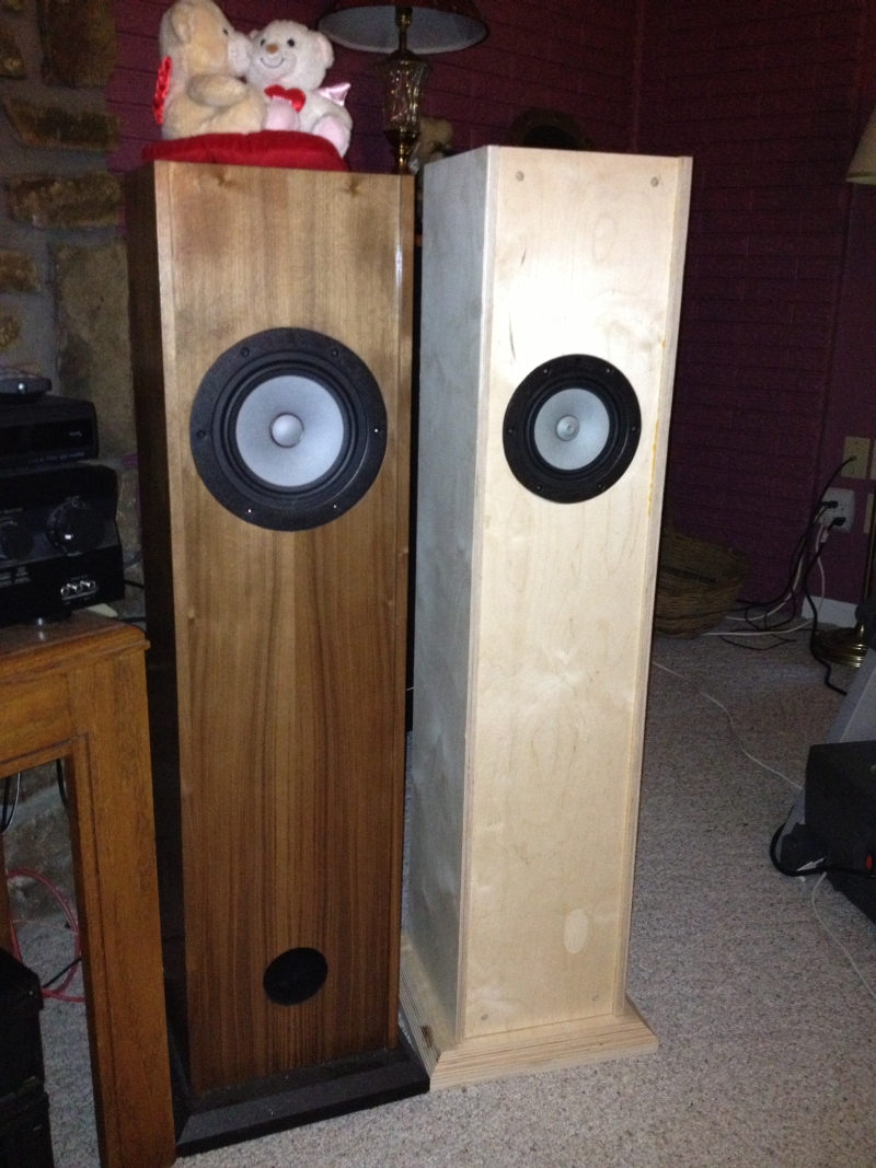

I couldn't control myself....
Here's an example of centering the book lines as ChrisB suggests. I don't have a picture of both cabinets together, but the other cabinet has the adjacent book on it, so the two cabinets are nearly identical. Looks great, but can waste a lot of rather expensive material. BTW, that's flat cut walnut.
The finished cabinet has an A12P, the naked cabinet has the A10P.
Bob

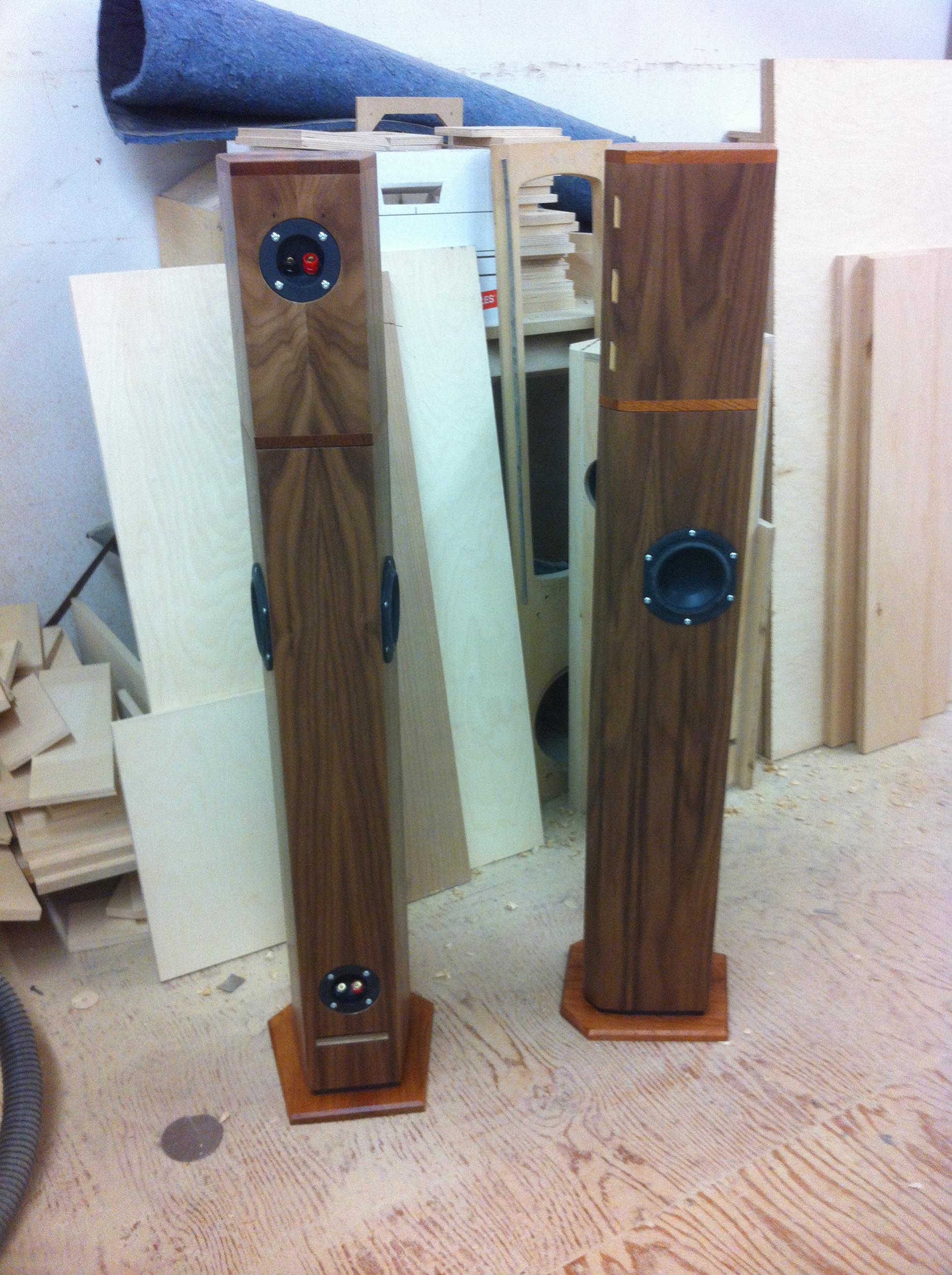

even more fun to wrap the figuring around 2 separate stacked trapezoid shaped boxes - fortunately they were small enough to yield from a single sheet of veneer
starting to quite like the walnut over the cherry
yes, we did replace the screws with black

Pssst Chris, You did a great job bookmatching mine. They look really sharp.Re veneering sequence - after letting the particular sheet of veneer "whisper in my ear"
Veneering is something I have very little experience with so I was very glad Chris was able to do mine. He really does have a fine touch and these are for my bedroom, aka SWMBO's palace so they had to be top notch.The photo below is Cal Weldon's pair of FH3 in book flat sliced Oak
bases and caps on the walnut towers and separate microFonkens are Jatoba
the finish is 3 coats of sprayed 15 degree sheen nitro-cellulose lacquer ( M L Campell HP WW to be specific), hand sanded between each coat.
for veneering, I'd recommend the iron-on glue method - contact is instant, and doesn't allow for fine alignment / centering of grain patterns as you wrap around the box - in some of the trapezoid shapes, there are at least 8 - the Facets will be really fun to veneer or clad with cedar
I like the thin paper backed - it's easy to cut rough oversize pieces with sharp regular shop scissors, and trimming out around recessed driver cut-outs, terminal cups , vents, etc is much easier than phenolic or 2-ply wood backed sheets - with some practice you can use the sharpened nose of clothes iron to make the rough cutouts of larger driver openings
