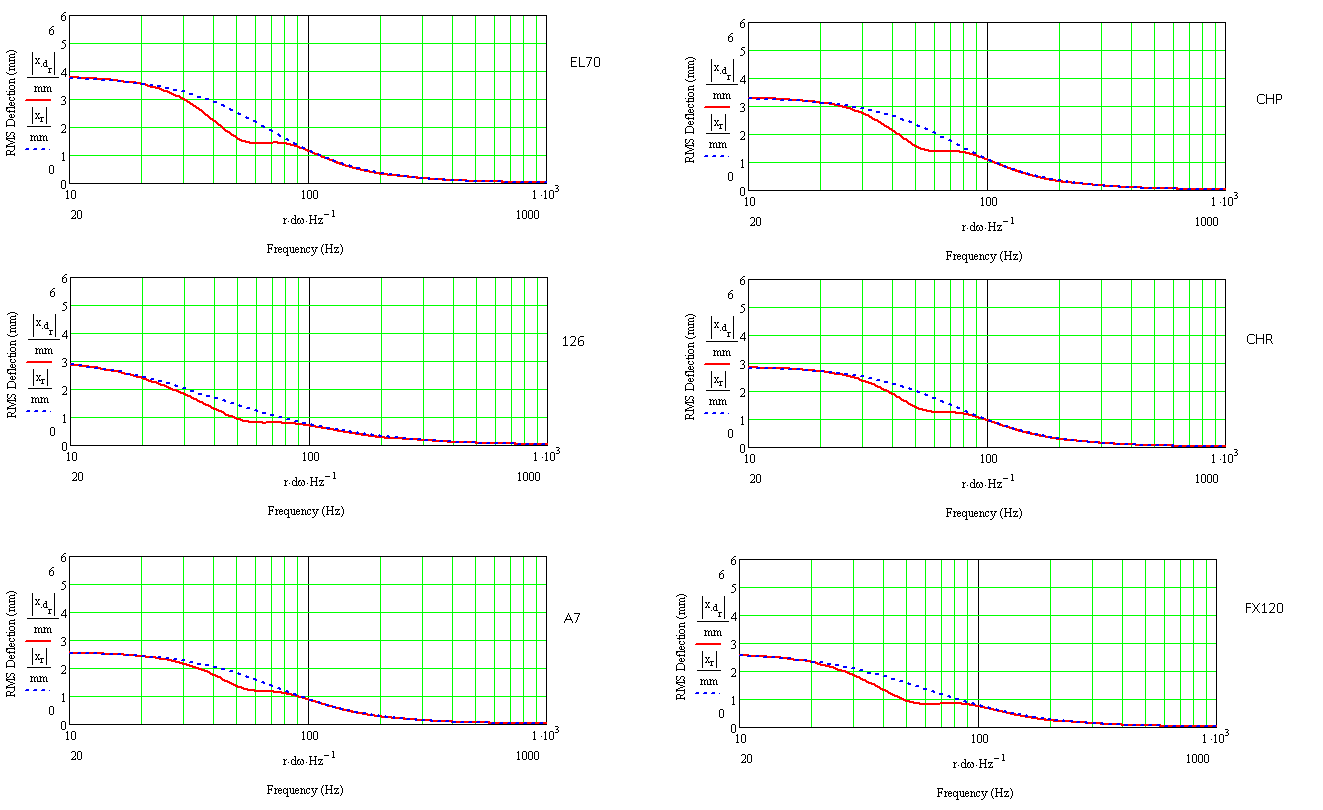

Here you are Horst. 1w/1m half space with a variety of drivers. These in practise will be pessamistic as in room the driver will be loaded 1/4 or 1/8th space, giving respectivily ~3 or 6dB more headroom.

Can you help newbie like me understand the charts you posted? I am learning a lot reading the posts here, but need some help on the measurements and what they mean.
Jeff
Jeff
Jeff,
The charts show the amount that the cone deflects against frequency, with 1 watt input. If you look at the FE126 it deflects under 1 mm in the loweat frequencies. FE126En has xMax of 0.35mm. That means on peaks above about 90 dB will start to go out of the linear region of the motor. If you put an SPL meter on your system, you find that it gets prtty loud before the peaks start to distort, and you'd need to turn it up even more for it to become objectionable.
dave
Thanks Dave,
now every one can see the 126 runs in dynamic compression
below 150 Hz at 1W 1m, thats all i want to show thanks,
i hope the reader knows what that mean.

Let me finish that for you... at levels most people who choose this driver & box will not encounter often. FE126 has examplary overload characteristic and you probably won't really start noticing until you start hitting 100 dB peaks (~106 if corner loaded), so has been said over many tims. And the limits are only below 150 Hz. Who cares?
