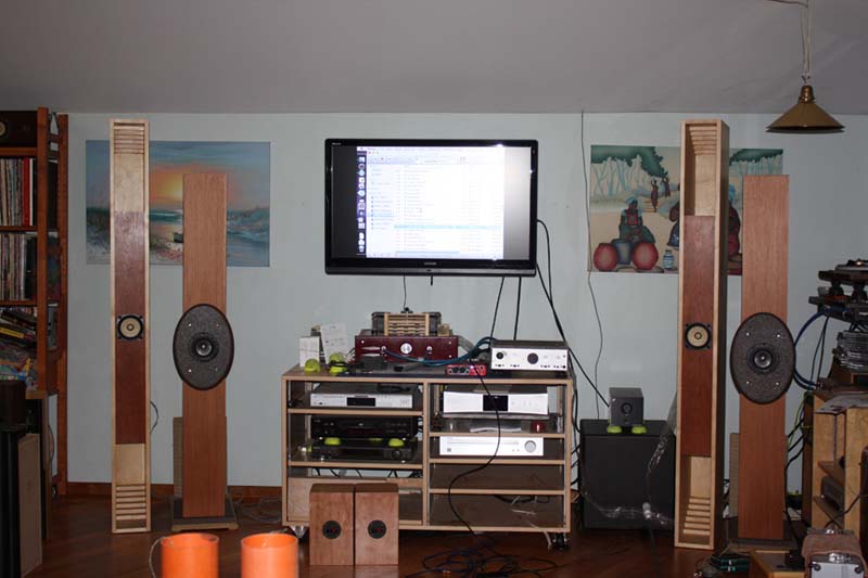

I haven't stacked or siamesed a pair of FH, but by the time you conjoined a pair vertically, you'd be close to the Valiant / Maeshowe dual rear mouth, seen here from an event this August
the axis dimensions of the ellipse were 267x386 (~10.5"x 15 1/4")
frankly, I don't think this design needs 2 drivers per side to fill a room, even one as spacious as Dave's
every couple of years I have to revise the statement "most impressive enclosure in which I've yet heard the Fostex FE126E" - and for now, this is it:

Chris, they're described as suitable for modest spaces to modest to large for the Valiant, i'm not clear on the size of the room range. Can you tell me what distance do they need to be from side and particularly the rear wall given the rear firing double mouth? Also about how far of a listening position distance from the driver?you'd be close to the Valiant / Maeshowe dual rear mouth, seen here from an event this August
I've heard them in 3 separate locations with the FE126E, and 2 with the EL70:
my place:
1) FE126 - 450+ sq ft open plan upstairs, carpeted, lots of upholstered furniture, spaced 3 feet from corners of 15ft wall (~ 9ft separation), 1ft from back wall. about 30` toe-in - sweet spot seat approx 10ft - source iTunes/MacBookPro/ Airplay > AEX toslink> Citypulse DAC > EL84 triode P/P . I haven tried to break any windows in this room since the Adire Shiva sub about 10yrs ago, my max SPL is well under 95dB, but that's still enough to fill the room adequately for me
2) FE126 / EL70 320 sqft "den" - the TV system - approx same placement / listening as above - Motorola HD cable box> Rotel RB850
Dave's place (back in August, hard to remember which of 4 pairs of drivers we didn't listen to ):
I can never remember the total cubic volume, but with steeply sloped ceiling and open floor plan (must be at least 500 sq ft?), it's plenty big enough to reveal shortcomings in low frequency energy and dispersion patterns.
Due to general clutter, speakers are generally 3-4 from back wall, and at least as far from closest corner to the right - and at least 15 ft on the left side. You'd think a single pair of 4" drivers would have trouble in this space - not necessarily so. Listening position is approx 10-12?
With their diffuse LF energy dispersion pattern, the tall double rear mouthed horns are IMO very well suited to larger spaces, and have less integration issues than front mouth variants of approx same dimensions.
space is estimated at 250 m^3 (850 ft^2). Listening distance 12-14 ft when speaker baffles are 3-5 ft of short (height) wall.

Would the diffuse LF dispersion/less integration issues allow for both the Valiant and Victor to be used in smaller more modest room's with 7' or 8' between drivers and from the listening position?With their diffuse LF energy dispersion pattern, the tall double rear mouthed horns are IMO very well suited to larger spaces, and have less integration issues than front mouth variants of approx same dimensions.
From what I've heard - yes - if the room is less than 300sqft, I'd personally be quite happy with the performance of the smaller of the two named designs - Valiant /FE126 or Maeshowe / Alpair 7.
