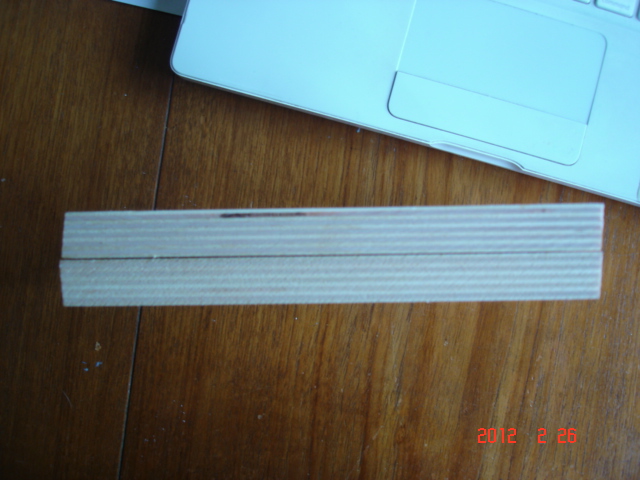

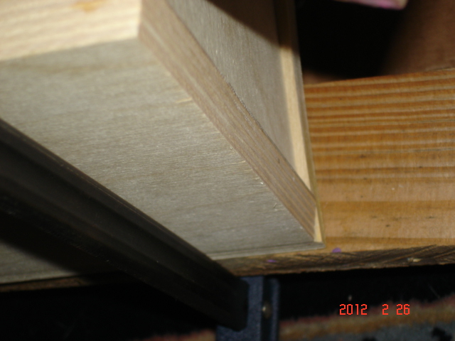

One of top boards cut wrong?
Attached are 2 pictures of the top boards.
The one at the top of the 1st picture aligns to the baffle, the back, and the sides, but the one at the bottom of the 1st picture doesn't, see the 2nd picture.
Is there any easy way to fix this cosmetic defect?

pchw,
I just assembled a FH3. I'm not a woodworker and not very handy, and this also was my first project. I don't really know what the pictures show, so I can't help you, but I do have another piece of advice. When you assemble the backboard and divider I would recommend to use some masking tape and mock up the top, bottom and front. If you do that and the other side fits flat you did it right. If the divider is not all the way down, the other side will not close correctly.
My FH3 went together butter. The divider needed some talking too, it was tight. It's a very well fitting kit. If a piece didn't fit right, rotate the piece and you will see that it fits like a glove! Quality kit. I'm ready to stain it and hopefully by next weekend listen to it. I'm very happy with the kit.
Hi nrg2009,
The back board and the divider fit just fine. It was when I put all panels together (with clamps) to get a previw, I found one of the top boards didn't "flush" to the surface.
Look at the 2 boards in the 1st picture, both are taken from the side. You can see one of them is kind of like a parallelogram which is correct as it has the same angle of the front and the back panels. However, the second one is cut like a trapezoid; therefore, when one end is flushed to the front panel, the other side won't.
If you look at the second picture, you can see the bottom surface stuck out a little outside of the side board which isn't too bad, maybe 0.5mm-0.75mm; however, due the wrong angle, the side board is exposed more and more towards the top. You can see that at the bottom of the 2nd picture, kind of like a little white triangle. I don't think it will affect the sound, just doesn't look as good.
