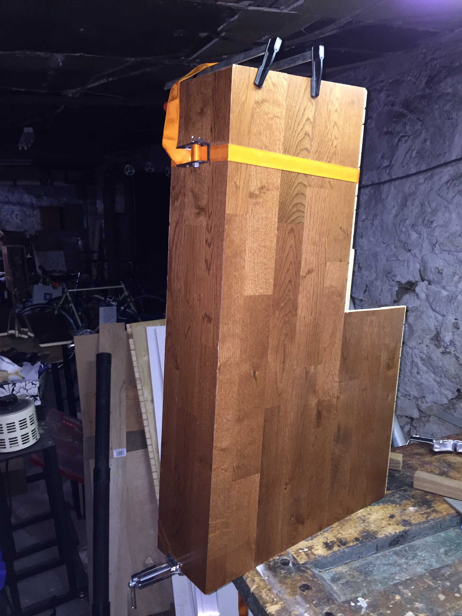

Just took my first listen to the Alpair 7.3s that are going into my FH. I have one in a USPS (postal service) box that is 12" square on the sides, 6" wide, with internal baffles a la FH. The other is just bare. Listening to Norah Jones and she sounds pretty nice at low volumes. I'll put this on repeat and drive the rest of my family crazy with it for break in. While I generally don't believe in break in I'll follow the recommendation since the real boxes aren't ready yet anyway.
At least another 2 days of cutting, measuring thrice, cutting once, and then doing a mock glue up. Still trying to figure out the order for glueing, as the chamfer I put on the front/side joint is difficult to get right. There is one big drawback of using pre-finished wood in that you can't cover up your mistakes easily.

They've been playing non-stop since about 11, so I'm almost half way to the 20 hour mark, then I can start increasing the volume. I may be able to clamp together the first box tomorrow as I found some time today to cut some wood. It would be without the curve.
One thing I'm finding is using a router on the flooring I'm using for the build is a lot slower than on MDF. That oak layer is extremely hard and leaves a very sharp edge, as my thumb will tell you. It sliced right through, ouch.

Cutting the curve is proving to be difficult. I built a long extension to the circle jig on my router and tried using that, but I needed to anchor the jig on my bench and use a separate table to hold the template I was making. The problem is the table shook, the router dug in, and the piece broke (it was already broken but holding together, that's why it was going to be the template). I ended up with a not very even curve at a 1/4" depth in a 5/8" piece. I've tried to sand it even, but I'm going to cut all the way through, use a flush trim bit to get the whole thing even, and then sand the curve fully smooth. It isn't off by more than an 1/16th of an inch in the worst spot.
Maybe by EOD tomorrow I'll have a box fully shaped and clamped and I can take a listen. The drivers have about 25 hours on them at this point. I'll resist the urge to turn it up.
