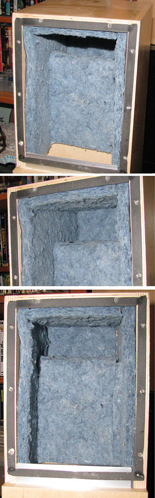

I pulled the driver baffle off one of the prototypes. The ayyached picture shows the cotton felt we used to line around the chamber. The part on the partition folds over and reaches 2-3 cm into the back chamber. The piece on the back is about even or a little below the top of the partition. Turns out there isn't much polyfluff in the pointy bit. It comes up level to about the bottom of the piece of felt on the front of the partition. I estimate 0.3-0.4 lbs per foot cubed density of polyfluff (i could not remove it to weigh).
This could be thot of as a minimum quantity and suitable for FE126En away from corners. Progressively more will be required to reduce bass levels depending on room or driver.
dave

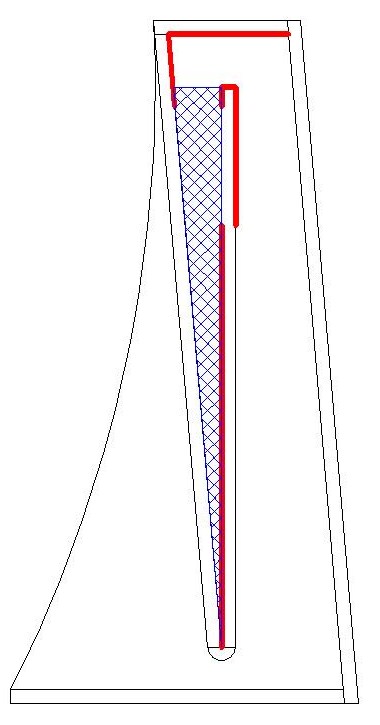

I looked at the photos and read the descriptions about the stuffing and visualized what it's supposed to be and made a drawing. The thick red line is where I think the stuffing is supposed to be. The blue hatched area is where I put the stuffing in the "V" chamber. If less stuffing means more bass then I definitely will pull the stuffing from the "V" chamber. I have located the driver 10mm too high on the baffle so I have to go back to my carpenter friend to beg him to cut the baffles for me again. Finished the second speaker but don't have the chance to hear the FH3 as a pair yet.
Cheers and thanks to Dave and others who have any comment.

There is a damping diagram in the beta document (page 6). I have updated it to reflect the latest info.
New beta doc with all the drawings to date.
FH Mk3 beta document 25-oct-10
dave
