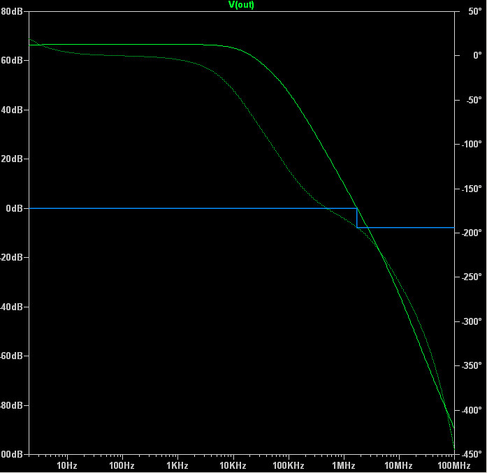

What are your phase and gain margins?

We're looking for the gain margin, rather than the gain. With a feedback loop the phase generally increases with frequency, and the gain generally decreases. If the phase ever gets to +180º when the gain is still above 0dB, you get oscillation.
However, because there are lots of other dynamics involved, you want to have some safety margins. A good rule of thumb is that you want to still have 45º of phase to go when you reach a gain of 0db (that's the phase margin), and be at least 6dB below 0dB when you reach 180º of phase (that's the gain margin).
You find these in SPICE by doing a small-signal AC simulation. I'm sure you simulator has something similar, but I'm not familiar with it.

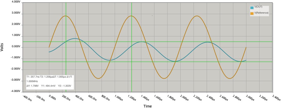

We're reaching the edge of my knowledge here, but I don't think you care about that. The local feedback between the two is what's going to linearise the current source.
Something's not quite right; that's showing Vout smaller than Vreference. (I assume Vreference is the input?)
Also, if that's the best the CircuitLab can do, then it's time to download LTSpice (it's free). This is the output of the small-signal AC analysis in LTSpice. The solid green line is the gain; the dotted green line is the accumulated phase angle. You can see that over the audio range the gain is about 65dB.
I drew the blue lines. The top one shows where the gain line crosses 0dB (at about 1MHz). If we then draw a vertical line to the phase line and then over to the phase axis (lower blue line), we get about 190º. That's over 180º, so this circuit is unstable and will oscillate.
To have a 45º phase margin, the accumulated phase angle would need to be 135º.
To find the gain margin, you go backwards. Draw a horizontal line where the accumulated phase crosses 180º, draw a vertical line to the gain line and then over to the gain axis. You want this to be -6dB or lower.
In the above chart it's going to be about +5dB, again indicating that this circuit is unstable.
(Note that you don't actually have to draw the blue lines. If you control-click the trace label LTSpice will add a cursor and a window which reads out all the pertinent values.)

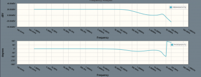

It was my fault, the software has the frequency analyzer tool, it was me who did not know how to use it. Thanks for the explanations Jeff Young. I've attach to screen shots of the simulation. It seems that the phase will approach 180 at 50MHZ and -6.8db.
Please note that the simulation was done with 2Sk170 and not IFN146.

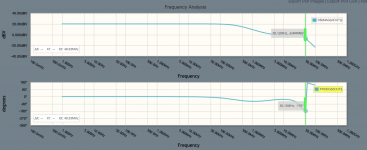

Yep, so your gain margin is about 7dB (that's sufficient).
Your gain crosses the 0 line at about 10MHz; the lowest the accumulated phase goes before that looks to be about 70º, so your phase margin is about 110º (that's gobs).
Thanks for the detailed explanation JeffYoung! i finally understand the use of this .
