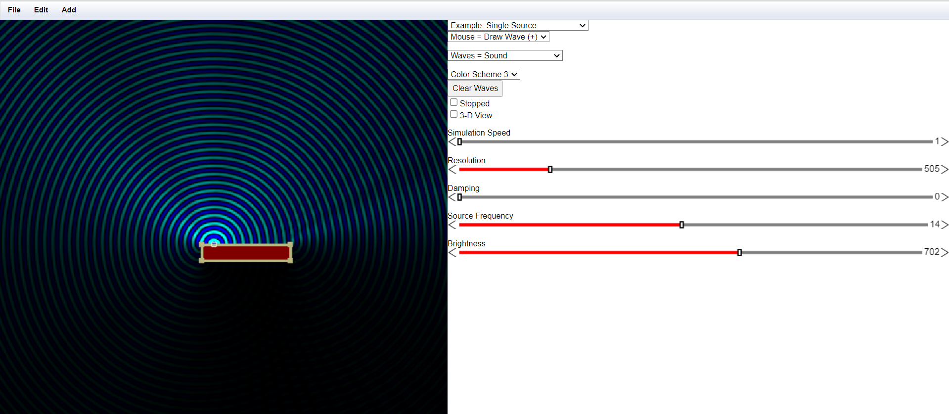

Ok managed to get visuals, point source on a "baffle"
Ripple tank example showing diffraction related ripple
This asymmetric positioning shows nicely some nulls forming from edge diffraction when the simulation speed is slow. Adjusting the box from narrow to wide shows ripple as well with these settings.
edit: Aww the settings aren't included in the link.. Put simulation speed to lowest and set color scheme 3 for good view.
It is a bit hard to adjust the sound source at the box boundary, if the source is away from the boundary there are some additional effects in play 🙂 Anyway, another nice software to visualize stuff.
A screenshot. Anyone should try to use the animation though, it is fun to see the effect form as function of time!🙂
At first the sound is "pure" at listenig spot but then after the diffraction happens and sums with the direct signal there is attenuation or amplification dependig which angle you are at (and frequency). Other ear might get attenuated signal while the other receives amplified, while at some other frequency it might be vice versa. I guess a slight timbre change happens at least? Not sure how hearing system detects this kind of effects but brain must be having lot of computation going on. Temporal masking relates to this at least. Anyway diffraction seems to be a thing to avoid in a loudspeaker.

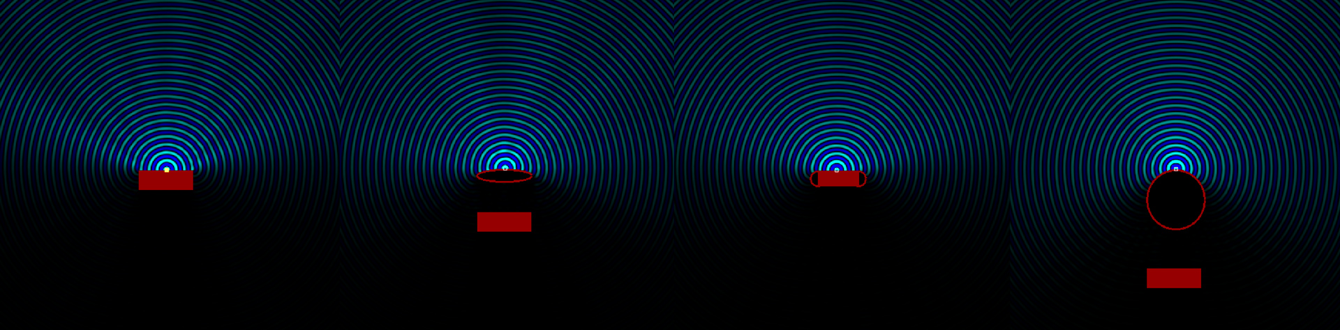

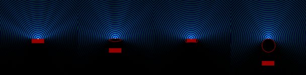

Quick try with Ripple tank to check if curved baffle has advantage over flat baffle and it seems there is no advantage if the baffle edges are sharp. If the edges are rounded there still isn't too much benefit curving the baffle I guess. This is not comprehensive test but given that curved baffle is lot harder to manufacture than flat, a flat with round edges seems the best option for DIY folk, or just use minimal baffle. Wide baffle has advantage to shadow sound going behind the speaker but roundovers need to be generous to attack the diffraction. Narrow baffle (to my eyes) seems as effective as wide with rounded edges but radiates more to the back (higher frequencies, higher bafflestep).
In ripple tank there is no numbers visible and the brightness of lines in the attachment are different so position of the point sound source to the "baffle" is not perfect and this is only one / few frequencies I tested but I think they indicate that rounding the edges reduces the diffraction ripple, other tricks juts change the distribution of the ripple.
Ripple tank link, change color scheme 3. Point source should be at 12.01m x-axis coordinate, baffle left at 10.01m and right 14.01m anyone wants to replicate the stuff in the attachments.
