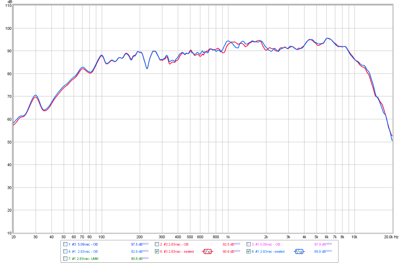

Thanks for replying to my question - and thanks for kind words on the Fountek 2in and AC130F1 speaker. Here is the measurement I made with the AC130F1 in circa 5.7liter boxes.
Here is a comparison of a good and bad driver in frequency response. I think these were made at 0.5m and 1.4v:

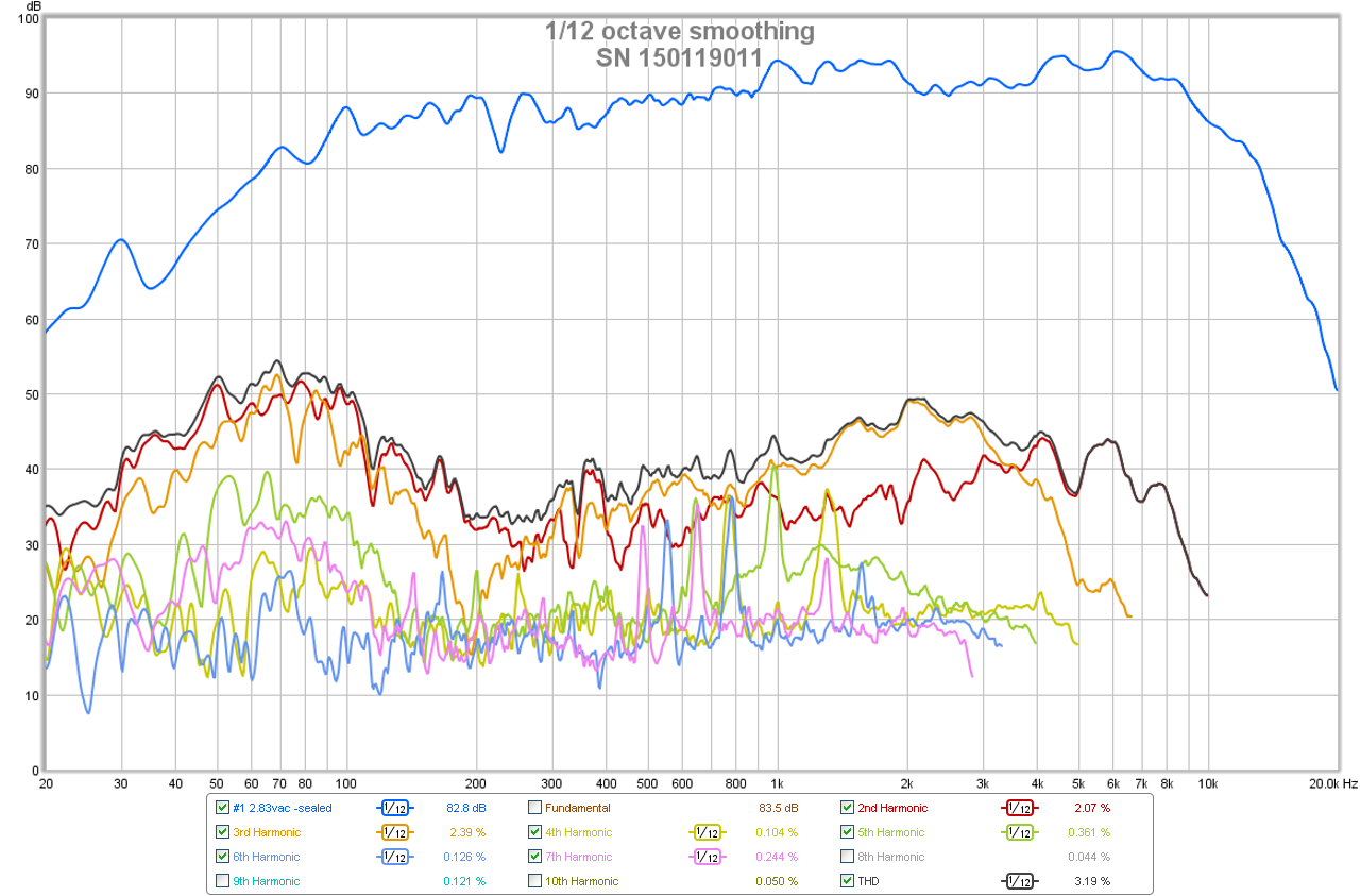

Here is the measured HD of the "good" driver - this is running full range (cursor was at 80Hz so about 3% distortion):

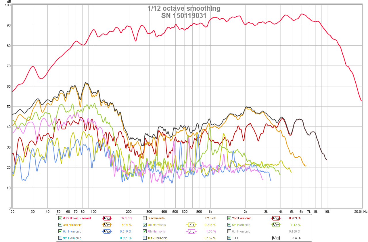

Here is the measured HD of the "bad" driver - cursor was at 80Hz and about 6% harmonic distortion. I was sent two additional units and they both measured like the "bad" one so it would appear the "good" one is an anomaly. Both have distortion starting to rise below 200Hz:

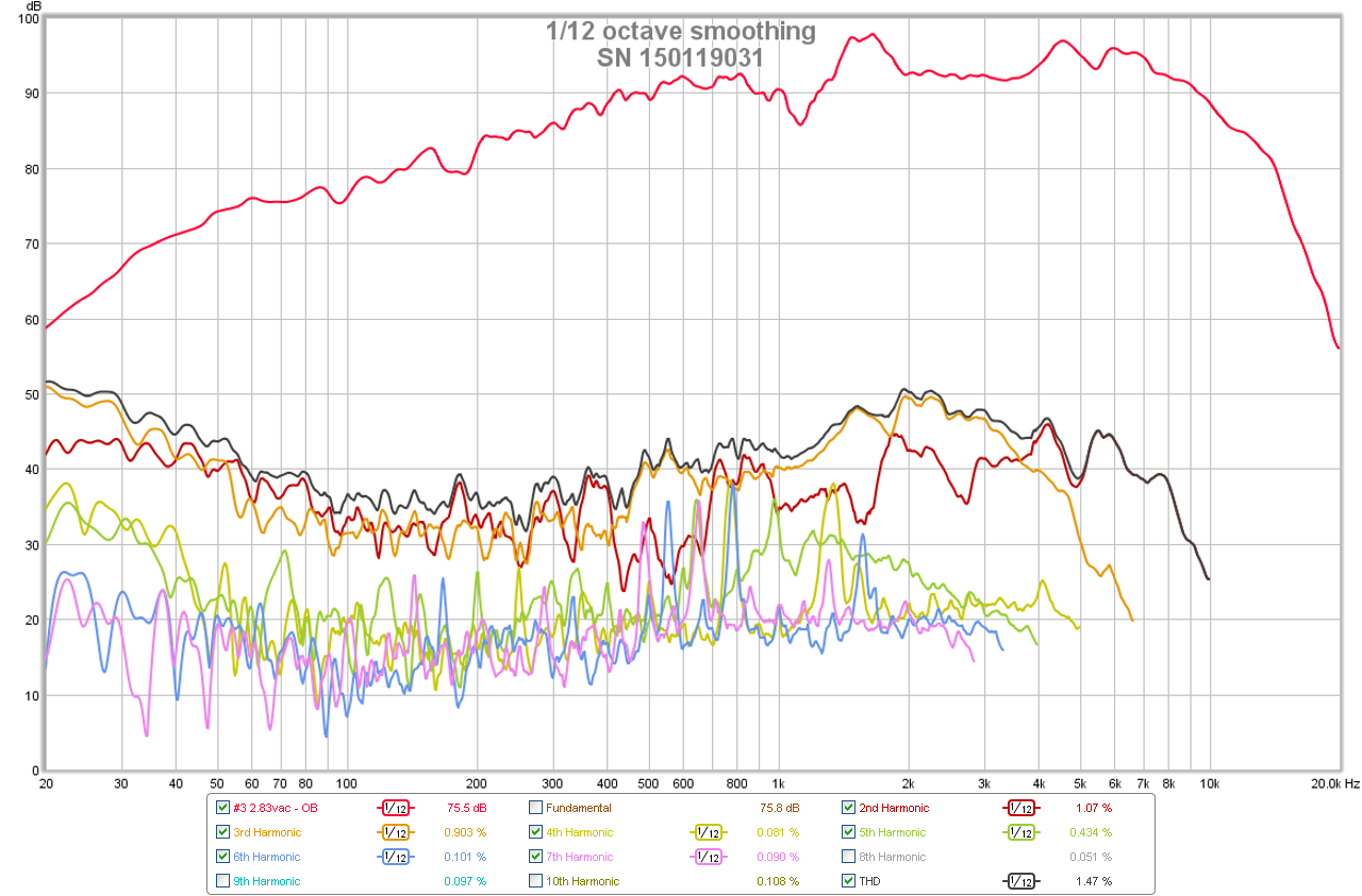

And when I measured in an open baffle, with no pressurization, the difference in the HD went away. Although the difference in H3 between the two below 200Hz is significant.

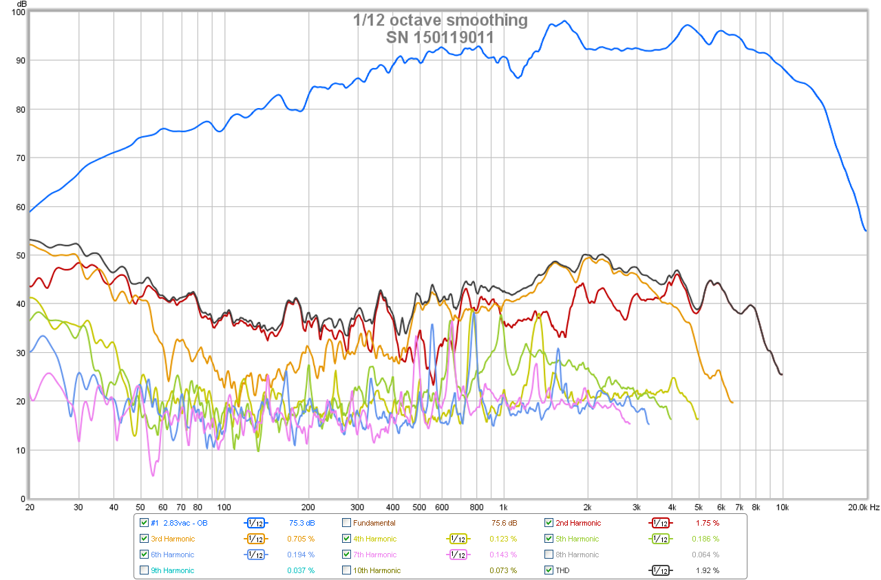

"Good" unit in an OB:
"Bad" unit in an OB:

XRK971 - I really don't have any problem with what you are posting. The AC130f-1 is not a high end driver, it's more of a middle range midwoofer with a fairly conventional motor design.
I've got speakers that use Scanspeak Revelator, Illuminator, Satori, Audio Technology, and the Morel Supreme, which use multiple shorting rings or even full copper sleeves to reduce distortion. The AC130 doesn't employ anything like this, but it is only a $60 woofer too.
It's not perfect, but it came down to what my goals were for the Continuum - a smaller speaker capable of excellent midrange reproduction, that would normally work with a subwoofer. I felt the AC130 did a remarkable job at hitting this mark. I really didn't expect this speaker to deliver too much below 100 Hz, just enough to handle lower SPL's and be able to cross to the subwoofer.
However, it did surprise me when I started taking nonlinear distortion measurements and saw that it was significantly lower than the SB15NRX in the similar sized Piccolo. I didn't expect this since the SB15 used shorting rings. But, like with the ATC SM75, the AC130 uses Ferrous mass to help lower distortion. I did make a comment to SB Acoustics about this disparity though.
Another thing, small sealed enclosures with reach the point where the compliance begins to increase the distortion. I even created a program to calculate this, so there is a balance between enclosure and distortion. It's a tight rope walk sometimes.

Good to hear that you think this is normal. Probably lack of shorting rings and small enclosure combine to make it so. So ideally more of a mid bass than a woofer. It has a remarkably smooth mid range though so great performance there. I am not criticizing the Continuum design at all - great speaker and might build one some day given that I have the AC130 and the RS28F (not A). Maybe there is a simple XO tweak for the F silk dome tweeter?
