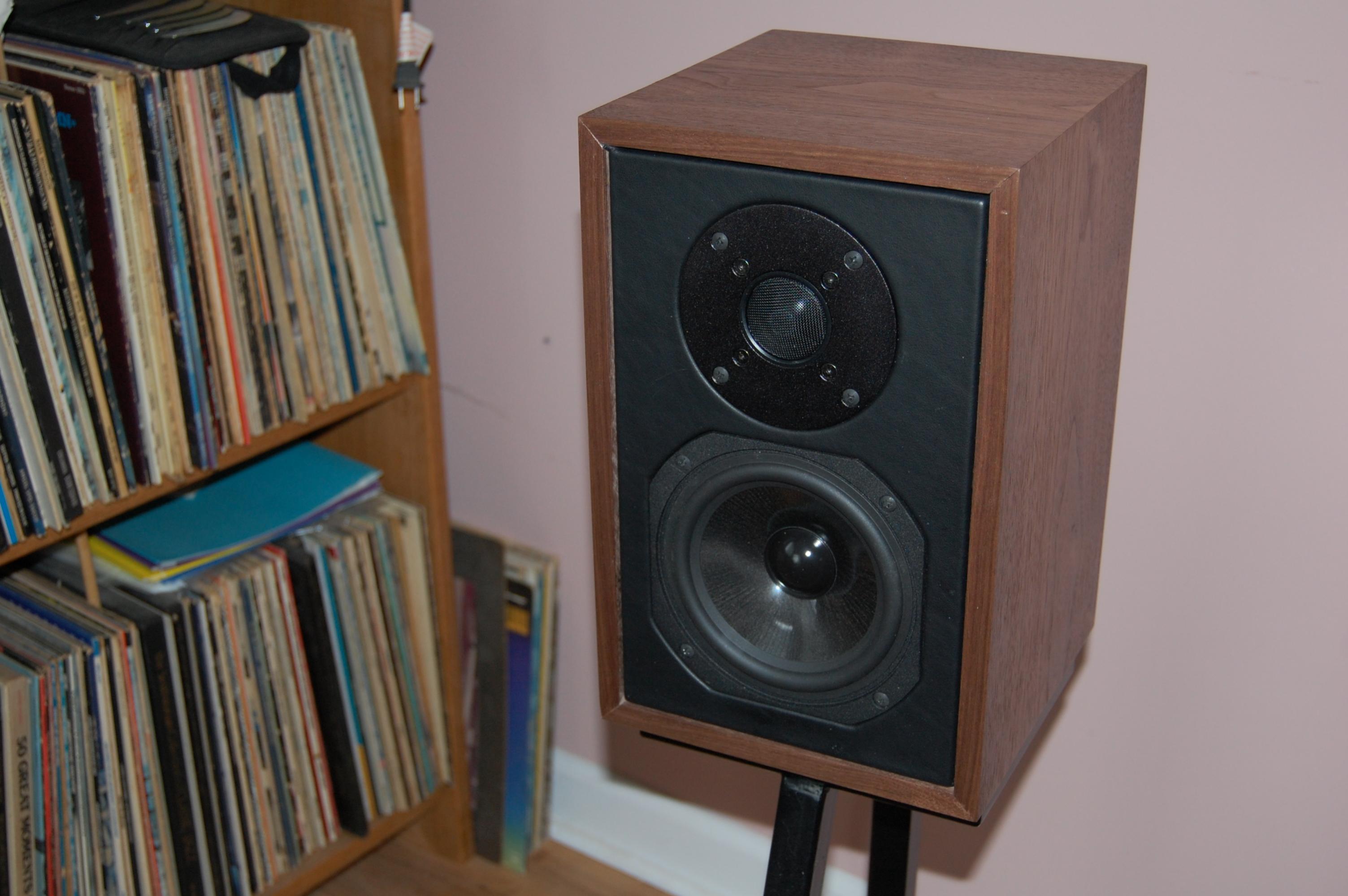

However the speakers I now have in my somewhat small music room and have been there uninterrupted for over 3 months continuous use and, I believe, are the most musically satisfying speakers I have ever owned, and will probably remain there are a pair of Jeff Bagby Continuums with two Ripole subs actively crossed with a minidsp.
I took a few liberties with the cabinets which are made from walnut with 1" thick leather covered baffles and front mounted drivers.
Thank, Jeff.
These little jewels beat the socks off everything I have built to date.
Picture attached.
Peter

Erik.....The speaker was placed close to the wall only to reduce the flash shadow. They are normally 24" from the front wall for listening. No room treatment added, other than 50% floor is carpeted and a soft sofa and recliner.
I have a 30 degree sloped ceiling from left to right and the right speaker required 5db boost at 60hz to closely match the left one. This was done prior to introducing the two subs. Subs are located between the speakers against the wall and crossed at 80hz LR4. I'm toying with the idea of lowering that to 60Hz.

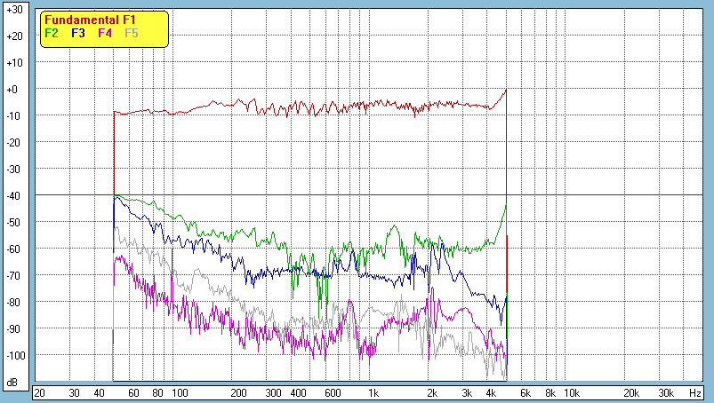

The Continuum is a great design that seems to get rave reviews. I have yet to see distortion measurements from them - has anyone seen such measurements?
I was at Jeff's house listening to his speakers, and he pulled out the Omnimic on the spot and measured the HD of the Continuum. It has very low HD from about 100-20k, IIRC.
