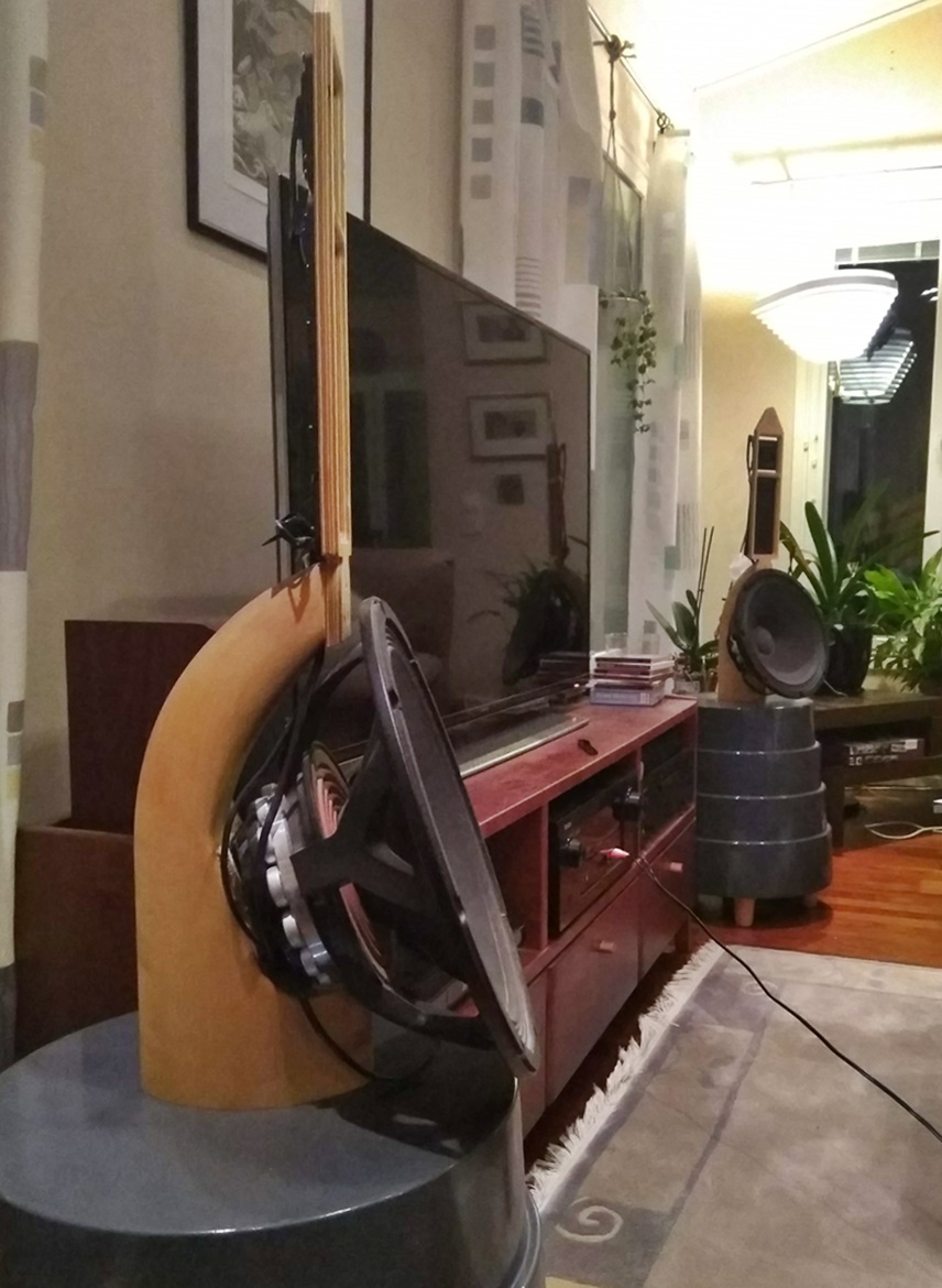

If you look at my 'S19' basically I'm using upper half of the sub as monopole (block the rear using a plank of wood). So 1x sealed sub each side. Disconnect the lower woofers.
What I will do later is block both opening of the sub, voila... 2x monopoles per side, push-pull. = 4x monopoles for stereo.

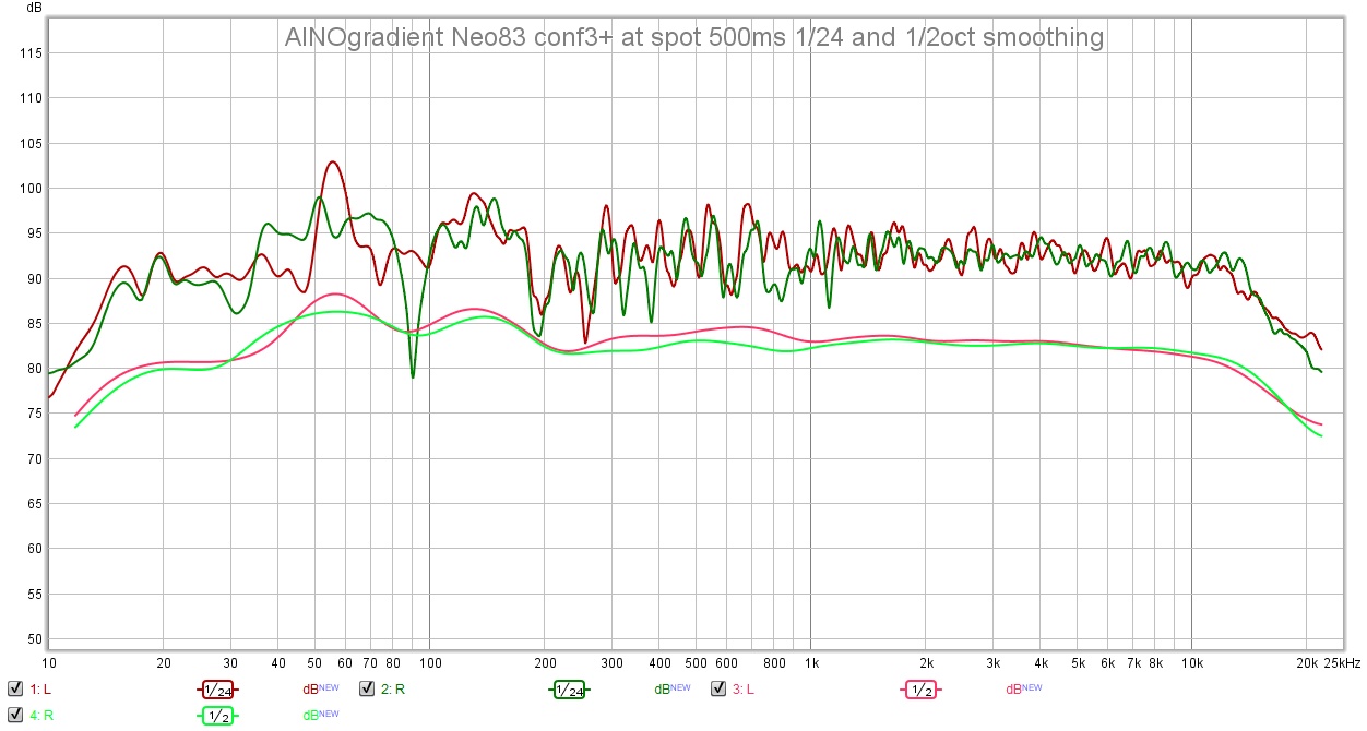

Despite of the dspersion model, I think that overall room response is most important factor. My current system works well - nearfield response is straight and room response is declining to highs. Bass level around 50-200Hz is 5-10dB above 1000Hz, which is 2dB above 5000Hz. Of course at low levels even this house curve sounds too lean because of ear/brain loudness curve.

I am using textbook 80hz LR4, sounds great. There's the typical modes showing which I am not content to fix yet.
What I am sure of from this exercise is dipoles simply can't pressurize the room at the lowest octave, and to me at least this is a problem.

My room response 300ms left and right. Speakers are at similar position to front and side walls, but back wall is different - low modes are different.
