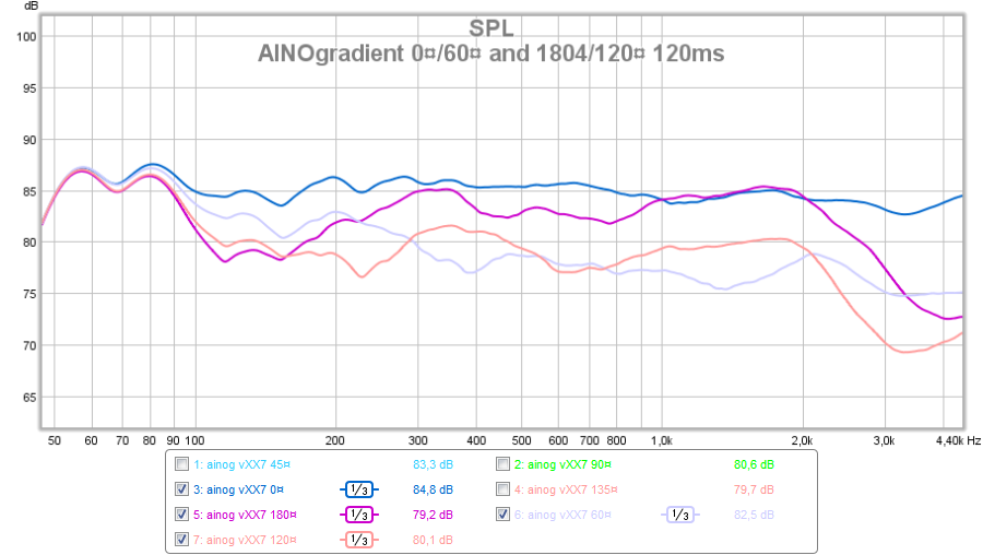

A practical example of mixin mono/omnipole woofer to dipole mid. My xo is now at 130Hz LR2.
Here are responses at 0¤ and 60¤ (blue) and 180¤ and 120¤ (red)
We can see that between 100 and 250Hz rearside radiation is lower than frontside (cardioid pattern) but the differece is only 3dB. Again above 3000Hz there is monopole tweeter with LR8 xo.
Front and rear radiation are not mirror images also because time-alignment of two mids is matched to the frontside, xo 800Hz LR4.
