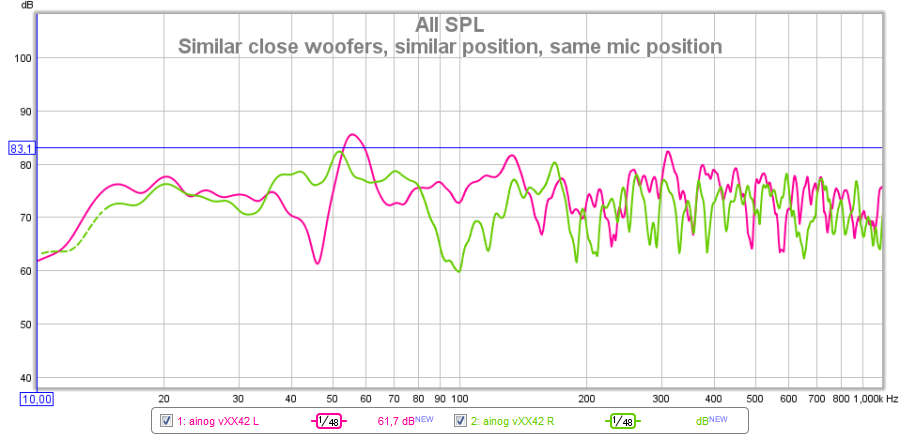

My approach with AINOgradient is to xross mono/dipole around 130-150Hz LR4. I have tried lower and higher, LR2 and LR4. I use a single 12" as lowest dipole and it heeds HEAVY eq if I want to cross below 100Hz. I get the floor cancellation around 200Hz, this is why I want the mono woofer to give some output up to there. Room/power response at farfield is the main goal, outdoor/pseudoanechoid/nearfield measurements are needed too , but real "end user" environment is the final goal, with all it's reflectins and cancellations. Listening tests are very important too. Poor delay/phase match leads to missing "oomph" Well tuned closed subs sound very clean and twin "subs" help to alleviate room mode problems.
Mono+dipole=cardioid
This is difficult in practise, because of nearness of walls. In the crossing range there is a measurable cardioid response area, quite wide with LR2, narrow with LR4
A friend has an excellent dipole system down to 30Hz with 2xSLS12 in H-frames. There is wild excursion at his rather loud listening spl, but sound is good. I wonder that distortion must be quite high. He has a special room, most people don't.
dsp eg. minidsp is a wonderful helper with these tests!

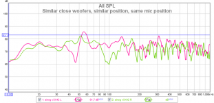

My room response 300ms left and right. Speakers are at similar position to front and side walls, but back wall is different - low modes are different.
