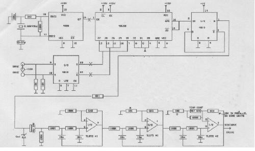

I'm looking for schematics to build me a PLL 50Hz psu for my lp12
I already found some threads around the web but none with schematics, except for this one, but i can't remember where i found it... *stupid*
i'd like to get as close as possible to the specs of a linn lingo ...
so a maximum drift (?) of 0.01 Hz is allowed....
therefore the wienbridge oscilator schematis as used for the garrad 301 is not good enough ( 0.15Hz)
any sugestions?
(i'd like to diy the project so a kit solution like the wnaudio turntable psu is not preffered)

Ha,
That's my design! I gave away my last PCB's on the forum last year. They were leftovers from a commercial venture many years ago. The 40103 chip is difficult (but not impossible) to get now.
The frequency acccuracy will depend largely on the temperature and the grade of capacitor used in the oscillator. If you mount this circuit in it's own box, away from heat generating components, the accuracy can stay very good. There is no need to fit the NTC thermistor in this case.
Remember also that the 301 / 401 motors will vary greatly in speed if the voltage (amplitude) changes, so you must also ensure it remains stable.
Enjoy,
do yourself a favor -- skip the analog filters and grab a sample of the 8th order elliptic filter from Linear Technology. if 50Hz is the frequency you need you can use the self-clocking feature of these filters. (i have burned up some of these chips trying to self-clock too fast.)
it's also helpful to put some thermostatic mechanism in place --
I understand only half of the story, but it seems you need a very accurate 50Hz sinewave source.
Then why don't you use some numerically controlled oscillator in an FPGA (or CPLD maybe) and an audio-DAC? That way you should be able to generate an ultra-stable 50Hz (just as stable as the crystal oscilator used), and a different frequency is easy also.
You could even take it a step further: drive a MOSFET half-bridge or full-bridge directly from the FPGA/CPLD to synthesize the sinewave directly at the required powerlevel. Add a simple LC filter, and you're done.

He is already using a cristal-controlled numerical oscillator and a 6-th order low-pass filter. What he wants to improve is the precision of the own cristal oscillator, since there is just no way in which the rest of the circuit could affect the output frequency.

There are easier ways to go now, such as suggested by Jack, or the other poster's suggestions, but they all rely on you having some experience.
I will reiterate my previous statement that frequency accuracy is not the only important factor, amplitude stability is also important for any synchronous motor. If the amplitude varies, the speed will change, therefore it is not worth going overboard about frequency stability.
If you want, you can feed the output of this circuit into an audio amplifier and "step-up" the voltage using a transformer. It will work.
WRT the analogue filters: You can get them more accurate by choosing better resistor values. The values quoted were used for 50 or 60Hz. Go to the Texas Instruments site and I think you will find a tool for calculating the values.
