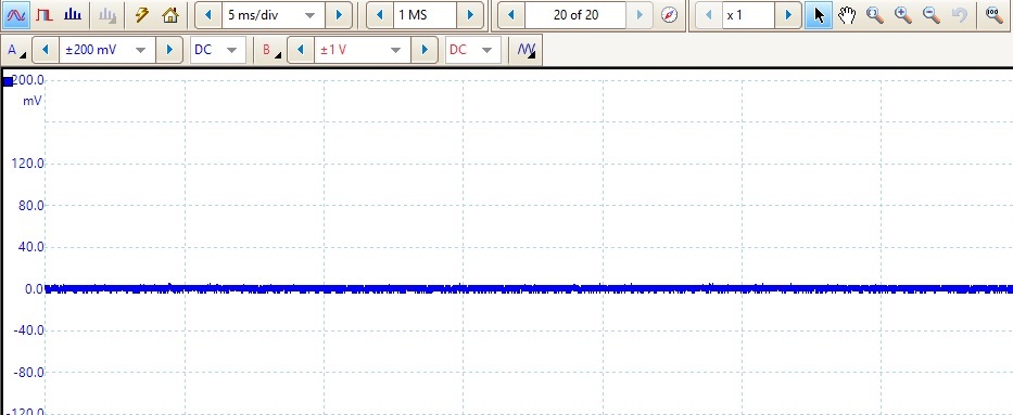

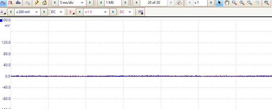

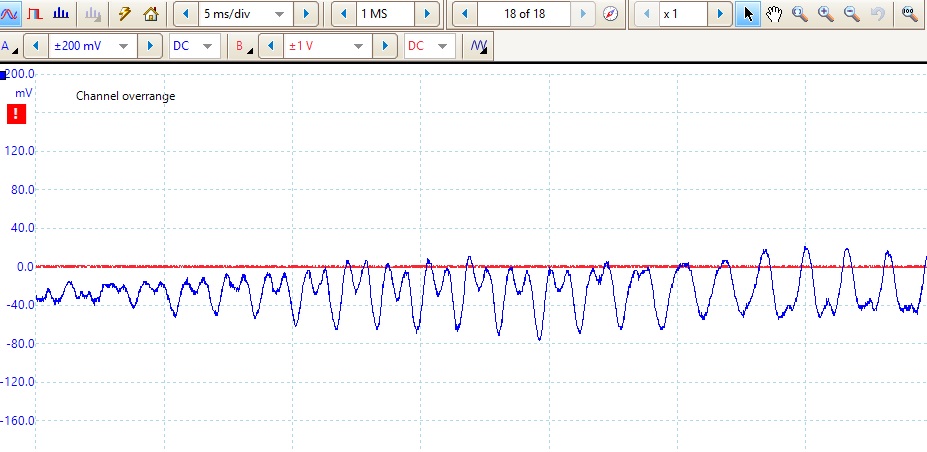

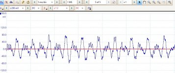

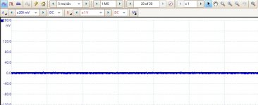

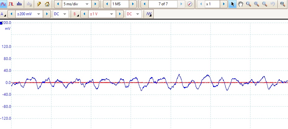

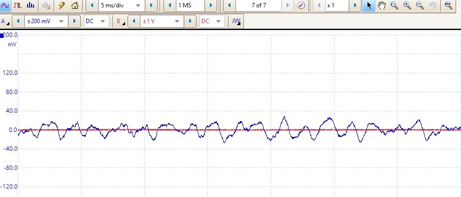

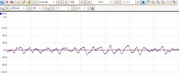

I captured some scope traces at the output of my I/V transformer and listened to the same track.
I found little difference in the SQ which is I assume is mainly down to the dacs (NOS AD1862) & transformer I/V) but I did find myself preferring the lower FS settings.
I had expected to find the higher FS settings to be better as the transformer will be more effective a filter.
There is no other filtering other than that provided by the transformer. There is more noise visible on the 192K mode but its possible its the AD1862 and this was also least preferred setting.
Traces: 64k, 88k, 96, 176k, 192k, 88k no signal, 192k no signal

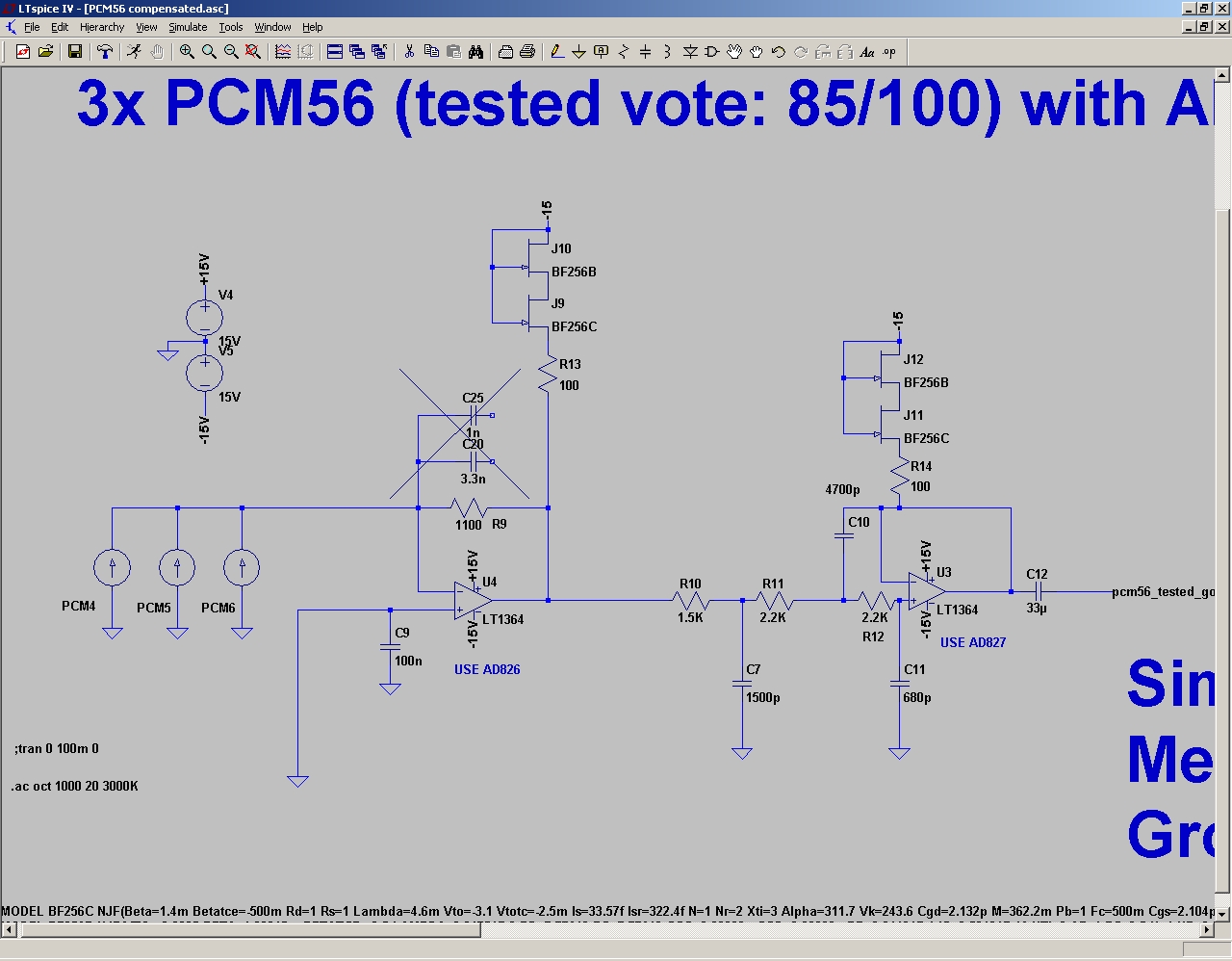

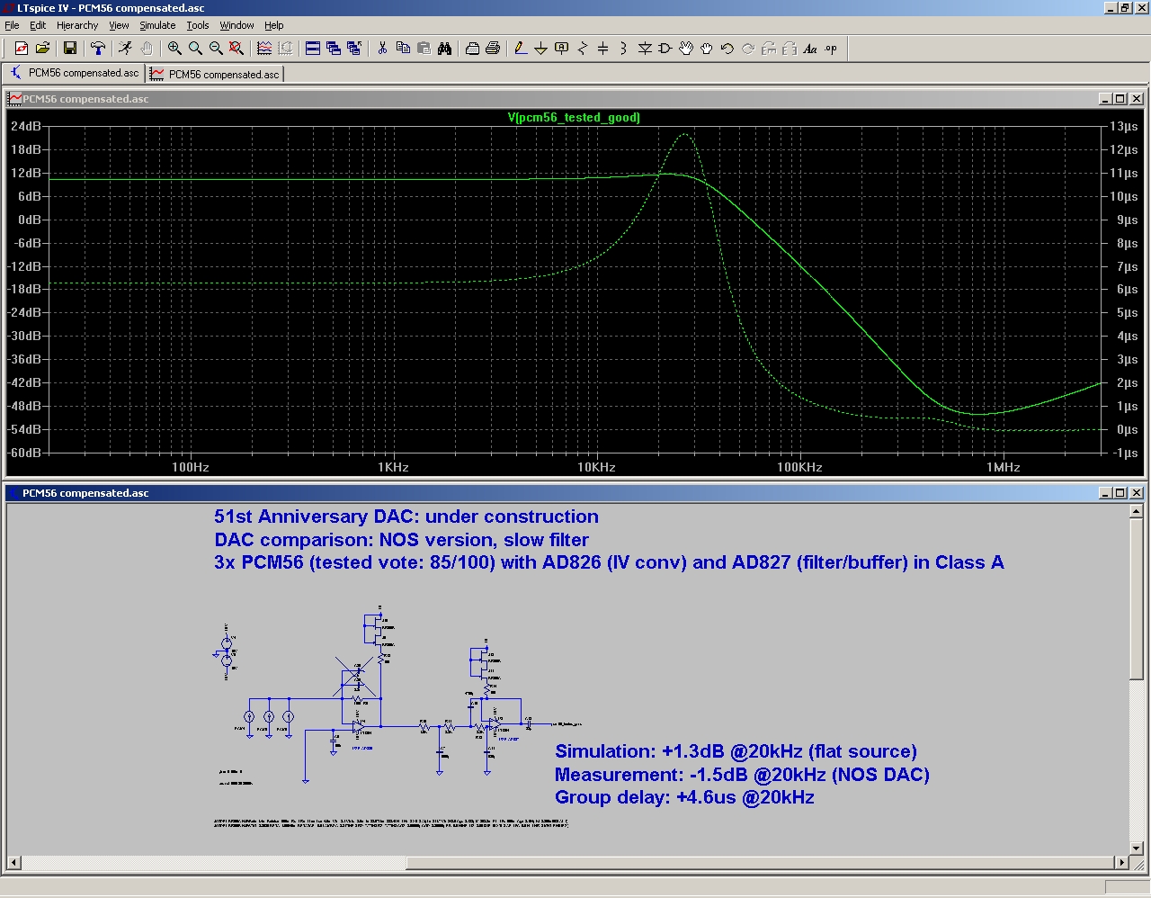

After many listening tests I believe now to prefer a slow filter too with NOS PCM56. Thus, as Mr. Shu-Nkmr Sakura experimented Audio DA Converter SN-DAC0503, I will give up of one order filter, gaining +1.5 dB at 20kHz but maintaining a small group delay (<5us). But I had to play also with op-amp rolling to get sweet highs and large but very focused soundstage (hence AD826 and AD827).
I think that I'm more sensitive to phase distortion for long group delay, than to flat frequency response: I happy with a slow HF roll-off as this is actually giving me the lower listening fatigue and the best soundstage.

I think you have found out what many of us listening to NOS dacs already know - slow roll off is preferred or you might as well stick with OS.
This is not surprising because the CD player manufacturers spend millions trying to produce the perfect filter for use with DACs before oversampling was introduced and made life much easier & simpler for them.
There is also of course, additional filtering in the amplifier and the speakers which contribute to the SQ.

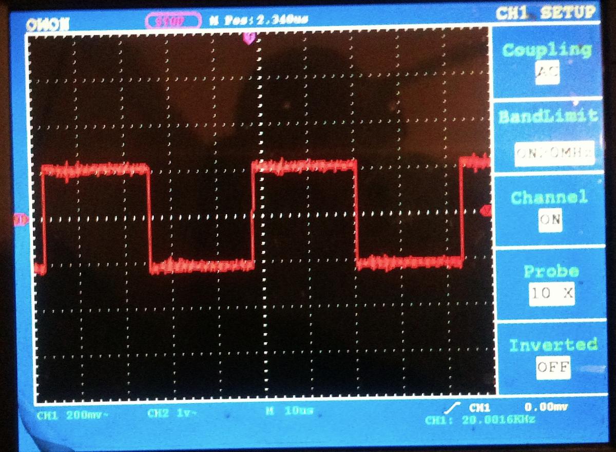

And BTW it is hard to believe but TDA1540 14bit shoving almost perfect square converted at output from 20KHz computer generated digital signal (ElectroAcousticToolBox software free edition)...

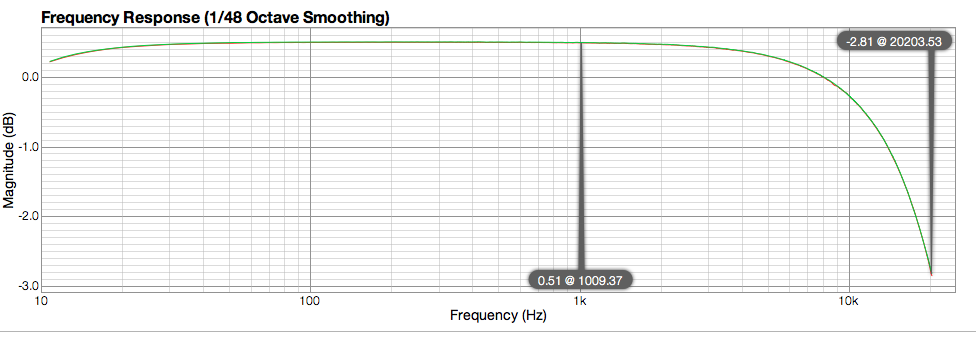

Something like that?
- Digital Line Level
- Frequency response of NOS DAC
