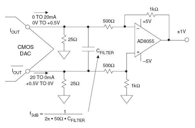

I don't see any common-mode filter and the differential filter has a very slow roll-off, so it would not be very effective.
abraxalito has some examples of filters that are far more effective and correct for the sin(x)/x roll-off.
Thanks for reply! Do we know what part of the DAC's noise -reconstruction images, aliasing etc- is common mode and what is differential?

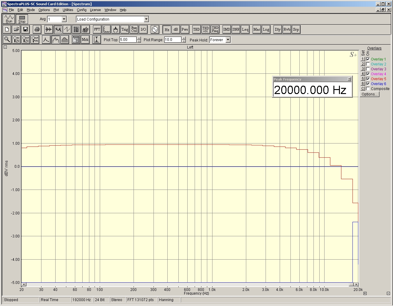

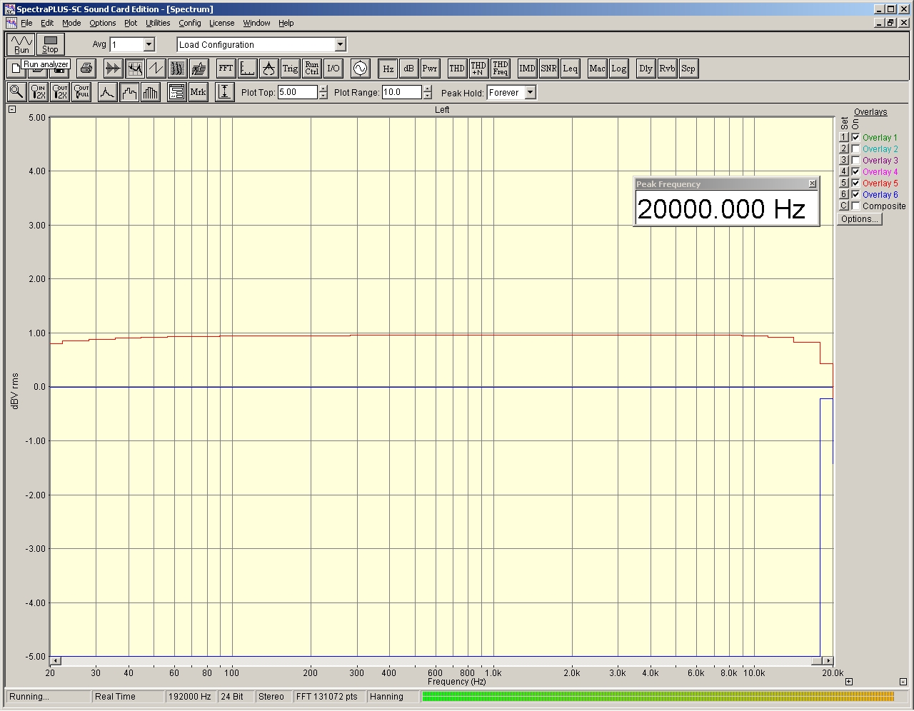

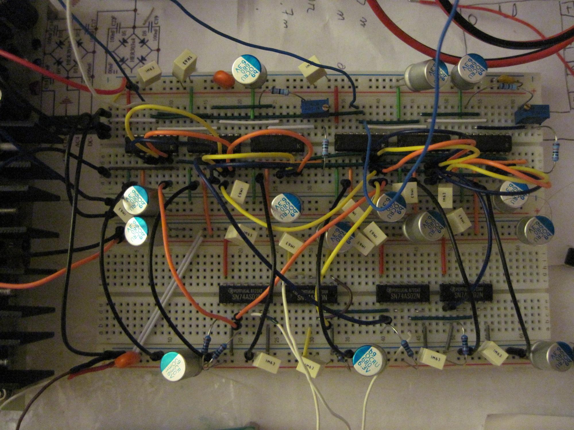

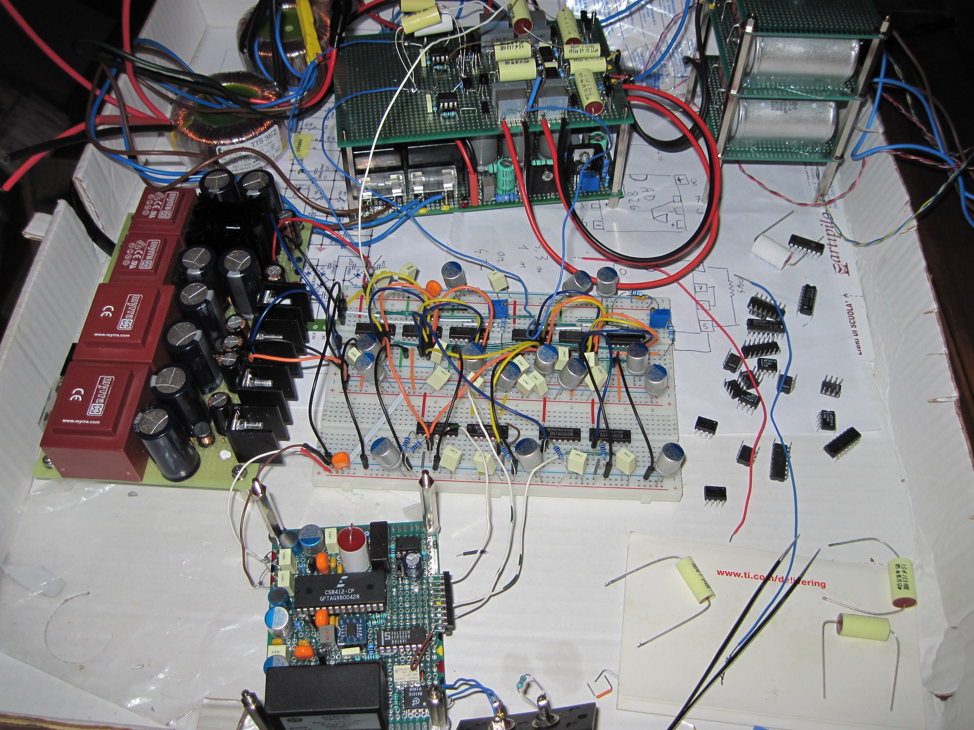

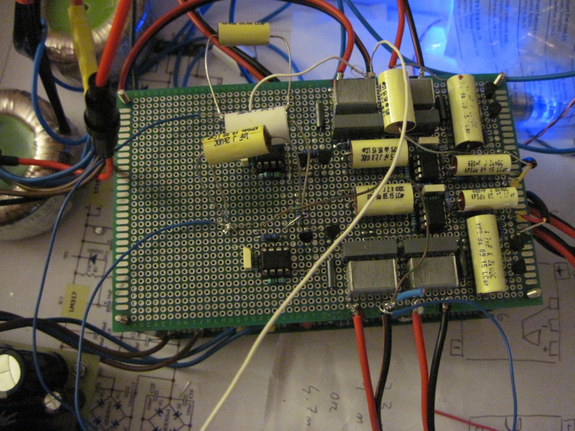

Hello, I have built the compensated filter this night....
Response is now pretty flat (-0.5dB only!) but group delay slight worse (9us). I like both versions...need to decide which I prefer.
Today I will test both by ear (LTSpice flat and DAC flat), not 100% sure that I prefer the compensated DAC_flat one as 3D sounding imaging of the not compensated one was extremely focused...
Will post full results and comments probably in another thread where I'm comparing TDA1543/CS4303/PCM1710...but PCM56 measurements and sounding performance are really amazing in any case...

PCM56 3x frequency response breadboard 1nF+6.5nF LTspice compensated.jpg312.3 KB · Views: 233
PCM56 3x frequency response breadboard 4.3nF LTspice flat.jpg303.2 KB · Views: 221

I was attracted by the sound so much that initially I made thoughts to live with the non flat FR. But no, I can't force myself to this ...
I would like to remind you that here we are allowed to build machines for our own exclusive pleasure and not to market them.
The machines on the market "must" have a flat response, and the graphics have to prove it in order to be sold. The Onkyio 6130 has an extremely flat analog response (it's my digital source and I've just measured it for comparison) with its AKM's premium AK4452 768 kHz / 32-bit DAC. And it sounds extremely clean, but it does not excite me at all!
The NOS TDA1543 / PCM56 44.1 kHz / 16-bit which I have just built on such messy breadbords have already outclassed it: as said I will go to listen to both versions for few days (compensated and flat, but with greater group delay, or not compensated with -3dB roll-off, but with negligible group delay). And, if at some point, I eventually enjoy more the un-compensated one for longterm listening, I will keep it, because it would give me the greatest satisfaction, even if its frequency response is disgusting on the paper and I have a "flat response" source DAC available at few centimeters close to it...
