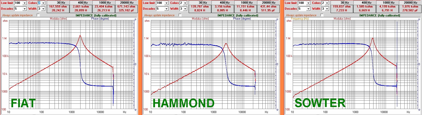

Hi
I think if you use LIMP from Arta you can have a good results.
https://artalabs.hr/support.htm from page 28
Also with Rew
You need a good sound card.
As I shown some time with a specific sw (not available at the moment, sorry but I am pushing my friend to relase it) you can see all
