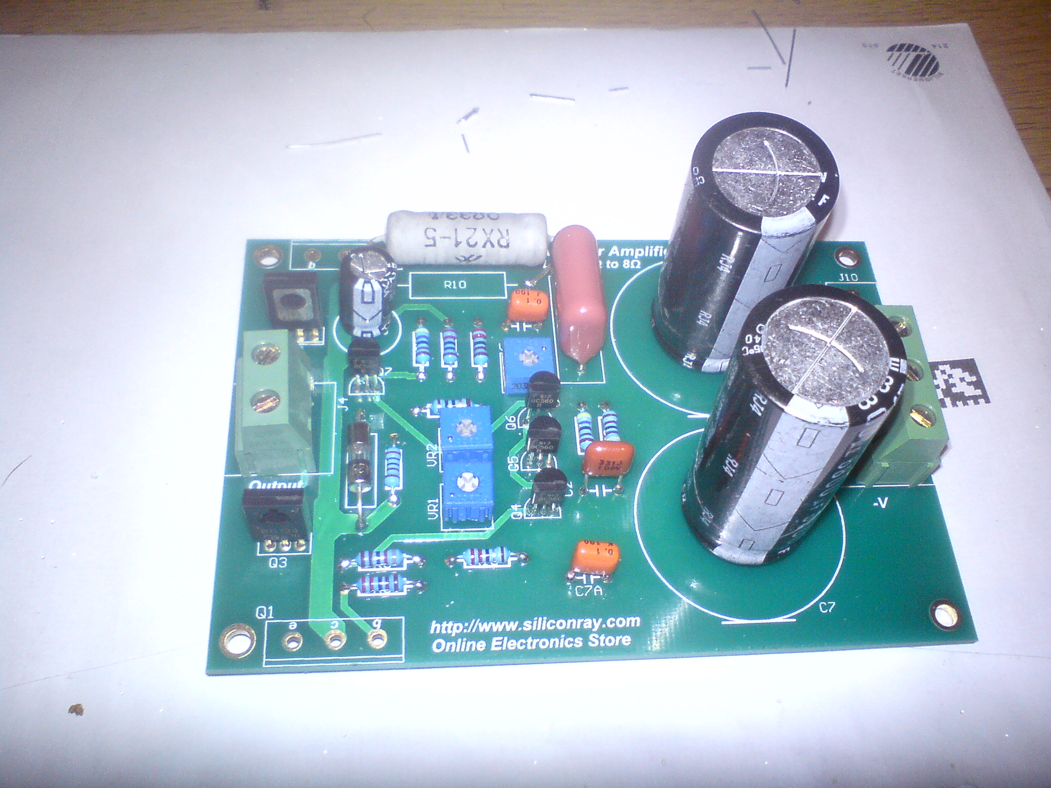

Post a picture ?
Hi Siliconray,
can you post a picture of your board and the heatsink size ?
I am about to begin populating the boards.
thanks
kp93300

Siliconray, i am happy to tell you that i've completed 3 sets of this amplifier now and a friend is working on his now. Today we got wood for the cases for the rest of them, but here is one i've put into a 3U Modushop case:
The other two i'm planning on inserting into some homemade wood cases and using heatsinks from some inferior amplifiers that now is sleeping with the fishes. (Nad's. We fix them at work all the time). Here is a pic of one that's done but with the 69 version of JLH:
And here is one i'm building right now with the newly aquired wooden pieces:

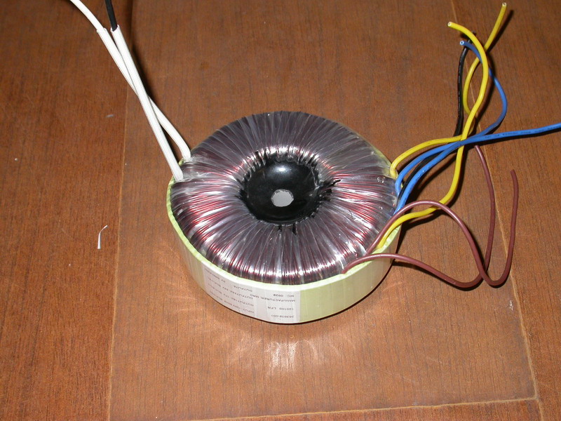

I have 4 big toroid transformer which were disassemblyed fron an US made auido equipment, like new. They are 110V and usless for me. I would like to send it to those who want to buy JLH amplifier full kit + Power supply for free
This transformer is ideeeeeeal for Stereo JLH power amplifier (for US and canada DIYers). Spec:
Power: >150W
output1: 24-17-0-17-24
output2: 8V
weight: 2kg
Only 4 available, only one for one person.
Plus $25 for air shipping. PM me if you have interest.
