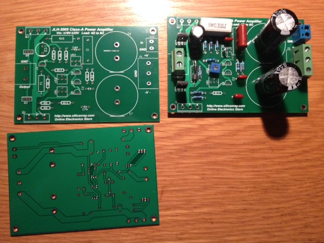

Siliconray,
I purchased the complete version of the JLH 2005 amp offered around March 2012 through your website. I have green boards, but no other markings as to version. I haven't read this entire thread yet, but was wondering what, if any significant PCB changes were made on the PCBs included in the kit I bought and the more recent, or current offering. Can the kit I bought be built as is, or should I read the thread and note any changes discussed that my board may not have?
Thanks,
Rick

I just received these PCBs
I just received my PCBs.
Picture attached. I am not clear what type I have regarding PCBs.

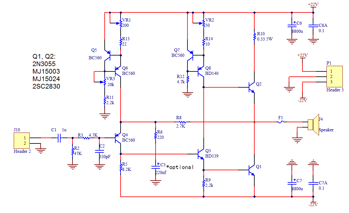

First I was a bit pussled over some component values.
After some thoughts it is now clear.
There are some options around on internet for this JLH design.
First I deceided to keep the C3 (220uF) in the feedback loop.
If you keep it then:
a) I replaced VR3 with a fixed metalfilm resistor , 7,5 kohm. making it 9,7 kohm togethter with the 2,2 kohm. (You can also keep VR3).
b) VR1 now must have a different value. A 2 kohm trimpot.
I myself already had a Bourns 10 turn 2 kohm trimpot, so I use that.
VR1 is used for setting the DC voltage at the output terminals to, as close as possible tol 0 V. In practice some mV. This must be done without speakers connected.
VR2 is used for setting the current. I will experiment a bit here, but about 1,5 A.
